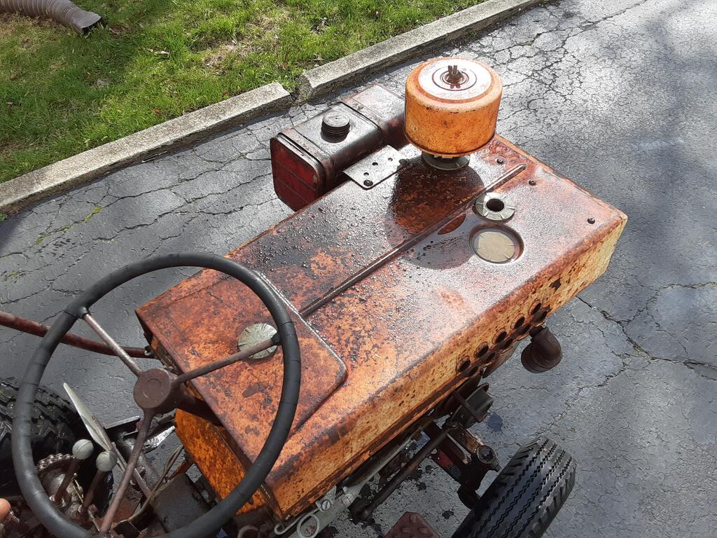

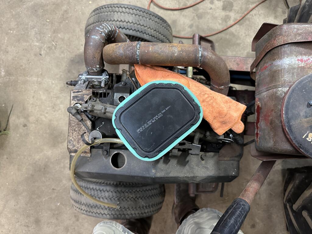

Pullstart 71,561 #151 Posted April 23, 2025 I made a list of things to accomplish on the belt guard. One major issue is the air filter. There is about 7/8” between the carb top and the hood. I have an idea. 1 1 Share this post Link to post Share on other sites
AlexR 3,139 #152 Posted April 23, 2025 1 hour ago, Pullstart said: I made a list of things to accomplish on the belt guard. One major issue is the air filter. There is about 7/8” between the carb top and the hood. I have an idea. My thought on a airbox would be make a fairly large square box that is only 3/4-7/8" thick. With a hole in the center for the air intake. And then attach a external air filter to that how ever that would have to work with space. But it will be interesting to see what you come up with. 1 Share this post Link to post Share on other sites
Pullstart 71,561 #153 Posted April 23, 2025 3 hours ago, AlexR said: My thought on a airbox would be make a fairly large square box that is only 3/4-7/8" thick. With a hole in the center for the air intake. And then attach a external air filter to that how ever that would have to work with space. But it will be interesting to see what you come up with. Surprisingly, a PTO clutch plate perfectly bolts to the top of the carb. I found an air filter that will fit down over the carb. So, a little cutting and welding magicery should allow it all to work in conjunction with each other. 2 Share this post Link to post Share on other sites

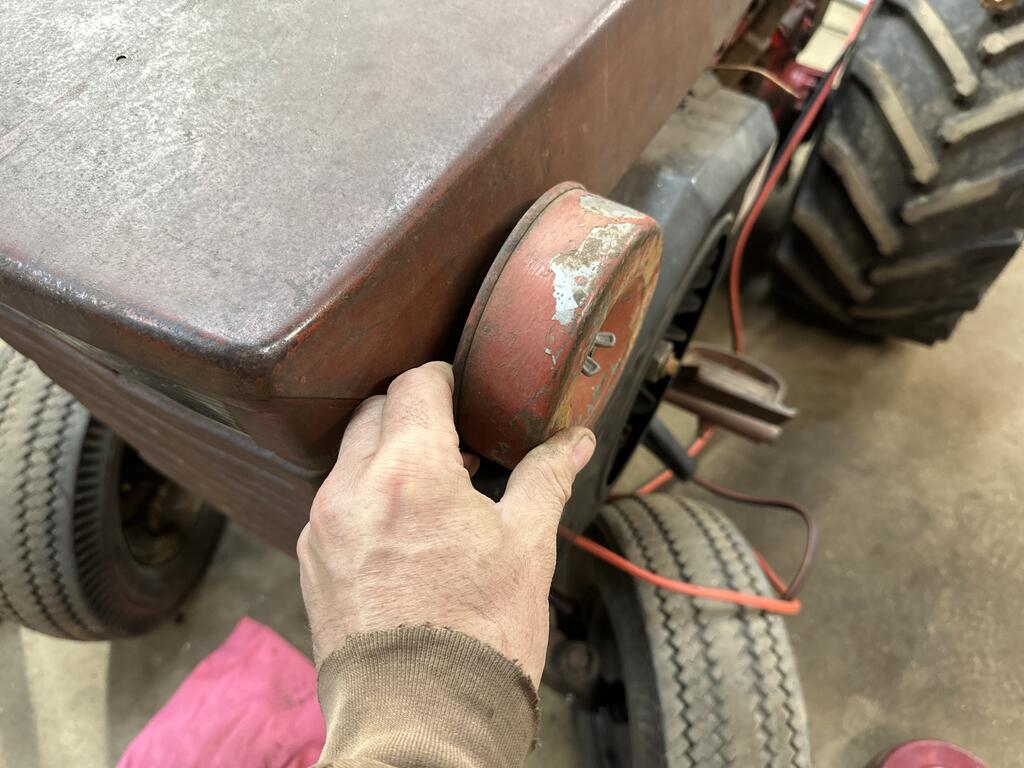

953 nut 70,654 #158 Posted April 25, 2025 Here is what I would do for the air filter, The top could be an old hubcap ore something else that would be interesting. 3 Share this post Link to post Share on other sites

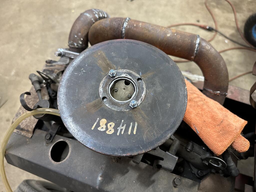

Pullstart 71,561 #159 Posted April 25, 2025 23 minutes ago, 953 nut said: Here is what I would do for the air filter, The top could be an old hubcap ore something else that would be interesting. Yes Mr. Richard, that’s pretty much my plan. check out how perfect this PTO clutch plate fits that carb! 1 1 Share this post Link to post Share on other sites
Pullstart 71,561 #160 Posted April 25, 2025 As for a lid, I really think the hood might become the lid! This filter is rated for 27 hp. 3 Share this post Link to post Share on other sites

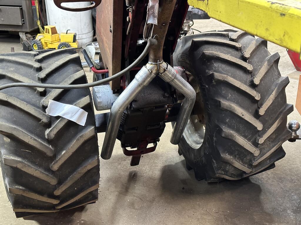

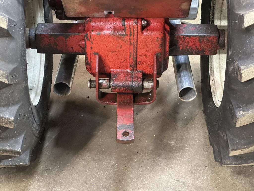

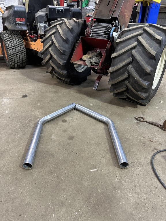

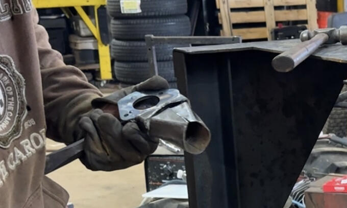

Pullstart 71,561 #165 Posted April 29, 2025 I am no betting man, unless it’s loading a trailer or something easy, but I think this will sound great! It’s just tacked up. I want to get some rear hangers, square it up and level it, then final weld it. 1 3 1 Share this post Link to post Share on other sites
kpinnc 19,107 #166 Posted April 29, 2025 That will help warm the hydro in cold weather! 3 Share this post Link to post Share on other sites
ebinmaine 81,281 #167 Posted April 29, 2025 29 minutes ago, Pullstart said: this will sound great! Refresh my memory. Is there any muffling in this system? Share this post Link to post Share on other sites
Pullstart 71,561 #168 Posted April 29, 2025 2 minutes ago, ebinmaine said: Refresh my memory. Is there any muffling in this system? There is a set of two convoluted and twisted 1/2” washers inside the pipe. They are from my original “Steve” C-81 long tube exhaust system. 4 minutes ago, kpinnc said: That will help warm the hydro in cold weather! I am hoping the distance to the hydro components will allow some heat dissipation. If not, some cool heat shields on stand offs might be in order. 1 Share this post Link to post Share on other sites
kpinnc 19,107 #169 Posted April 29, 2025 7 minutes ago, Pullstart said: I am hoping the distance to the hydro components will allow some heat dissipation. If not, some cool heat shields on stand offs might be in order. Oh I was joking. I'm sure it won't hurt anything. ...Maybe if you lived in Australia or somewhere crazy hot. 1 Share this post Link to post Share on other sites
ebinmaine 81,281 #170 Posted April 29, 2025 2 hours ago, Pullstart said: There is a set of two convoluted and twisted 1/2” washers inside the pipe. They are from my original “Steve” C-81 long tube exhaust system. I remember that. Sounded good on video. 1 Share this post Link to post Share on other sites
Pullhosen’s Pony Express 98 #171 Posted April 29, 2025 49 minutes ago, ebinmaine said: I remember that. Sounded good on video. I remember it sounded pretty good in person. Ive been concerned that the pipe wasn’t large enough. Then I finished the dual exhaust today with a stick of pipe I recall running under a 2.3l 4 cylinder powered Ford Ranger. Ok, it should be alright for 16 Horse Powers… 2 Share this post Link to post Share on other sites

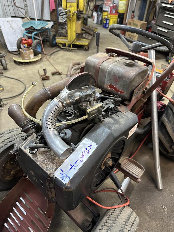

Pullstart 71,561 #174 Posted May 2, 2025 Today I finally nailed down an intake/air filter. I started with an idea, and held the filter in place for concept. It’s very GT14 like, eh? 2 Share this post Link to post Share on other sites

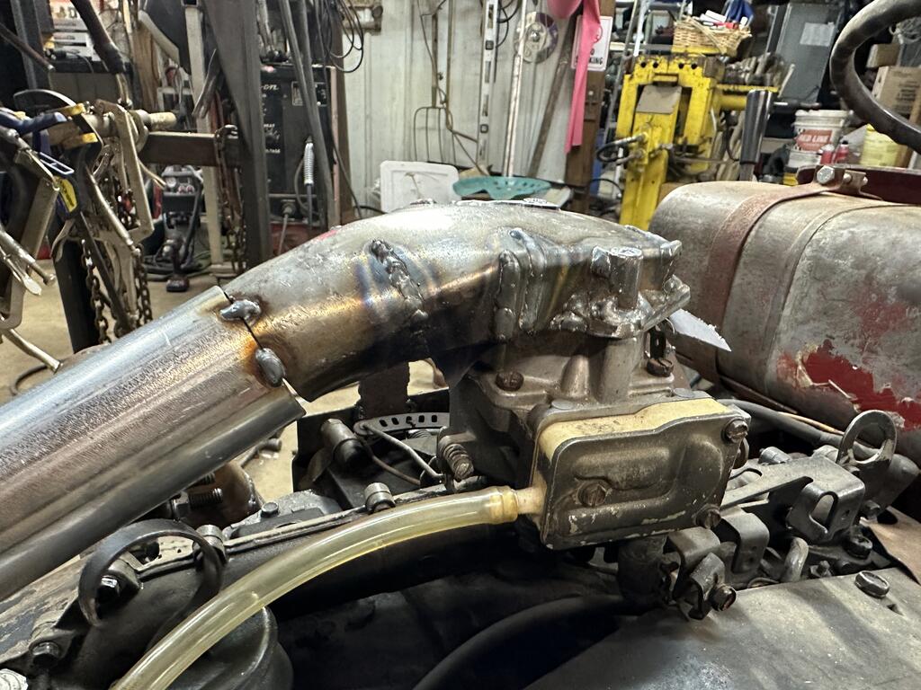

Pullstart 71,561 #175 Posted May 2, 2025 Lots of chopping, and welding, and fitting, and a few bumps and bruises finally, and I got an intake built. 2 1 Share this post Link to post Share on other sites
