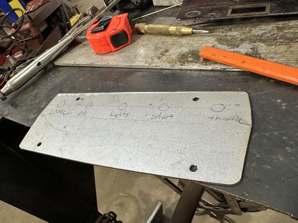

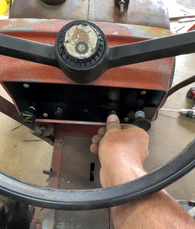

Pullstart 69,961 #226 Posted May 29, 2025 We went from a piece of steel to a new dash panel. Wiring is complete, it’s almost show ready! 4 2 Share this post Link to post Share on other sites
squonk 46,567 #228 Posted June 3, 2025 On 5/29/2025 at 12:07 PM, Pullstart said: We went from a piece of steel to a new dash panel. Wiring is complete, it’s almost show ready! Any Fuses in play? 1 3 Share this post Link to post Share on other sites
Pullstart 69,961 #229 Posted June 3, 2025 8 minutes ago, squonk said: Any Fuses in play? Yes indeed! One on the power wire from the positive lug to the electrical panel, and another on the charge side of the circuit! 1 Share this post Link to post Share on other sites

953 nut 66,100 #232 Posted June 3, 2025 1 hour ago, Pullstart said: Yes indeed! One on the power wire from the positive lug to the electrical panel, and another on the charge side of the circuit! And don't repeat the mistake I made of putting a 15 amp fuse on the 15 amp charging circuit. That didn't hold up too long. 1 1 Share this post Link to post Share on other sites

peter lena 9,885 #234 Posted June 3, 2025 @p38js like your thinkin , on those pulleys , typically fail due to small bearing and incorrect lubrication , the related linkage arm , blow out is telling / showing you binding , excessive vibration , due to bearing hang up , have made up , combinations of pulleys , similar size / type , with larger bearings , hi temp / polyurea grease , T/S pulley isle often has a good selection , very easy to paint red / black . like your , wiring , split protection wraps , use them often . lso like contractor bolt on cable ground connections , makes for safe / solid wiring gains . bearing / pulley buzzing is telling you of bearing incremental , binding , areas , that have been corrected operate , silently / smoothly , also regularly , add a spring to linkage connection areas , my personal , paint preference , is era correct patina , often refer tp a penetrating oil soak down , to hold and feed , neglected paint , let sit days / weeks , wipe down with mineral oil , for age holding vintage look , have also buffed out , recovered paint , to clean shine , experiment , pete Share this post Link to post Share on other sites
