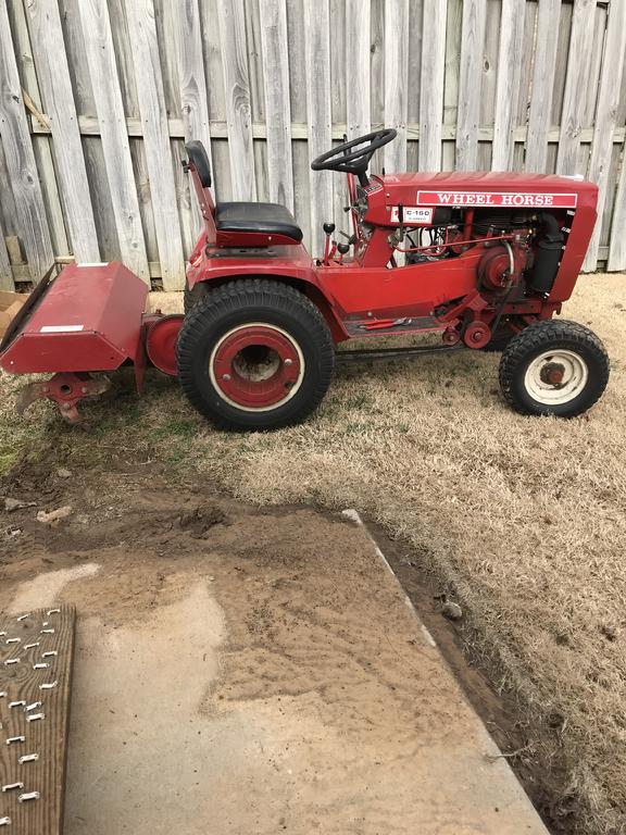

Razorback 1,370 #1 Posted December 28, 2018 I have not had my C160 very long. When I brought it home it had the 36” RD deck on it but I am going to use this machine for ploughing and tilling. I removed the deck (that was simple!!) then figured out how to attach the tiller. The previous owner didn’t have a belt for it.... looked in my shed..... had B140, B142, B156...... no B139!!!!! That figures..... I installed the B140 just to see it turn, which it did, but it’s too long..... off to find one!!! 4 3 Share this post Link to post Share on other sites

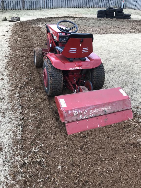

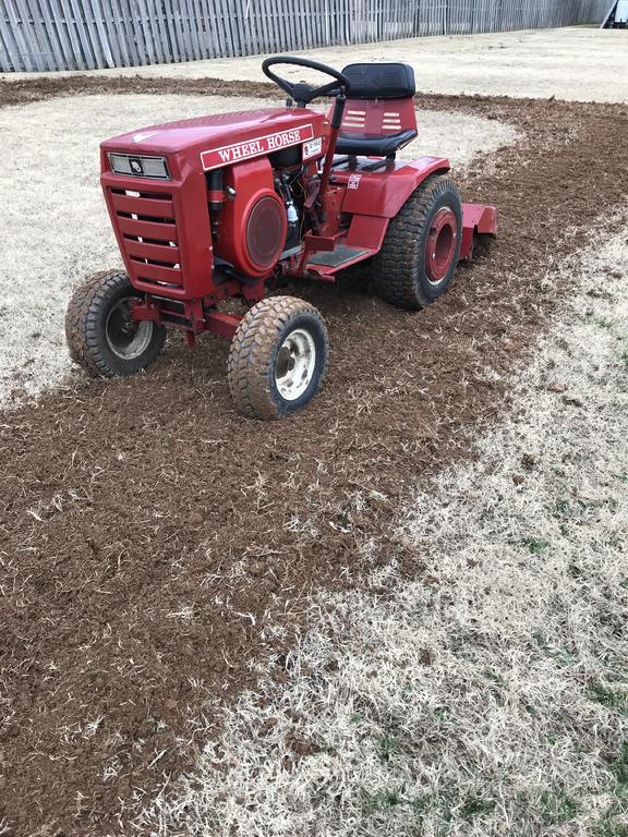

Razorback 1,370 #7 Posted January 6, 2019 Received the belts Friday. Had some time this afternoon to install one and till part of the garden. I really like this tractor AND the tiller! Works real good. 3 2 Share this post Link to post Share on other sites

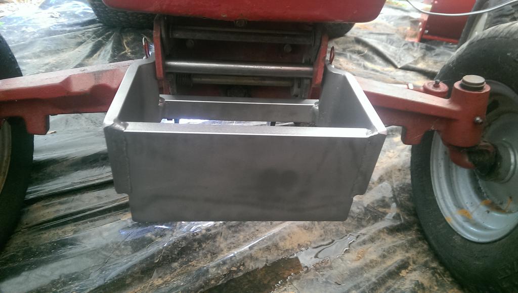

Razorback 1,370 #9 Posted January 7, 2019 Also need to add some weights to the front.... I have plenty of that on hand, just need to fabricate some way of attaching it...... should be easy to accomplish. Share this post Link to post Share on other sites

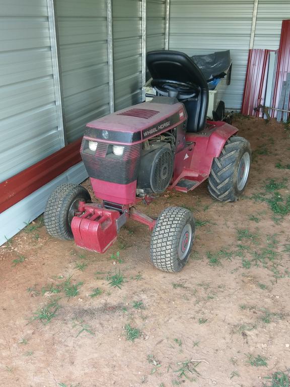

WVHillbilly520H 10,379 #10 Posted January 7, 2019 1 hour ago, Razorback said: Also need to add some weights to the front.... I have plenty of that on hand, just need to fabricate some way of attaching it...... should be easy to accomplish. This is my way of adding front weight... 1 Share this post Link to post Share on other sites
Razorback 1,370 #11 Posted January 7, 2019 Thank you for that. The weights I have are ballast weights that were in some computer equipment racks to keep them from being top-heavy during shipment. They are approximately 6”x18”x1.5”...... with two hand holes in them..... plenty heavy individually, obviously way heavy combined. I am envisioning some metal brackets secured to the frame, and made to quickly add or remove.... I’ll tinker with it and come up with a good solution. 1 Share this post Link to post Share on other sites
Razorback 1,370 #12 Posted January 13, 2019 Posting a picture that shows the assist spring and lift cable..... zoom in and you can see how it goes together. Share this post Link to post Share on other sites
