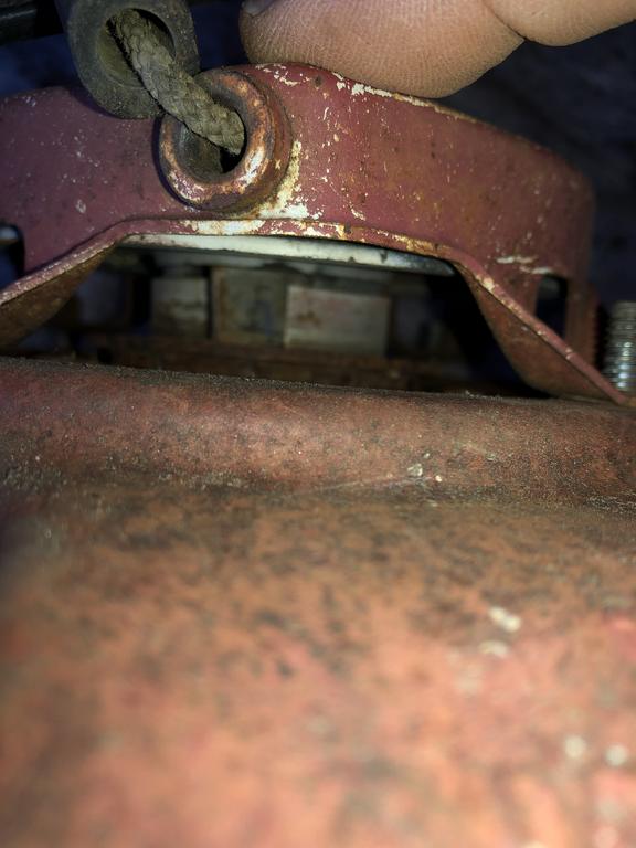

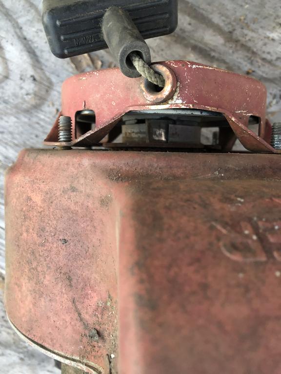

BHunter 1,702 #1 Posted December 27, 2018 Hi guys. I just picked up a suburban with a 4 hp on it. The pull rope works good but the pawl doesn’t engage the engine. It doesn’t seem to go in far enough to reach the nubs. Any ideas on what the problem is? Thanks, Bob 1 Share this post Link to post Share on other sites
AMC RULES 37,260 #2 Posted December 27, 2018 Did you try some spray lube on that sticky pawl...is it fully extended there in your photo? Share this post Link to post Share on other sites

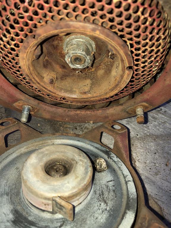

ol550 879 #3 Posted December 27, 2018 Is that the correct cup for your recoil? Looks like the pawl should be deeper in the cup. Share this post Link to post Share on other sites
wallfish 20,733 #4 Posted December 27, 2018 20 minutes ago, ol550 said: Is that the correct cup for your recoil? Looks like the pawl should be deeper in the cup. need a deeper cup. It's probably a correct cup for the recoil but not for your engine application. Share this post Link to post Share on other sites
BHunter 1,702 #5 Posted December 27, 2018 I agree. They don’t match up. Seems like the recoil sticks out too far. The patina on the shroud and the recoil might be a little different. Maybe the previous owner changed it ? Share this post Link to post Share on other sites
BHunter 1,702 #6 Posted December 27, 2018 56 minutes ago, AMC RULES said: Did you try some spray lube on that sticky pawl...is it fully extended there in your photo? I didn’t try that yet. No. It extends more when I pull the rope. thanks for the suggestion. Share this post Link to post Share on other sites
wallfish 20,733 #7 Posted December 27, 2018 Think that's a Tecumseh recoil. They do fit and you can find a deeper cup. Look around on ebay for one 1 Share this post Link to post Share on other sites

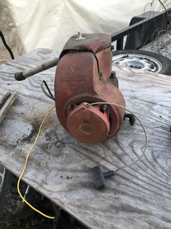

AMC RULES 37,260 #8 Posted December 27, 2018 Looks like maybe 8hp Kohler, or a magnum recoil to me. Share this post Link to post Share on other sites
wallfish 20,733 #9 Posted December 27, 2018 I thought the Tecumseh recoils were the ones with the square holes near the standoffs. I may be mixing them up Share this post Link to post Share on other sites
AMC RULES 37,260 #10 Posted December 27, 2018 They do, but that one appears deeper to me for some reason. Share this post Link to post Share on other sites
BHunter 1,702 #11 Posted December 28, 2018 Thanks for the info guys. I might try a deeper cup if I can find one. Share this post Link to post Share on other sites

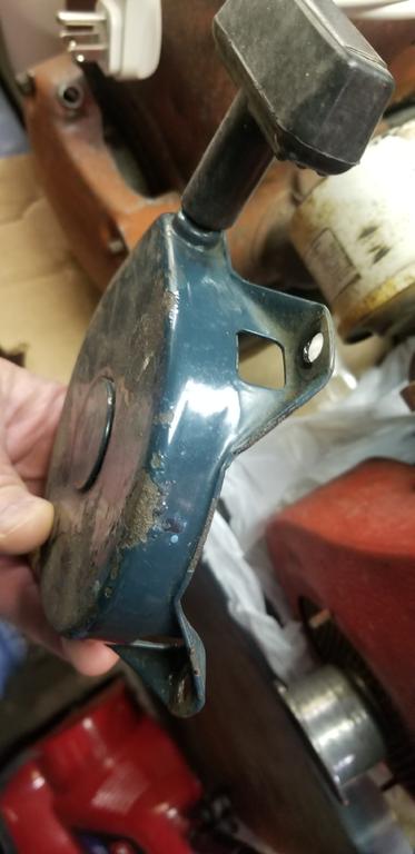

WHNJ701 4,173 #12 Posted December 28, 2018 I have them somewhere, I saved a few off some tech engines before they went to the crusher. Share this post Link to post Share on other sites
