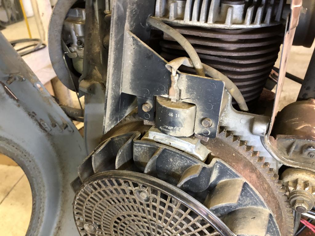

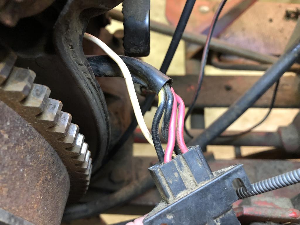

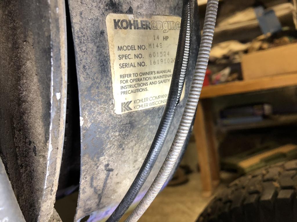

Turtle 3 #12 Posted January 3, 2019 So here are some pictures with some more questions for those at Wheel Horse University. First off there is a picture of the label on the Kohler engine showing it is an M Model. Can anyone tell from the Spec # or Serial # the year of the tractor? The photo of the wires show 5 wires coming from the engine into the connector plug. The 2 red ones clearly go to the oil level sensor. The separate white wire goes to the mag and I assume is the ground to shut down the engine. The 2 that go into the insulation tube must go to the alternator which I understand is behind the flywheel. One is white with some black spray paint on it and the other is all black. Can I assume the white wire is the alternator output because that is what is the color labeled on the wiring diagram. What is the black other wire? Thanks once more, Share this post Link to post Share on other sites

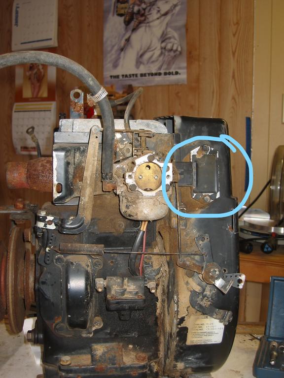

pfrederi 21,184 #13 Posted January 3, 2019 (edited) 1987 414-8 The two wires that go behind teh flywheel are the AC output form the stator and should get to the voltage regulator probably mounted in the blower housing up front. There it is converted to DC and goes through one wire to the ignition switch The Kohler manual clearly shows your spec number had a regulated system. Edited January 3, 2019 by pfrederi 2 Share this post Link to post Share on other sites

bc.gold 3,406 #17 Posted January 4, 2019 (edited) 26 minutes ago, pfrederi said: The stator of a Kohler will generate AC voltage when running regardless of the batteries state of charge or the functioning of the regulator. The question is does the regulator find it or know what to do with it. An oversight on my part forgetting the Kohler along with many other brands are equipped with a permanent magnet alternator. Should have remembered this as sometime ago had read an article where the magnets sometimes become unglued. Flywheel Magnet Repair Kohler Command https://www.lawnsite.com/threads/flywheel-magnet-repair-kohler-command.398206/ Edited January 4, 2019 by bcgold 1 Share this post Link to post Share on other sites
pfrederi 21,184 #18 Posted January 4, 2019 10 minutes ago, Turtle said: So I think you are saying that both of those wires go to the same terminal on the ignition switch that is connected to the battery (+) when the switch is in the RUN position. When the switch is in the off position and the mag gets grounded they are both disconnected from the battery to prevent the battery from draining. I knew that and should have have made the connection. I'm a pilot and you can start my plane by swinging the prop (we have 2 magnetos and 2 spark plugs in each cylinder) but the alternator won't put out any power unless there is still something in the battery to get it started. As usual thanks for the help. NO they should go to the regulator. are we sure something hasn't been changed on this motor??? Do your headlights work when the engine isn't running??? Maybe some one has changed to an unregulated system in the past. Do you have a regulator on your engine (circled in picture?? 1 Share this post Link to post Share on other sites

gwest_ca-(File Mod) 12,489 #20 Posted January 4, 2019 The 1987 414-8 model 31-14K802 using M14S-601524 should have the dual charging system with no voltage regulator. The 1619102xxx 10-digit serial number was made in 1986 which is correct for early production 1987 tractors. One stator lead has a diode in it near the connector that goes to the tractor wiring to rectify the AC current so DC current will charge the battery, The second stator lead goes directly to the headlamp circuit. The bulbs will work on AC current but only with the engine running and the faster it runs the brighter the lights. Click on the picture. More on this model https://www.wheelhorseforum.com/search/?&q=31-14K802&type=downloads_file&search_and_or=or Garry Share this post Link to post Share on other sites

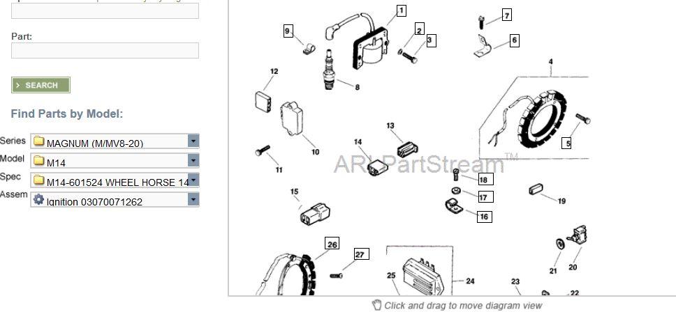

gwest_ca-(File Mod) 12,489 #23 Posted January 4, 2019 Is this one different? The illustration seems to show everything but the parts list only shows the parts used on this spec. https://www.partstree.com/parts/kohler-engines/engines-horizontal/m14-601524-kohler-m14-engine-magnum-wheel-horse-14hp-10-5kw-specs-601500-601557/ignition-03070071262/ Garry Share this post Link to post Share on other sites

pfrederi 21,184 #25 Posted January 4, 2019 1 hour ago, gwest_ca said: Is this one different? The illustration seems to show everything but the parts list only shows the parts used on this spec. https://www.partstree.com/parts/kohler-engines/engines-horizontal/m14-601524-kohler-m14-engine-magnum-wheel-horse-14hp-10-5kw-specs-601500-601557/ignition-03070071262/ Garry Garry You are correct...as usual. I misread the Kohler page.... Share this post Link to post Share on other sites
