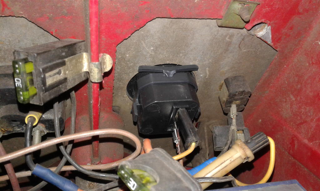

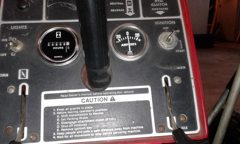

Skipper 1,792 #1 Posted December 26, 2018 Hi fellas My 195 fried the hour meter, and I'm meticulous with service on it every 15 hours (yes I know, the wiring doesn't reflect that ( it's waiting for a complete do over)), so i needed a new hour meter. I'm kind of a scrooge too, so a new OE one was just too much money in my little head, for a gizmo that basically just count hours. I found this aftermarket unit at a fraction of the cost, delivered to my door for the rediculous cost of 11$ Yes, it looks almost like the OE, and it works well. I ordered two, and have had one just running hours on to test, and it runs flawless after almost 1000 hours. Keeps fairly good track of time too Finish and eye quality is not up to par, but it is a good "almost as good as" choice for the price. Easy to mount with robber grommet and clip on retainer. Easy as one two tree. Thought other scrooges might find this info usable https://www.aliexpress.com/item/6V-80V-DC-AC-Timer-2-Round-Quartz-Hour-Meter-Gauge-for-Car-Marine-Boat-Tractor/32877754498.html?spm=a2g0s.9042311.0.0.27424c4dwSGY1N 5 2 1 Share this post Link to post Share on other sites
KC9KAS 4,746 #2 Posted December 26, 2018 Replace your AMP gauge with the same brand and it will look just as good! 2 Share this post Link to post Share on other sites
953 nut 66,588 #3 Posted December 26, 2018 7 minutes ago, KC9KAS said: Replace your AMP gauge with the same brand and it will look just as good! Replacing your AMP gauge with a VOLT meter would be the way to go. 1 1 Share this post Link to post Share on other sites
Sarge 3,471 #4 Posted December 27, 2018 So, it just sits in there only held by the 2 rubber grommet lugs? Sarge 1 Share this post Link to post Share on other sites

Racinbob 12,996 #6 Posted December 27, 2018 3 hours ago, Sarge said: So, it just sits in there only held by the 2 rubber grommet lugs? Sarge That's not rubber but plastic. That ring has them top and bottom, slips on and sort of ratchets on to the desired tightness. You can release it by squeezing the tabs on the side. I installed the same meter on my B-160 when I installed a fresh motor this past summer. It works great. 1 minute ago, clueless said: Richard, I'm thinking about replacing my AMP to a Volt meter on my c160 , do you just connect the original wires to the volt meter? When you remove the wires you'd have to tie them together to complete the circuit. Make sure to insulate it well. The voltmeter should be connected to a switched 12v source and the negative grounded. 1 Share this post Link to post Share on other sites

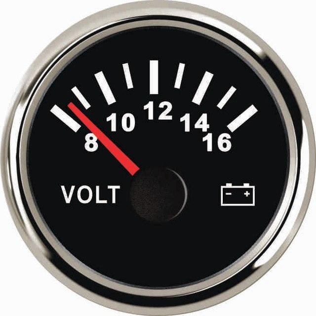

Skipper 1,792 #13 Posted December 28, 2018 (edited) For volt meters, I have not been able to find a better match than this one for this type meter. It is not perfect, but it will get the job done. And I could not agree more. Get that Amp meter thrown out and put in a voltmeter in stead. It's not a boat for Pete sake............. Edited December 28, 2018 by Skipper 3 Share this post Link to post Share on other sites
