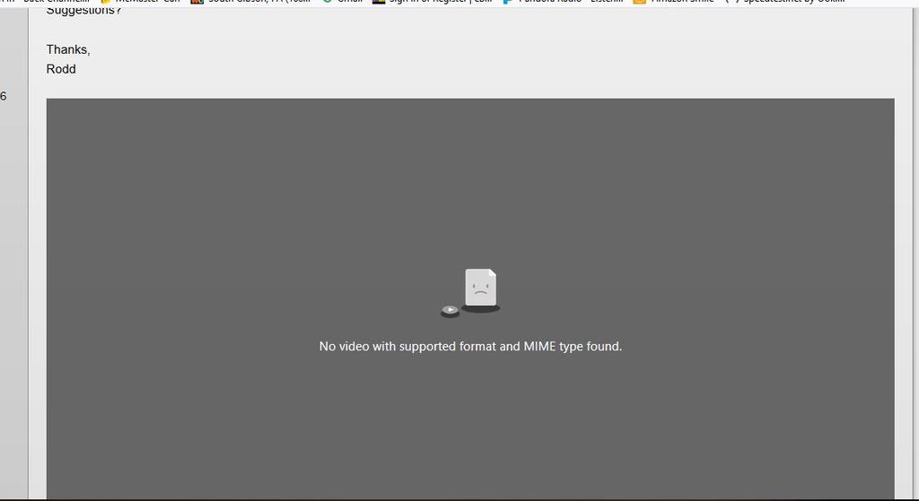

pfrederi 20,181 #7 Posted December 26, 2018 Can't see your video Share this post Link to post Share on other sites
Skipper 1,792 #8 Posted December 26, 2018 (edited) works fine here. Relay slams, current flows, and that's it. no starter action Oh and from the volt meter readings, it seems the battery is hooked up right, and providing enough juice. 1 suggestion would be to move the flywheel by hand just a bit Edited December 26, 2018 by Skipper 1 Share this post Link to post Share on other sites
rwmastel 47 #9 Posted December 26, 2018 (edited) 4 minutes ago, pfrederi said: Can't see your video Oh, it uploaded fine, but used my phone to make video and post. Sorry to hear that. Turning the key produces a metallic clank, like the post is extending from the starter and impacting against the flywheel, but nothing spins. Edited December 26, 2018 by rwmastel Share this post Link to post Share on other sites

gwest_ca-(File Mod) 12,110 #14 Posted December 27, 2018 If all else fails click on the picture Garry Share this post Link to post Share on other sites
