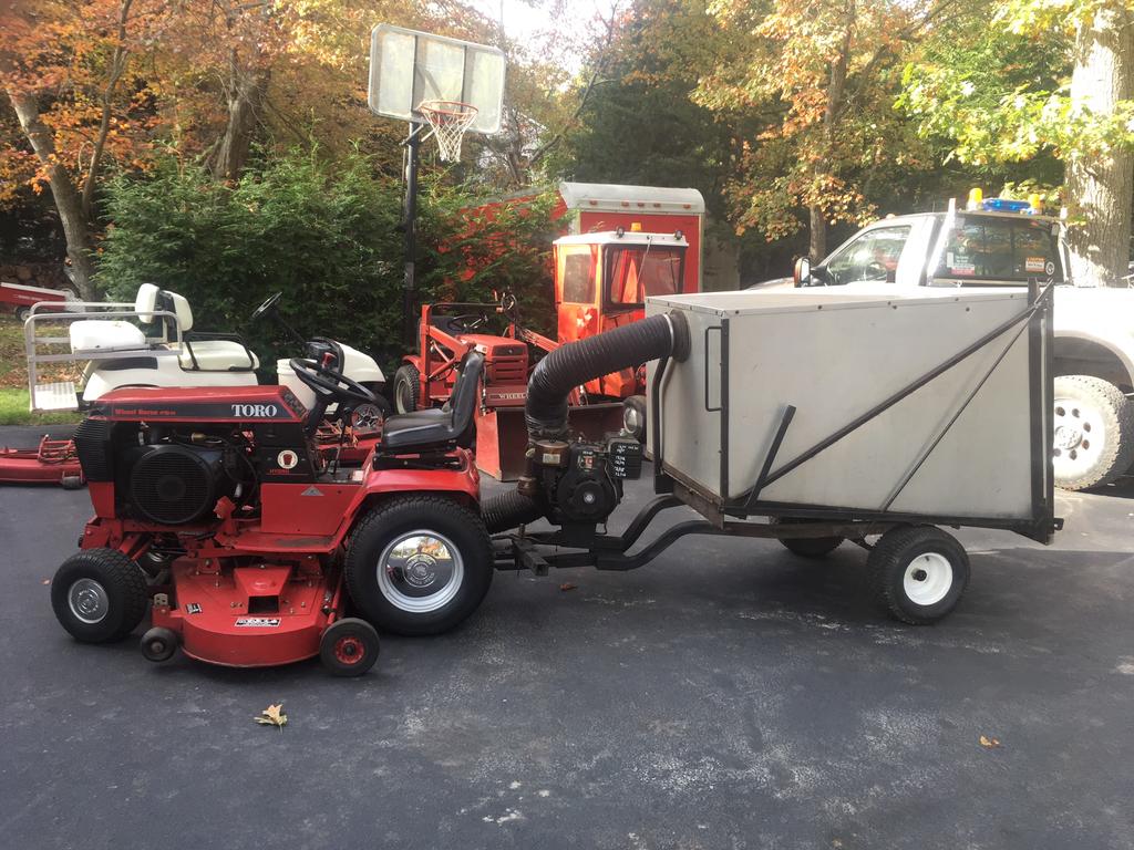

Lee1977 7,805 #4 Posted December 27, 2018 I built mine thirty so years ago and have been improving it every since. Got the blower housing design of a neighbors vacuum. I also used a larger vane in the blower. The main thing with the deck adapter is most of the manufactured one are too small. Bigger is better I've built 3 or 4 over the years I have used the vacuum. The last one was 16 gage galvanize metal and wood. I raise it up off the deck with three 3/4" boards shaped to match the deck. It is 8" high and then tappers down to a 6" pipe. I picked up wet and dry leaves yesterday that I raked out of a ditch. 4 2 Share this post Link to post Share on other sites

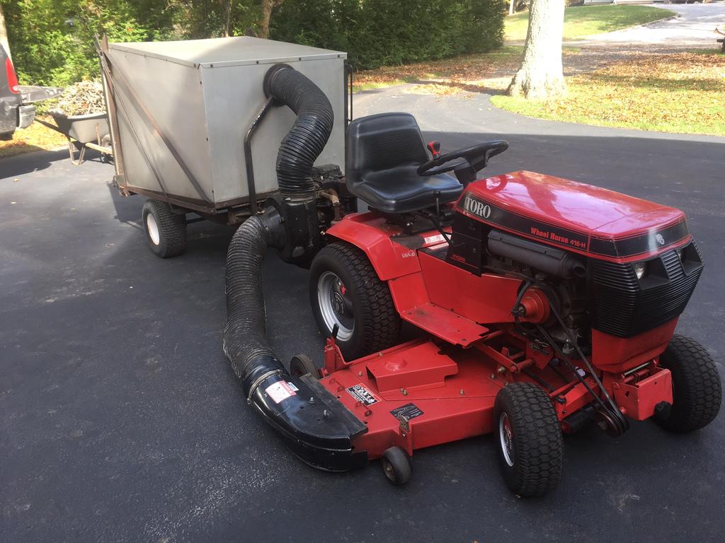

c-series don 12,525 #6 Posted December 28, 2018 Here’s mine with the factory Peco adaptor on a 60” deck. Works like a champ, back door opens automatically when it dumps! 1 Share this post Link to post Share on other sites
