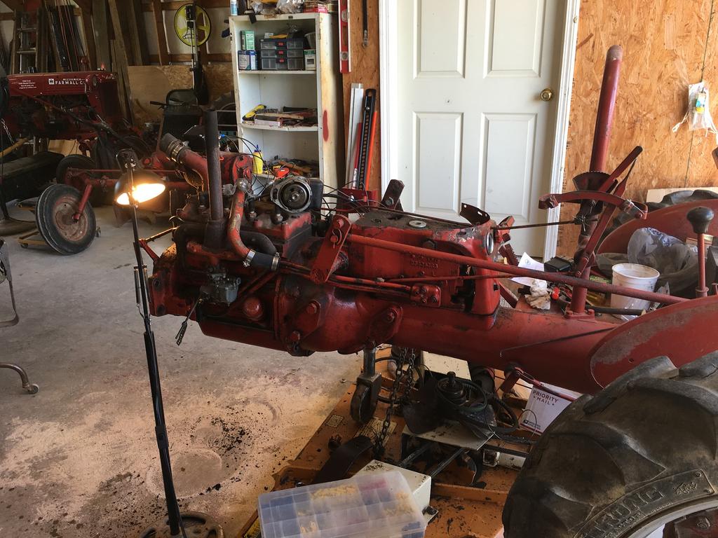

T-Mo-(Moderator) 4,905 #12 Posted December 26, 2018 Here are some pictures of my '50 with the front end off. Noticed the trailer jack bolted to the implement mounting area on the tractor. The jack is resting on the deck with blocks underneath the deck where the jack mount is. This was supporting the tractor since removed the front end to get to the crank seal. I wish I had a picture of the tool we used to remove the crank pulley - it also involved a jack. 1 Share this post Link to post Share on other sites
