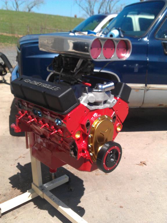

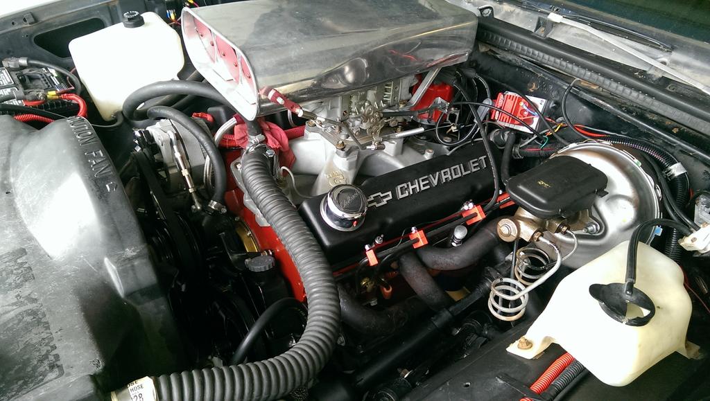

WVHillbilly520H 10,379 #11 Posted December 22, 2018 5 minutes ago, Achto said: ( HP=$ ), this is my favorite formula when talking about squeezing more horse power out of an engine. It will cost money for the up grades and then more money for the up keep. Yep $6k=600hp +or-...definitely not a daily driver. 5 Share this post Link to post Share on other sites
