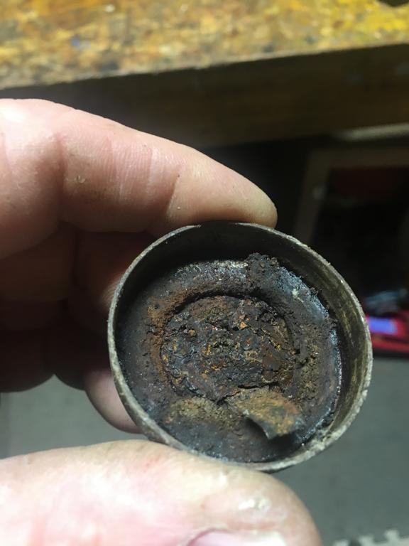

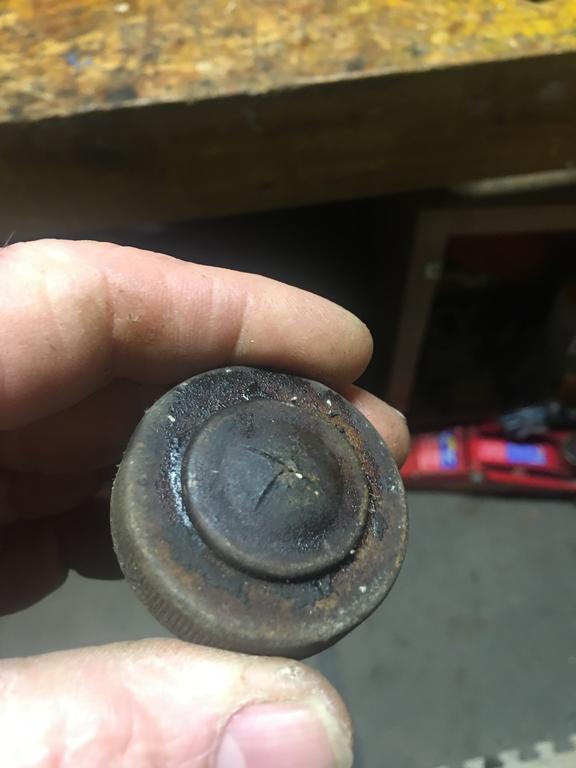

The Tuul Crib 7,354 #26 Posted December 24, 2018 Anyone have any idea where I can find one of these gas caps Share this post Link to post Share on other sites
AMC RULES 37,259 #27 Posted December 24, 2018 Might try looking through a "kohler gas cap" search on Ebay. Share this post Link to post Share on other sites
The Tuul Crib 7,354 #28 Posted December 24, 2018 32 minutes ago, AMC RULES said: Might try looking through a "kohler gas cap" search on Ebay. No luck there Share this post Link to post Share on other sites
AMC RULES 37,259 #29 Posted December 24, 2018 Maybe not today... save the search, I've seen them there before. 1 Share this post Link to post Share on other sites
WHNJ701 4,173 #30 Posted December 24, 2018 (edited) 9 minutes ago, AMC RULES said: Maybe not today... save the search, I've seen them there before. I just checked they are on there 19 bucks free shipping NEW OEM Kohler Fuel Cap Part Number: 236655-S THIS PART IS USED ON SOME OF THESE MODELS AND MORE: K161 K181 K241 K301 K321 K341 K91 Edited December 24, 2018 by jabelman 1 Share this post Link to post Share on other sites
The Tuul Crib 7,354 #31 Posted December 24, 2018 2 hours ago, jabelman said: I just checked they are on there 19 bucks free shipping NEW OEM Kohler Fuel Cap Part Number: 236655-S THIS PART IS USED ON SOME OF THESE MODELS AND MORE: K161 K181 K241 K301 K321 K341 K91 This is the screw in cap # Share this post Link to post Share on other sites
The Tuul Crib 7,354 #32 Posted December 24, 2018 I actually found it on eBay and it's part number 10756. It's a gravely part with the same diameter as the tag on the wheel horse tractor Share this post Link to post Share on other sites
953 nut 67,517 #33 Posted December 26, 2018 Check these out. https://www.fillernecksupply.com/industrial-and-machine-bayonet-quarter-turn-filler-necks-caps/ 1 Share this post Link to post Share on other sites
The Tuul Crib 7,354 #34 Posted December 26, 2018 13 hours ago, 953 nut said: Check these out. https://www.fillernecksupply.com/industrial-and-machine-bayonet-quarter-turn-filler-necks-caps/ That's exactly the That I need. Didn't know that you could get the filler neck to you as well but that is not needed and it's cheaper than fleabay!! Thanx!! 1 Share this post Link to post Share on other sites

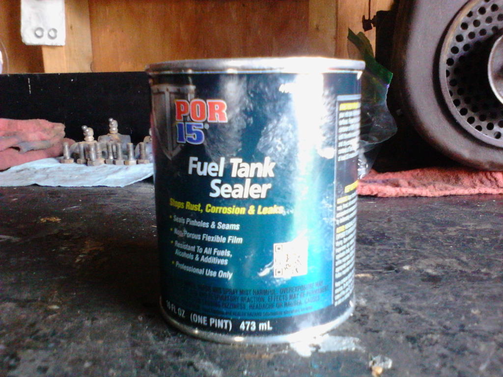

The Tuul Crib 7,354 #45 Posted January 1, 2019 OK so I got my gas tank cleaned out looks good on the inside. Ended up using vinegar and setting for around two weeks. As I am blowing air into the tank I've noticed two tiny pin holes pushing out bubbles . Is there a solution to line the inside of the tank which he fix this ? Share this post Link to post Share on other sites
Horseoholic 258 #46 Posted January 1, 2019 This product here made by POR 15 is a gas tank sealant that is for this purpose also is great for covering "Light" rusty areas inside fuel tanks. After coating tank it looks like brand new and fuel will not harm coating, I used this on a Continental engine and Clinton engine's fuel tanks with real good results. It can be purchased from Amazon, it can be pricey but worth it. Share this post Link to post Share on other sites
WHNJ701 4,173 #47 Posted January 1, 2019 20 minutes ago, The Tool Crib said: OK so I got my gas tank cleaned out looks good on the inside. Ended up using vinegar and setting for around two weeks. As I am blowing air into the tank I've noticed two tiny pin holes pushing out bubbles . Is there a solution to line the inside of the tank which he fix this ? red cote Share this post Link to post Share on other sites
