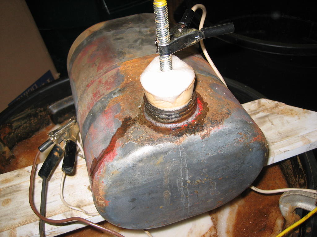

formariz 12,381 #4 Posted December 16, 2018 I have used this unusual method for years and its always been extremely effective. No chemicals no noise. Takes a little thinking and setting up but once you have the system set up , then every other time its cake. I have a thread about it here somewhere. Its just plain electrolysis. I first do the inside of tank then the outside. 6 Share this post Link to post Share on other sites

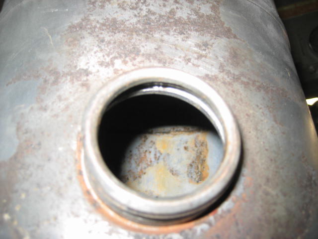

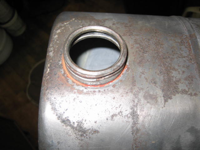

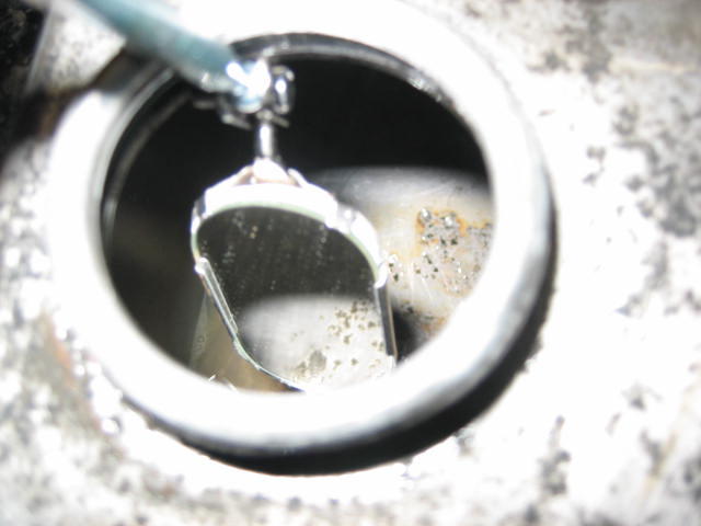

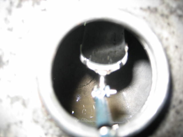

formariz 12,381 #14 Posted December 17, 2018 (edited) 15 hours ago, The Tool Crib said: What would be that method? 14 hours ago, OILUJ52 said: electrolysis, this web site shows how to set it up for external items. https://www.instructables.com/id/Electrolytic-Rust-Removal-aka-Magic/ Simple electrolysis! The difference here is that i place the anode right inside tank. It is simply a threaded rod or a bar that is bent to go inside tank as much as possible. The closer and the larger the anode is to the part being cleaned the faster and more efficient the cleaning. Hardest part of this method is not to allow bar to touch tank. One could just insert entire tank in the solution as another normal part, but I found that the interior that way was never cleaned properly. Many ways to achieve cleaning a tank but I was not a fan of the noise or the use of chemicals to do it. This is 100% effective and safe. As far as rust removal there is nothing more effective.You set it and forget about it . Does not matter how long it is going for , the longer the better. Immediately after I take it out and rinse it in hot water I place it on top of a kerosene heater to dry it. Just have to leave it there for short periods so one does not overheat metal. As I need it I fabricate all kinds of crazy contraptions and containers to clean odd shape and size parts. I collect Emmert vises and for the beam alone I have a container made up of a 5" PVC pipe . After a couple of days those beams look like they just came out of the foundry. Edited December 17, 2018 by formariz 1 Share this post Link to post Share on other sites

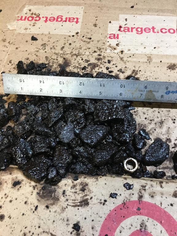

The Tuul Crib 7,354 #21 Posted December 20, 2018 This might look like chunks of coal but this is what I pulled out of my gas tank. Was a little chunky it was. This tractor has obviously been sitting for a while. Now I'm going to flush it out and add the vinegar ! Yeee. Haaa! 1 1 Share this post Link to post Share on other sites
Ed Kennell 47,753 #22 Posted December 20, 2018 How did you get the coal loose? Was the 1/2" hex nut in the tank? 1 Share this post Link to post Share on other sites
The Tuul Crib 7,354 #23 Posted December 20, 2018 Well that was one of many nuts that I put in the tank without realizing there was a thick layer of black yuck at the bottom. I just went in to the tank with a blunt pic and tried to break it all down and chip it out! 3 Share this post Link to post Share on other sites

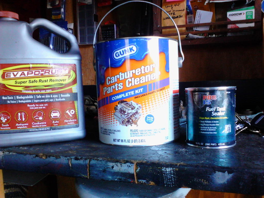

Horseoholic 270 #25 Posted December 21, 2018 I've used these products with good results, I put half a fuel tanks worth of carburetor parts cleaner in fuel tank if it's "gummed" up along with some nuts , fish tank gravel etc. Something that doesn't have sharp ends like screws, and shake and roll it around for a few days off and on till the gummed up mess loosens up, then drain tank and repeat if necessary. The jug of "Evapo-Rust" works really good on rusty tanks, just pour it in and let it sit and soak a few days and drain (this stuff is bio-degradable and can be used over and over again) . The final product is made by por-15...... It is a tank sealant, when used by the instructions, completely seals and coats tank and looks like brand new inside, any type of fuel will not harm this coating after it's applied and properly cured. Share this post Link to post Share on other sites
