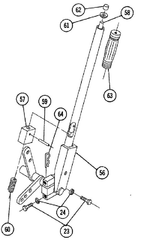

gwest_ca-(File Mod) 10,504 #2 Posted December 15, 2018 Welcome to the forum. Sounds like you are asking about the lift lever. There is an illustrated parts list here that may help. May be the wrong model year as the Commando name was used longer in Europe than in North America. Click on the picture and download from that page. More questions just ask. Garry Share this post Link to post Share on other sites

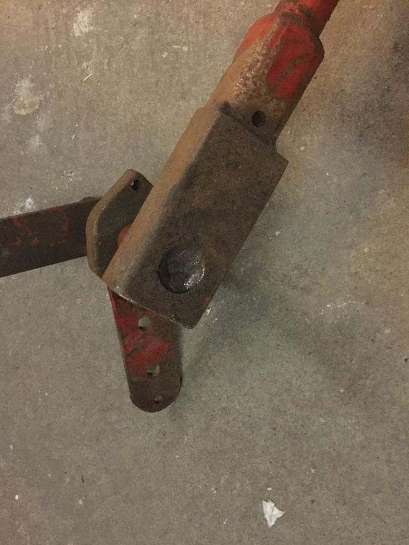

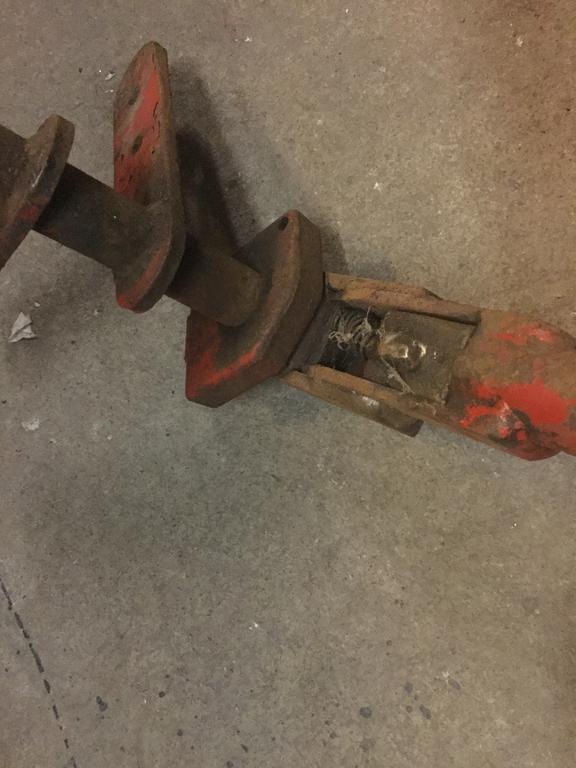

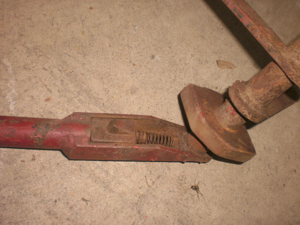

Mrmasab 0 #8 Posted December 15, 2018 Its welded in the bottom so the knob in the top isnt do anything . I would like to know how its attached in the bottom to see if i can rebuilt it This is my first wheelhorse its very unusal here in sweden Share this post Link to post Share on other sites
Lee1977 6,222 #9 Posted December 15, 2018 There is a roll pin holding the rod in the block or supposed to be. It might be that the rod or the block is rusted fast soak with rust penetration or use heat to break it loose. Share this post Link to post Share on other sites

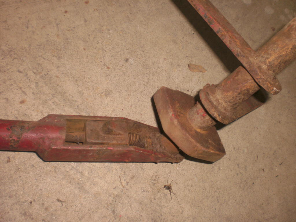

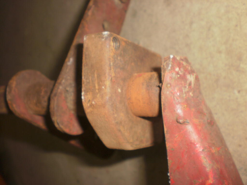

Ed Kennell 35,854 #10 Posted December 15, 2018 Here are a couple pictures. The lift lever is welded to the shaft. The top push button released with the spring pushing the block up and locking the lift lever in the raised position. The top push button depressed pushing the block down and releasing the lift lever so it can be lowered. Share this post Link to post Share on other sites
gwest_ca-(File Mod) 10,504 #11 Posted December 15, 2018 From the illustrated parts list Item #59 is a 933168 roll pin 5/32" x 13/16". (3.969mm x 20.638mm) Garry Adding If you remove the spring and the cap at the top of the rod the block may drop down far enough you can drive the pin out using the hole on the outside of the lever. 1 Share this post Link to post Share on other sites
