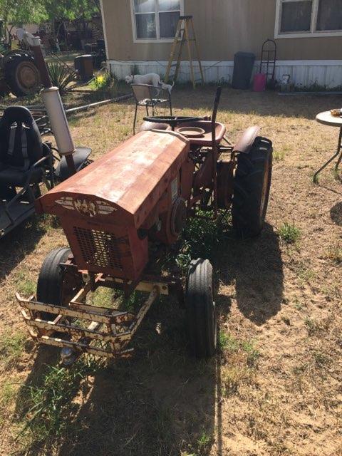

Keith 21 #1 Posted December 12, 2018 I have come across a Speedex 1631 with 16 hp Briggs and Stratton motor. What are the strengths and weaknesses of this model ? As the Power King, it has the T-92 transmission but seems to be belt drive. Tim Share this post Link to post Share on other sites

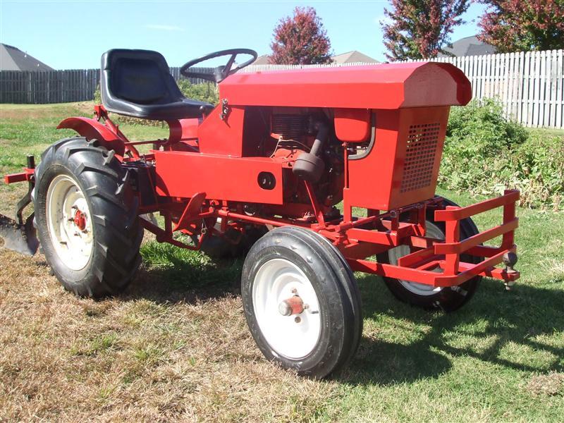

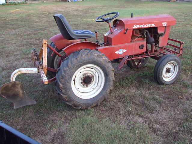

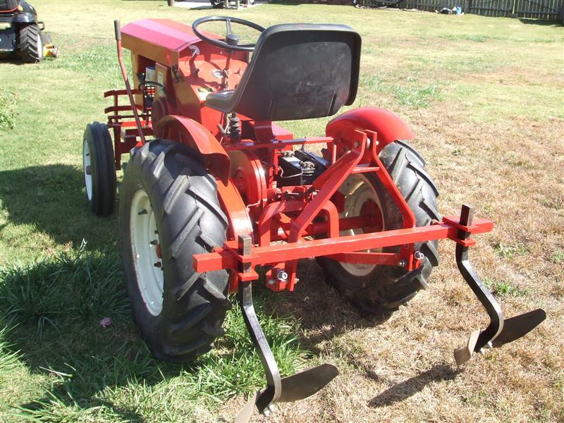

Razorback 1,032 #2 Posted December 12, 2018 (edited) I have a Speedex 1631 and I LOVE IT for it’s rugged nature and simplicity. Mine has a belly mower, plough, disks, furrowers, and cultivators. I don’t use the mower but It does work. It is my favorite GT for ploughing because it sits high on the ag tires, giving you the ability of ploughing a really deep furrow without high-centering. The only “weekness” it has, if you can call it that, is the “Armstrong” lift lever. If that’s a show-stopper, keep your eyes open for a 1632.... the 1632 is a 1631 with hydraulics. Any more specifics about the one you are looking at? Edited December 12, 2018 by Razorback 2 3 Share this post Link to post Share on other sites
Razorback 1,032 #3 Posted December 12, 2018 (edited) Meant to also say..... the transmission input is driven by a belt from the engine. Tension is put on that belt using the right-side foot pedal.... you pivot it toward the front of the tractor which slides the engine forward on the bar-stock frame, which compresses a return spring that pushes the engine back towards you when you pivot the pedal back. The output of the transmission drives a heavy roller chain to the rear tires. Like I said..... simple! Edited December 12, 2018 by Razorback Share this post Link to post Share on other sites
