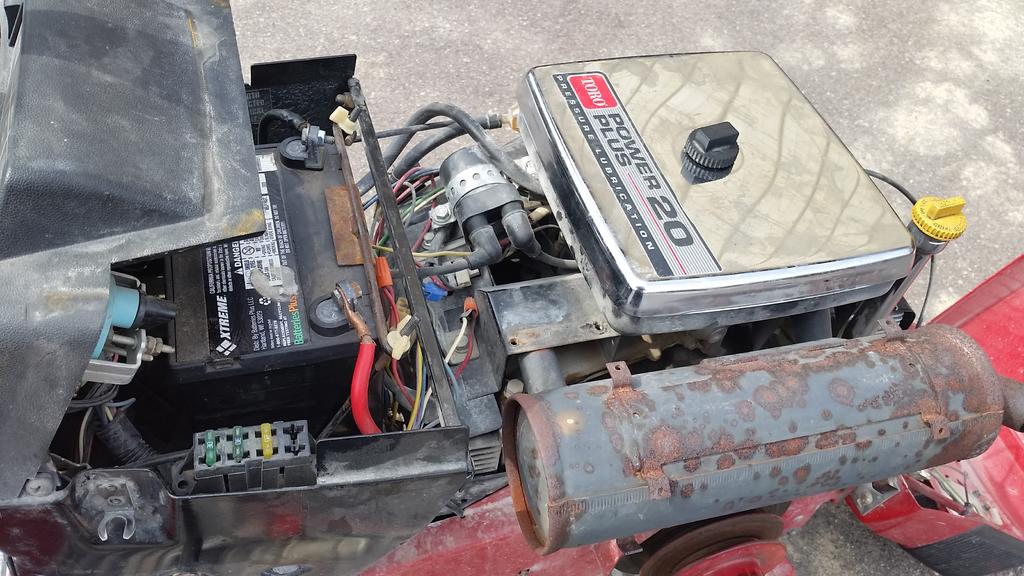

WHX?? 58,226 #8 Posted December 12, 2018 (edited) Should be located in the fuse block on the upper right side of the hood stand. This is if it hasn't been relocated the factory fuse holder has been known to be problematic with overheated and bad fuse holder terminals so a PO may have moved it. As can be see in the pic dirt, water and debris can get in there and mess things up. The fourth slot for a fuse should be factory empty. There is cover made for these but don't think they came from the factory with one. Edited December 12, 2018 by WHX21 1 Share this post Link to post Share on other sites
jimr 1 #9 Posted December 12, 2018 Thanks for the picture but this tractor does not have this multi fuse holder. There is one holder below this location that has one 10 amp and one 20 amp fuse. Both of these were checked to be good. I guess the best course of action is to trace the wiring from the regulator output to the switch UGGG! Regards, Dan K Share this post Link to post Share on other sites

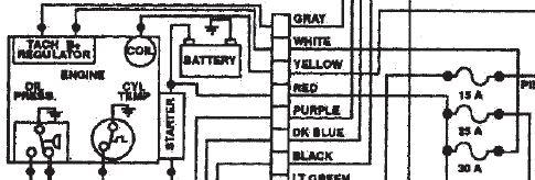

WHX?? 58,226 #10 Posted December 12, 2018 (edited) Yup ..someone's been in there before then. There often isn't much wiggle room in the wiring harness to repair the fuse block so lowering it is an option to gain more wire. Trace out the center B+ wire from the regulator through the nine pin connector. Should go right back to the battery via a 30 amp fuse. In the connector that pin and the pin with the red wire are usually the culprit in the connector. You can see the orange wire nuts in the pic where a PO has already bypassed these out of the connector. Edited December 12, 2018 by WHX21 Share this post Link to post Share on other sites

WHX?? 58,226 #13 Posted December 12, 2018 It's in the manual listed above but here is one for later models. Be careful as the wiring did change abit from late 80s to 90 models. That's why it's kinda important to know the exactly year you are working on. 2 hours ago, jimr said: a little warmer than 25 degrees in the garage! It's 68 in mine.... Later model 520 wire diagram.pdf Share this post Link to post Share on other sites

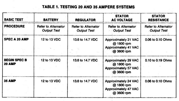

jimr 1 #19 Posted December 15, 2018 Using my telephone tracing tool I got close to the engine connector. I separated this connector and the checked with my ohmmeter for continuity. Traced to the Gray wire of the connector and using the schematic traced to the Tach. don't know the operation of the tach with battery voltage on two terminals of the tach but the indication when the engine was running of a very erratic RPM indication. I measured the resistance to ground on the Batt terminal wire of the regulator and with the key ON I got 11.6 ohms, this would indicate about 1 amp draw. without battery charging, that should be fine. Just waiting for the USPS to deliver the new regulator. Dan K. Share this post Link to post Share on other sites

jimr 1 #22 Posted December 18, 2018 I would have a better understanding of the operation of the tach if the connection was to the AC portion of the regulator. The tach would count the frequency of the AC and convert it to RPM. Connecting to the DC output seems incorrect. That still would not explain the blowing of the 30 AMP fuse at the battery connection. I am sure I checked continuity from the DC out of the regulator directly to the 30 AMP fuse. Since I have returned the tractor to the owner I don't have it available to do more troubleshooting. Also I think the next time a regulator is needed I'll have the owner do the purchasing. He may opt to get an OEM unit rather than one made in Taiwan. It may be the Taiwanese units are physically the same but internally they do not match the OEM. I have written a procedure to follow after separating the tach lead from the DC out. There are a number of steps I can segregate the circuit to determine the root cause. I plan on using an external charger in place of the regulator to simulate the regulator output but that is at another time. To start the T/S again I'd like to know if someone knows the design/correct output of the stator. To me 36 volts on each side of the regulator seems very high. I do have a Cub Cadet that I can check the stator output but it is Winterized at this time and I don't want to go through the process again. Until the temps get higher, thanks to all for the inspiration and have a Merry Christmas and Happy New Year. Regards, Dan K. Share this post Link to post Share on other sites
gwest_ca-(File Mod) 12,489 #23 Posted December 18, 2018 The P220 service manual. Click on the picture and the engines/tractors are listed The Onan's Wheel Horse used have a 20 amp stator. The A, B, C and D are part of the engine spec number. Garry Share this post Link to post Share on other sites
jimr 1 #24 Posted December 18, 2018 I have some confusion. This tractor is a P220 and the above instructions say there should be an open from each AC lead to ground. The schematic also shows only two wires. A later diagram for the P220 shows three wires on the Stator and one going to ground with an internal resistance in the 1.0 to 1.5 ohm range. I will take the AC output voltage in the range of 30 -40 volts as normal for any model. Still have to do more T/S to find the problem. As the diagram stated: "These typical wiring diagrams show the basic wiring necessary for operation of the engine. Your engine may differ in circuitry and features depending on how the equipment manufacturer chose to configure the final product" so having a grounded stator may be correct. Thanks for the information. Regards, Dan K Share this post Link to post Share on other sites
jimr 1 #25 Posted December 20, 2018 Still thinking about the problem of blowing regulators and 30 Amp fuses and I looked at the wiring diagrams of other years. The tractor I am working on is a 1988 model, the wiring of the 1990 model shows the Tach wire going to one of the AC posts on the regulator. This seems much more consistent with how I think the tach should work. The configuration as I received was with the Tach wire (Gray) connected to the B+ output of the regulator. Also some of the individual circuit diagrams show the Stator not connected to ground where others show a ground connection. Does anyone know which is correct? If there is supposed to be NO connection to ground of the Stator, then this tractor may have a short on the Stator. If it is supposed to be grounded, what should the resistance be between each leg to ground and between the legs with the regulator removed? Share this post Link to post Share on other sites
