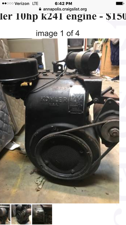

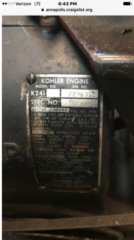

The Tuul Crib 7,354 #1 Posted December 10, 2018 (edited) Just recently found a 10 horse Kohler that had a starter generator and an electric clutch that went with it for 125. Said it’s supposedly came off a John Deere.ooppss! Sorry Anyway the spec number was a 46560d . Said it ran good didn’t smoke but was missing the voltage regulator on the starter generator. Anybody know anything about this spec number? Edited December 10, 2018 by The Tool Crib Share this post Link to post Share on other sites
953 nut 70,312 #2 Posted December 10, 2018 Take a look at this site. https://www.jackssmallengines.com/jacks-parts-lookup/kohler-model-locator.aspx Share this post Link to post Share on other sites
gwest_ca-(File Mod) 12,532 #3 Posted December 10, 2018 K241-46560 - Kohler K241 Engine, K-Series, Jacobsen, 10HP, 7.5KW (Specs 4600-46858) Garry Share this post Link to post Share on other sites
oliver2-44 11,814 #4 Posted December 10, 2018 (edited) That spec number matches that of a Jacobsen. O well, they were faster than meon the reply. Edited December 10, 2018 by oliver2-44 Share this post Link to post Share on other sites
Lee1977 7,809 #5 Posted December 12, 2018 You will have to use the electric clutch as most of those engines did not have ball bearings on the crank for a machinal clutch. Share this post Link to post Share on other sites
pfrederi 21,300 #6 Posted December 12, 2018 17 minutes ago, Lee1977 said: You will have to use the electric clutch as most of those engines did not have ball bearings on the crank for a machinal clutch. That spec # had ball bearings so you can use a manula PTO. (I think all K series had ball beatings except the KT models) Share this post Link to post Share on other sites
