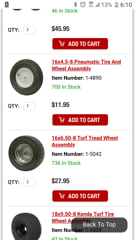

WVHillbilly520H 10,379 #2 Posted December 8, 2018 Have you tried eBay Amazon or Surplus Center... Share this post Link to post Share on other sites
aghead 72 #3 Posted December 8, 2018 What I have found is that they state the hub width and I am not sure how long the hub should be. (from inner to outer bearing) Share this post Link to post Share on other sites

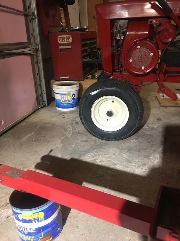

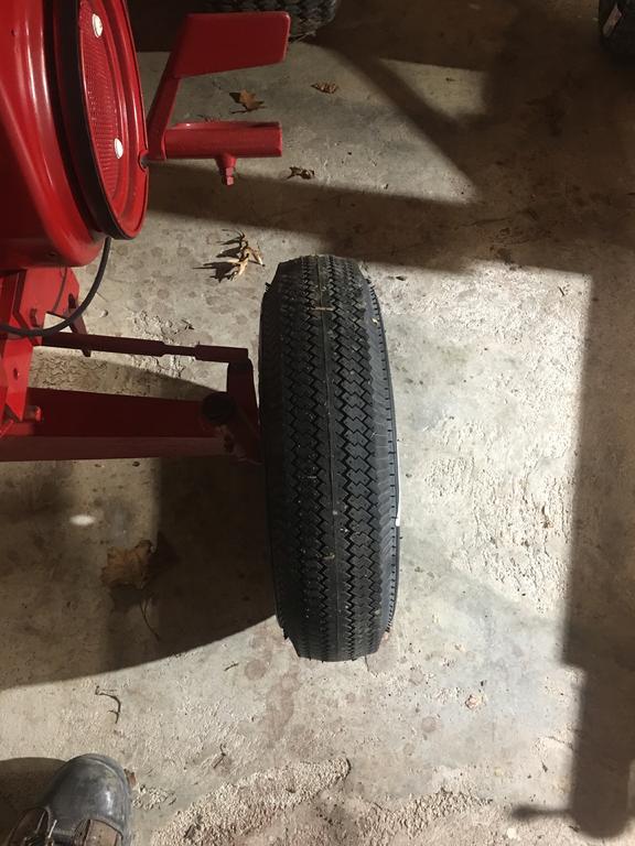

The Tuul Crib 7,354 #4 Posted December 9, 2018 I just got some tires that are 4.80 4.00 x8 for the front of my 855. I thought at first they were going to be a little bit narrow for the rims but once mounted and aired up they look great! Share this post Link to post Share on other sites
aghead 72 #5 Posted December 9, 2018 ^ Those do look very nice! My prob is I have wider tires and narrow wheels. Share this post Link to post Share on other sites
The Tuul Crib 7,354 #6 Posted December 9, 2018 3 minutes ago, aghead said: ^ Those do look very nice! My prob is I have wider tires and narrow wheels. The 16 6.50 x8 should work . I don't like to put a larger tire on a rim than what is supposed to be. Like the 23 8.50 x 12. While the 10.50 would look cool you don't get the full effect of the tire. Share this post Link to post Share on other sites
aghead 72 #7 Posted December 9, 2018 ^ for the 6.50 width tire, they recommend a 5-3/8" wheel width. My wheel is 3.5". That's almost 2" difference. Share this post Link to post Share on other sites
The Tuul Crib 7,354 #8 Posted December 9, 2018 2 minutes ago, aghead said: ^ for the 6.50 width tire, they recommend a 5-3/8" wheel width. My wheel is 3.5". That's almost 2" difference. JMO I would stay with 4.80 4.00 x 8 then like I just installed on mine Share this post Link to post Share on other sites
