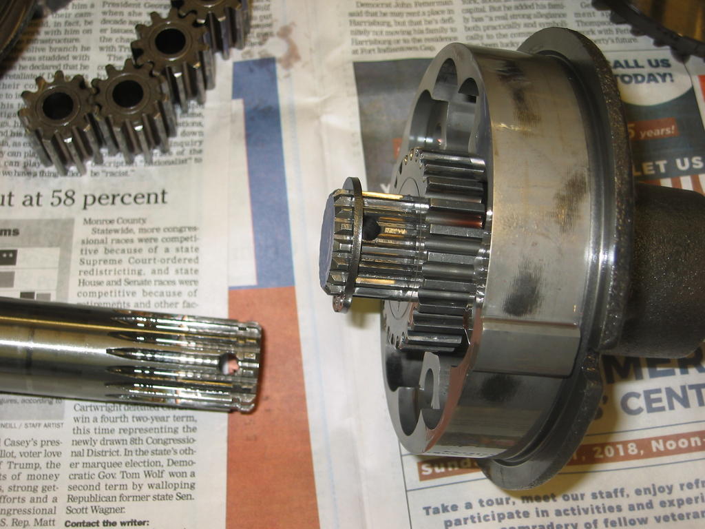

pfrederi 19,941 #1 Posted December 7, 2018 Tearing down the transaxle from an Electro. I want to scream put down the RTV tubes and step away from the tranny. Blue glop all over. But my question...both axles were drilled for roll pins but also had the machined groove for the snap ring. The snap rings were used. The holes were out side the groove. I know some older trannies used the roll pin and later ones used snap rings. You think Wheel horse decided to re-machine old stock to use snap rings??? It almost looks like if you used the roll pin holes the axles would bang together inside the differential.... Share this post Link to post Share on other sites
953 nut 64,277 #2 Posted December 7, 2018 Paul, you know how thrifty the Ponds were. They probably had stacks of drilled axles from three speeds when the six speeds and hydros came out, you wouldn't expect them to put this valuable inventory aside and make up "New" axles would you? 2 1 Share this post Link to post Share on other sites
pfrederi 19,941 #3 Posted December 7, 2018 21 minutes ago, 953 nut said: Paul, you know how thrifty the Ponds were. They probably had stacks of drilled axles from three speeds when the six speeds and hydros came out, you wouldn't expect them to put this valuable inventory aside and make up "New" axles would you? Have to agree.. The splines cut in the axle are about 3/8" longer than any other axles I have lying around. 1 Share this post Link to post Share on other sites
stevasaurus 23,620 #4 Posted December 8, 2018 I'd say you guys are right on. They certainly look factory. What Paul...no pictures of the blue goop??? That is the kind of thing that makes you always want a glass of Rock & Rye close by. The voice of experience. 3 Share this post Link to post Share on other sites
