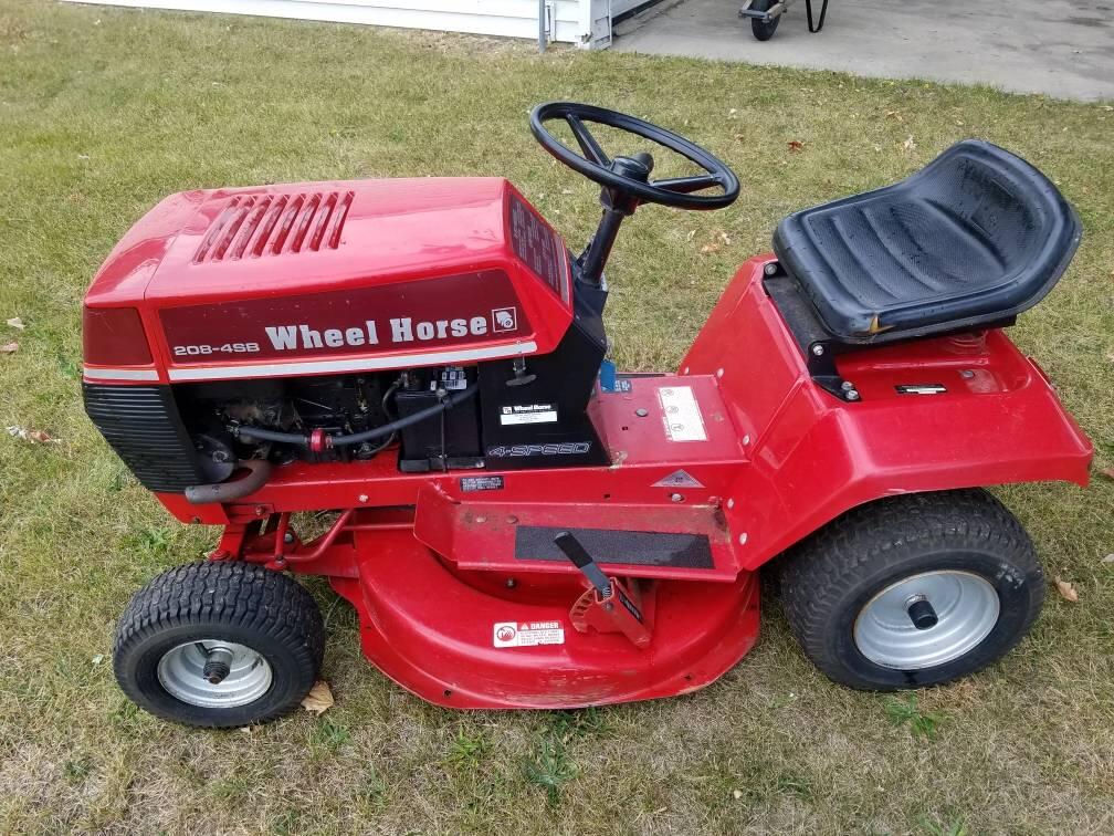

morePEdal 17 #12 Posted December 3, 2020 Greetings: I stumbled on to a 208-4SB that I’m thinking about purchasing. It looks to be immaculate with only two owners. I only have a 1/2 acre and I think this would be perfect because it’s small, has a tight turning radius and because of it’s age, cheaper. Are these machines easy to maintain? The original and 2nd owner seem to have been meticulous in the maintenance. It basically looks brand new. He’s selling it for $375. What are some things I should look for when inspecting this model? I’m brand new to riding lawn mowers, but have some good mechanical skills. Any info would be helpful and appreciated! Thank you! Share this post Link to post Share on other sites
