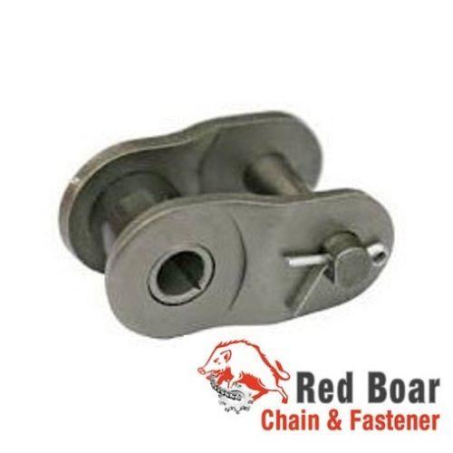

cleat 8,941 #6 Posted December 5, 2018 You may need a 1/2 link as well to get the exact right length. I needed one for the chain I just replaced on a tall chute single stage that I sold. Cleat 2 1 Share this post Link to post Share on other sites

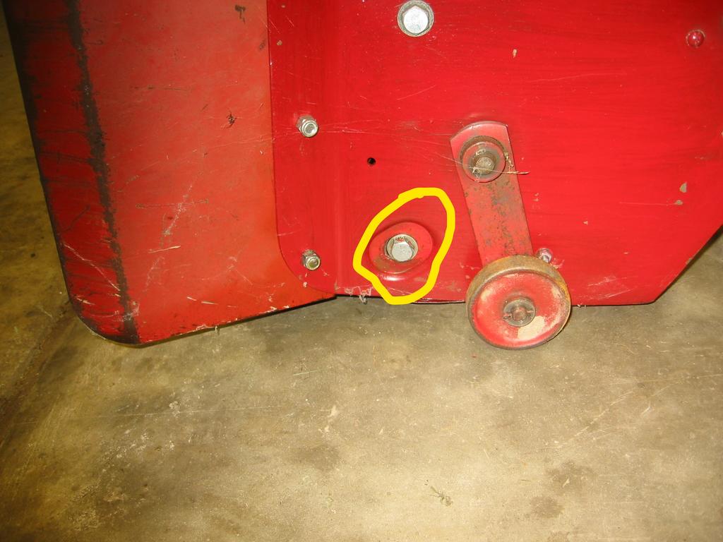

pgenesta 13 #7 Posted December 5, 2018 Peter, I did not see an "adjustment bolt" on the manual that I have. Where is it located? Share this post Link to post Share on other sites
pfrederi 20,273 #8 Posted December 5, 2018 left side lower bolt (circled) is in a slotted hole 1 Share this post Link to post Share on other sites
peter lena 9,850 #9 Posted December 5, 2018 on the OUTSIDE of the chain drive area, lower area of blower side , there is a recessed oblong mounting bolt point . the oblong area is your tension adjustment point, that is where I use the serrated washer, its numerous biting points will trap your setting. I too have a 42st01 , and know all its service areas. I also turned the bolt around , so the tightening elastic nut is outside, for easy touch up. thank you ( pfrederi ) for the photo assist. any other questions ,just ask, Pete 1 Share this post Link to post Share on other sites
pgenesta 13 #10 Posted December 5, 2018 Great info and thank you for the picture. "If I knew then what I know now"...I would not have ordered a new chain and a chain breaker since all it probably needed is an adjustment. But hey, now I have a spare chain and a new tool! Cleat, thank you for the suggestion. Thank you guys. 1 Share this post Link to post Share on other sites
