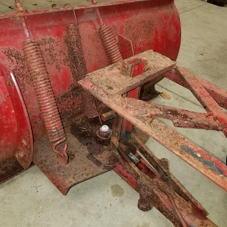

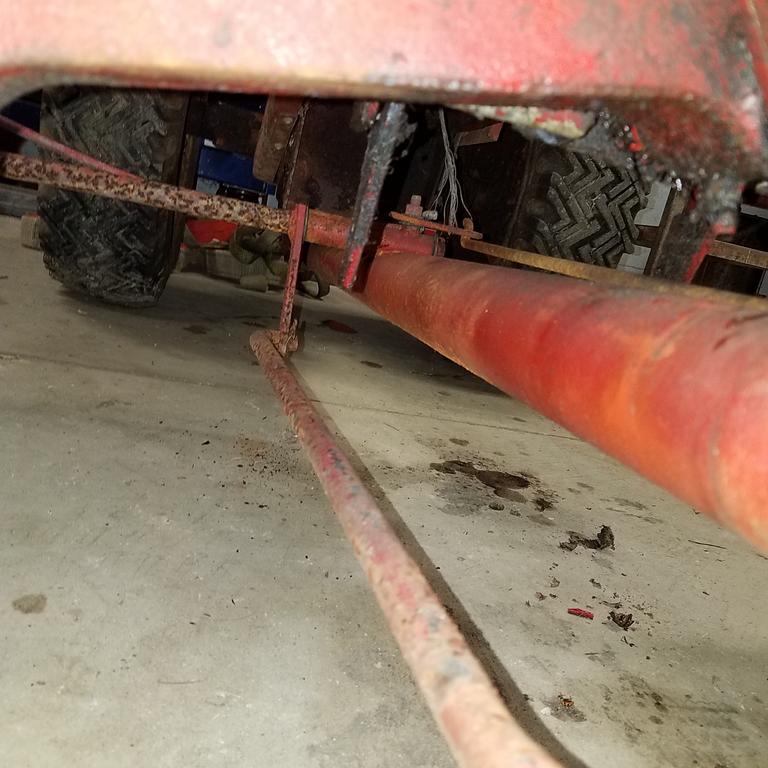

moe1965 774 #1 Posted December 5, 2018 (edited) I started working on my latest restoration project. I'm wondering if the snow blade is a wheel horse blade or is it something the P.O. made up it has a single round tube that goes all the way back to the trans and not a tubler frame I'm used to seeing on later models. There is a addition that the P.O. added I'm guessing for more stability on top or the blade that is in the front of the tractor front frame to prevent the blade from shifting from side to side while under a load. The rest of the blade looks factory that moves the blade left and right and locks into position. Thanks in advance. Moe Edited December 5, 2018 by moe1965 Added picture Share this post Link to post Share on other sites
rjg854 13,311 #2 Posted December 5, 2018 No, I highly doubt that is an original dozer blade. Share this post Link to post Share on other sites
WVHillbilly520H 10,379 #3 Posted December 5, 2018 Looks more a Gravely or Power King/Economy style blade ... Share this post Link to post Share on other sites
moe1965 774 #4 Posted December 5, 2018 Is it possible to convert a long frame wheel horse plow to fit the short frame tractor Share this post Link to post Share on other sites
WVHillbilly520H 10,379 #5 Posted December 5, 2018 (edited) 22 minutes ago, moe1965 said: Is it possible to convert a long frame wheel horse plow to fit the short frame tractor Yes... The long frame usually has 2 sets of holes for the rear hitch rod just put the 3/4" diameter rod in the forward set. Edited December 5, 2018 by WVHillbilly520H 1 Share this post Link to post Share on other sites
gwest_ca-(File Mod) 12,455 #6 Posted December 5, 2018 Whoever put that blade together did a very good job of it. Garry Share this post Link to post Share on other sites
moe1965 774 #7 Posted December 5, 2018 Thanks WVhillbilly520H I have a blade for a long frame I think I'll convert so it will fit both of my tractors and get rid of the one currently on the 845. 1 Share this post Link to post Share on other sites
new2horses 288 #8 Posted December 6, 2018 That blade was made to fit a red tractor, but not a Wheel Horse. It's for a Massey Ferguson. Pretty hard to find piece of equipment. 2 Share this post Link to post Share on other sites

ebinmaine 80,304 #12 Posted December 23, 2018 On 12/5/2018 at 7:16 AM, WVHillbilly520H said: Yes... The long frame usually has 2 sets of holes for the rear hitch rod just put the 3/4" diameter rod in the forward set. Jeff, I have a plow frame off of a c-160. It does have the second set of holes and I'm thinking of putting it on an 867. I'm assuming that the plow angle lever must end up behind the right hand Stirrup instead of in front of it? Share this post Link to post Share on other sites
WVHillbilly520H 10,379 #13 Posted December 23, 2018 37 minutes ago, ebinmaine said: Jeff, I have a plow frame off of a c-160. It does have the second set of holes and I'm thinking of putting it on an 867. I'm assuming that the plow angle lever must end up behind the right hand Stirrup instead of in front of it? There in lies the problem is that I've never had a short frame, but going by logic I would say it should stay where it should be "short frame and forward hole on plow frame" but I'm sure the elder experts will be along to verify or not. 1 Share this post Link to post Share on other sites

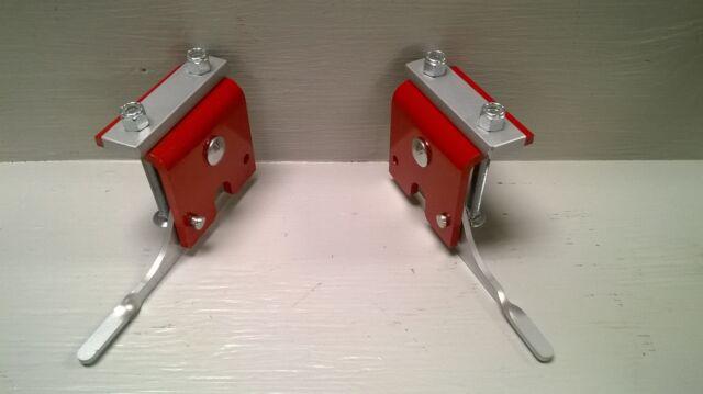

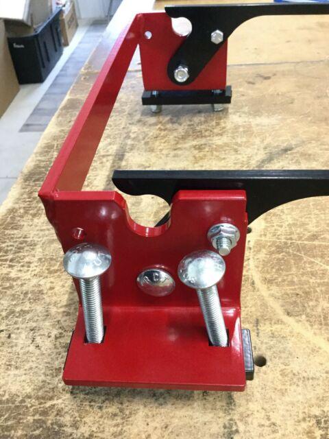

Ron A. 35 #16 Posted February 27, 2020 (edited) Thanks for the response. It didn't make much sense to me using the clevis hitch pin mount pushing snow or dirt around, especially being part of the gear housing. Trying to get the clevis hitch free as well so the lift is operational. Pb Blastered it to death for 3 days now. Will be ordering the axle mount tomorrow, again Thanks for the information. Do you have a suggestion on the axle mount with the spacing bar or the set without the spacing bar? Thanks again. Edited February 27, 2020 by Ron A. spelling errors are painful Share this post Link to post Share on other sites
ebinmaine 80,304 #17 Posted February 27, 2020 5 minutes ago, Ron A. said: you have a suggestion on the axle mount with the spacing bar or the set without the spacing bar? Can you show a picture or send me a PM with links so I can see what you mean? I only know of one style of plow bracket. They bolt to the square part of the axle housing. The rear hitch pins are well-known 4 being rust welded in place. Don't be afraid to throw some heat at it. I'm not a huge fan of PB blaster. I've had much better luck with several other things including old school liquid wrench. Be patient with that and heat, cool, heat, cool, repeat, repeat repeat repeat Chances are pretty high you'll get it eventually. Share this post Link to post Share on other sites
Ron A. 35 #18 Posted February 27, 2020 (edited) the first are the separate rear axle mounts and the latter is the full mount. Not much difference in price and I'll probably get the full mount for around $70 new. Seems like the separate mounts might not be as stable. The what I call 'partial' mounts are $55. Found a used set for around $50 with shipping. Thanks again with the advice on the pin... Figured it was just being stubborn, little cold here still and I didn't want to go walloping it. Edited February 27, 2020 by Ron A. Share this post Link to post Share on other sites
ebinmaine 80,304 #19 Posted February 27, 2020 1 minute ago, Ron A. said: the first are the separate rear axle mounts and the latter is the full mount. Not much difference in price and I'll probably get the full mount for around $70 new. Seems like the separate mounts might not be as stable. The what I call 'partial' mounts are $55. Found a used set for around $50 with shipping. Thanks again with the advice on the pin... Figured it was just being stubborn, little cold here still and I didn't want to go walloping it. definitely the one WITH the cross support. I didn't even know they made them the other way. Is that on wheel Horse parts and more? they are one of this sites awesome vendors. If you have a hand torch it would be difficult to overheat that hitch. Oxy-acetylene obviously you would want to use caution. They are pretty rugged but it is also a cast-iron case which I'm sure you realize can be a bit brittle.... Share this post Link to post Share on other sites
