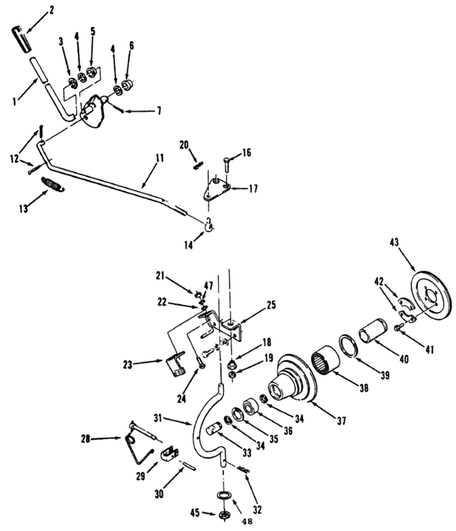

gwest_ca-(File Mod) 12,535 #5 Posted December 5, 2018 Sounds like the classic pto clutch slipping. You should pull the pto assembly off and check the clutch lining thickness. Wear will expose the rivets and ruin the pressure plate. While off work some fresh grease into the large needle bearing. You don't want any extra as it can work it's way the the friction material and ruin that. Free up that threaded trunnion on the pto rod so it threads easily. It needs to be tightened up so when the pto is applied the handle snaps over center with a bit of authority. Hard to describe the proper tension but you want the deck to speed up immediately and not slip under load. Sometimes the clutch will emit a high pitched squeal like a belt when it slips. You don't want that. If you have got this far you need to reinstall the pto brake. With engine not running apply the pto clutch. Slip a business card between the pulley and the brake pad. Hold the pad tight to the pulley and tighten the bolts. Remove the card and release the pto clutch. Garry Share this post Link to post Share on other sites

gwest_ca-(File Mod) 12,535 #12 Posted December 9, 2018 Just a cotter pin #12 in the back end. Garry Share this post Link to post Share on other sites

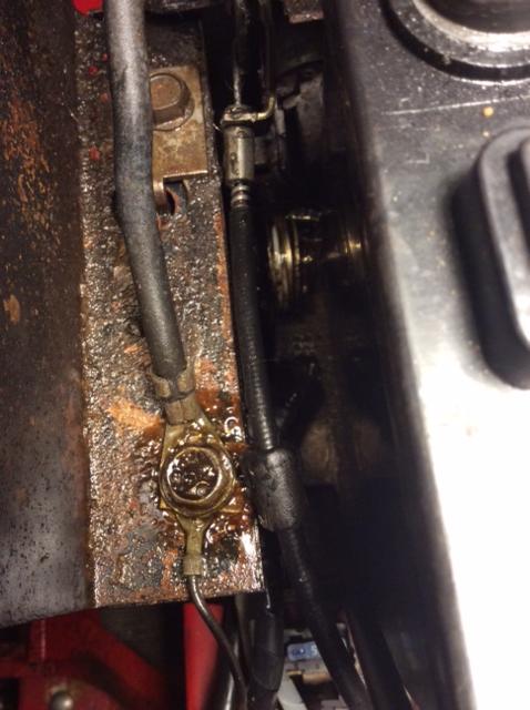

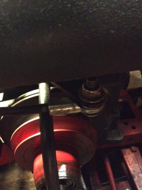

TC10284 124 #13 Posted December 9, 2018 Right, I can see it, but I cannot access it easily. Is there a trick? Share this post Link to post Share on other sites
refracman 167 #14 Posted December 9, 2018 You shouldn't have to remove it to clean it up and get the trunion to move. Do you have a good wire brush? use it and get busy on the threads on both sides of the trunion, even better is you have one on a grinder or dirll! leave the trunion attached to # 17 for as long as you can to get the treads cleaned up. also clen up the pully where the deck drive belt goes. she looks a tad rusty there too. then cover up the pully and belt then soak with PB, let it soak, if you have a way to heat it some, more the better, once off chase it with a die. to adjust it like stated above its a trial and error thing but should take more than a couple of minutes. on the belt noise, check the mule drive pullys make sure they spin free and same with the deck belt and spindles. Some good advise on the run with choke issue, either its a dirty carb ( most likely) or worn throttle shaft. While your at it I would take the cover plate off and check the shifter boot, they are cheap enough and good insurance as it looks like she has been out in elements for a bit 1 Share this post Link to post Share on other sites

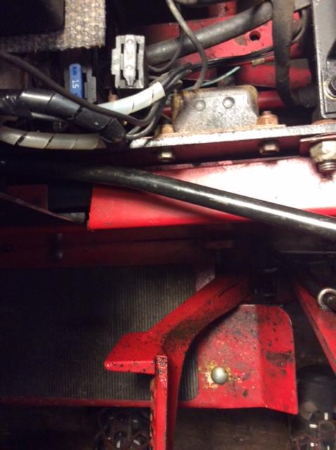

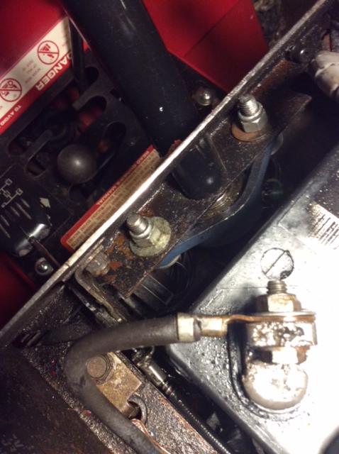

peter lena 10,109 #15 Posted December 9, 2018 the trick is to remove the battery, and clear up the problem. with battery out , now you can see the very sloppy stop/fit of the lever. notice how the rod has been grinding against the fuse holder area? local hardware store has steel and nylon washers to fill in end gap fit near battery . that has to be solid and smooth to properly work. your carb is long overdue for a rebuild, lack of basic maintenance is evident, LUBRICATION ? WHATS THAT? the rust coated pto and related areas also need clean up. That pto trunnion should be free to move. what I am seeing is a basic starting point to recover this horse, this is the first area that I change over on a recent purchase. its frustrating because , EVERYTHING HAS BEEN NEGLECTED , as you start to get things moving/ working , it gets much better. I will send you a few pictures, to clear up my view of this common problem. hang in there , pete Share this post Link to post Share on other sites
TC10284 124 #16 Posted December 9, 2018 (edited) My issue is that I cannot physically get to the key with pliers or needle nose pliers (part 12 in the diagram above) at the end of the shaft to remove it. Maybe I don't have the right kind? I am removing it because re-threading the threads, along with WD40/PBBlaster did not help. It was so rusted that it snapped the rod in two at the threads when trying to free up the trunnion. I have an extra one on a parts 520H that is is good condition, but am having difficulty figuring out how to get either one of them removed. Edited December 9, 2018 by TC10284 Share this post Link to post Share on other sites

peter lena 10,109 #18 Posted December 9, 2018 first picture shows ,reason to remove battery, it also shows shimming washers on lever end , that must be snug ,to operate properly. Second picture shows heim joint in place of trunnion fitting, constant smooth/solid ,moveable joint to pto engagement point. Third photo shows 3/4" 2 bolt flange bearing to stop steering column slop.fourth photo shows clearance to lever rod near fuse frame , no rubbing and smooth free movement. I realize that to the w/h purists this simply cannot be done. along with the fluid film anti rust film on related surfaces. I also use cable wrap to secure and run wire. having recently done this , I find it to be a base line initial service, that make neglected areas come back to life with a like new solid smoothness, that's only me , pete Share this post Link to post Share on other sites

peter lena 10,109 #20 Posted December 10, 2018 no the battery will give you access. You will be looking at the end of lever arm as it comes thru the flat cam and bracket support. notice the play at the angle, easy to pull the cotter pin and add washers to eliminate that play. That will also tighten up the outside lever . at right side of dashboard area. I use both steel washers and nylon washers at bracket support area, I use synthetic grease /lube at all moving points. makes it work smooth and solid. by the way the # 13 spring ,witch hooks onto the back side of the fuse holder area , is holding your lever arm in place. looking at the loose end of the arm, just fill in the gap to make it snug . this is fairly easy, having done it and related areas will make it better. I just added the other pictures because its a very good area to correct. any other questions just ask , pete Share this post Link to post Share on other sites

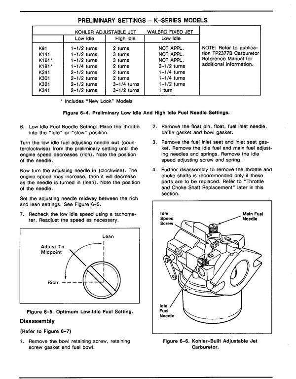

TC10284 124 #22 Posted December 22, 2018 (edited) Does anyone have a PDF or link for the factory jet and idle screw settings for the carb on this 312-8? Pics of the carb can be found here: https://imgtc.com/a/7kbkbk1 I may just need to take it off completely and have it cleaned/soaked. I could only get it to run for maybe 20-30sec with squirting fuel in the carb. I have some replacement fuel line to replace that when it isn't so nasty and muddy out. Edited December 22, 2018 by TC10284 Share this post Link to post Share on other sites
tunahead72 2,662 #23 Posted December 23, 2018 My internet isn't working well right now, so I can't get your photos to load in this lifetime... You should be able to find an owner's manual for your engine in the Manuals section here on RedSquare (Kohler K-series). Initial carb settings depend on which carb you have, either a Kohler/Carter with both a high and low air adjustment, or a Walbro with either one or two air adjustment screws. Either carb will have a main fuel needle. You should at least remove that and clean it thoroughly, including any tiny air holes you might see along the shaft. Share this post Link to post Share on other sites
wallfish 20,733 #24 Posted December 23, 2018 From the Kohler manual. Suggest you remove the carb and, at minimum, clean it. Share this post Link to post Share on other sites
