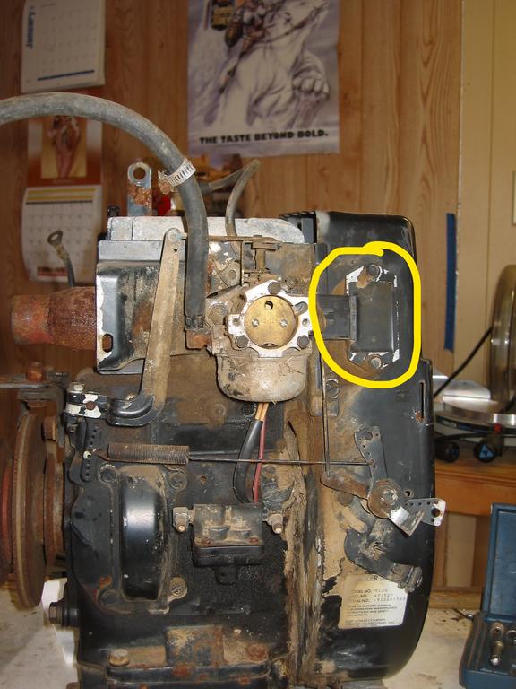

pfrederi 21,188 #4 Posted December 4, 2018 Should be plug and play assuming your M12 has a voltage regulator and is not one of the 3 amp unregulated systems..WH went cheap on some models/years and opted for the unregulated system. Share this post Link to post Share on other sites
Duramax7man7 506 #5 Posted December 4, 2018 How do I diagnose that? smh Share this post Link to post Share on other sites
pfrederi 21,188 #6 Posted December 4, 2018 Small box with three contacts upper front of blower housing is regulator. (Circled) If there is just a plate covering the hole it is a 3 amp system Did headlights work with the engine not running on the donor tractor, if they did regulator system. if they didn't 3 amp unregulated 1 1 1 Share this post Link to post Share on other sites
Duramax7man7 506 #7 Posted December 4, 2018 OH that's all. lol They both have the regulator. 1 Share this post Link to post Share on other sites
