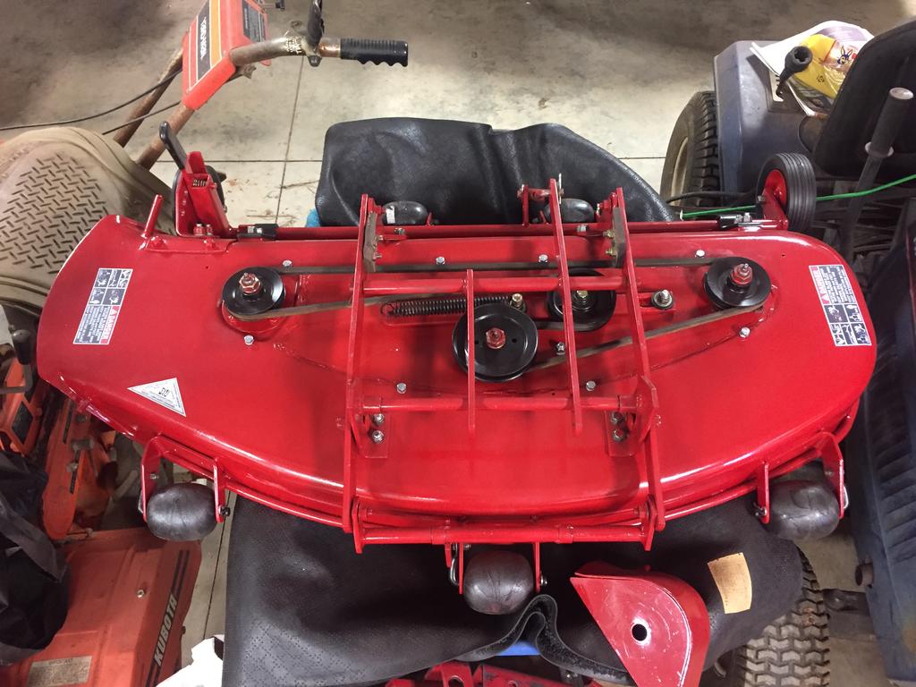

WheelHorse314-8 58 #51 Posted December 14, 2018 35 minutes ago, bds1984 said: I have a 315-8 and am running an oil filter for my 2015 Focus on it. A short filter with 3/4 x 16 thread will work. As for you spindles, I've swapped 6 and 8 inch wheels between both spindle lengths with no issues while using 42 and 48 inch decks and have the 6-inch spindles on my 520 with 8-inch wheels right now, it just sits up higher. It may be possible to convert a 260-series to work for you 312. I did it using a deck meant for a 270. All the holes I needed were in the deck shell so I swapped out some bits and pulleys and had a brand new 48-inch deck. Pics are here. But when you change the 6in and 8in wheels out won't that make it so the mower deck height would be off? So you took a 260 series deck and put it on a 315? If I could do that it would be awesome! Share this post Link to post Share on other sites

bds1984 1,519 #53 Posted December 15, 2018 You can adjust the angle of the deck by turning the trunnion that is at the rear of the mower deck. I never noticed any height issues since I mow on the higher end of the spectrum. If you have both decks side-by-side, tools, and mechanical ability, you should be able to make a 260/270 deck work by swapping parts over. My 48-inch deck was pretty rough and came across a NOS 48-inch deck from a 270. After a couple hours of wrenching I had a new 48-inch deck for my C165-8. The 270 deck had all the bolt holes punched out for the attach-a-mattic hangers so that part was easy. The most challenging part was swapping over the spindle shafts but even that wasn't a big deal. Now I cannot speak to whether or not your deck parts from a 42-inch deck will swap to the 48-inch. If you can get that 48-inch deck for cheap, I say it is time to experiment! Share this post Link to post Share on other sites

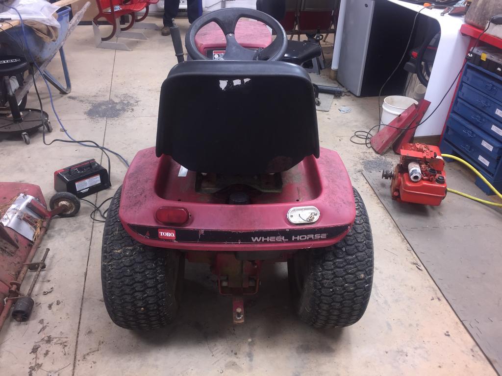

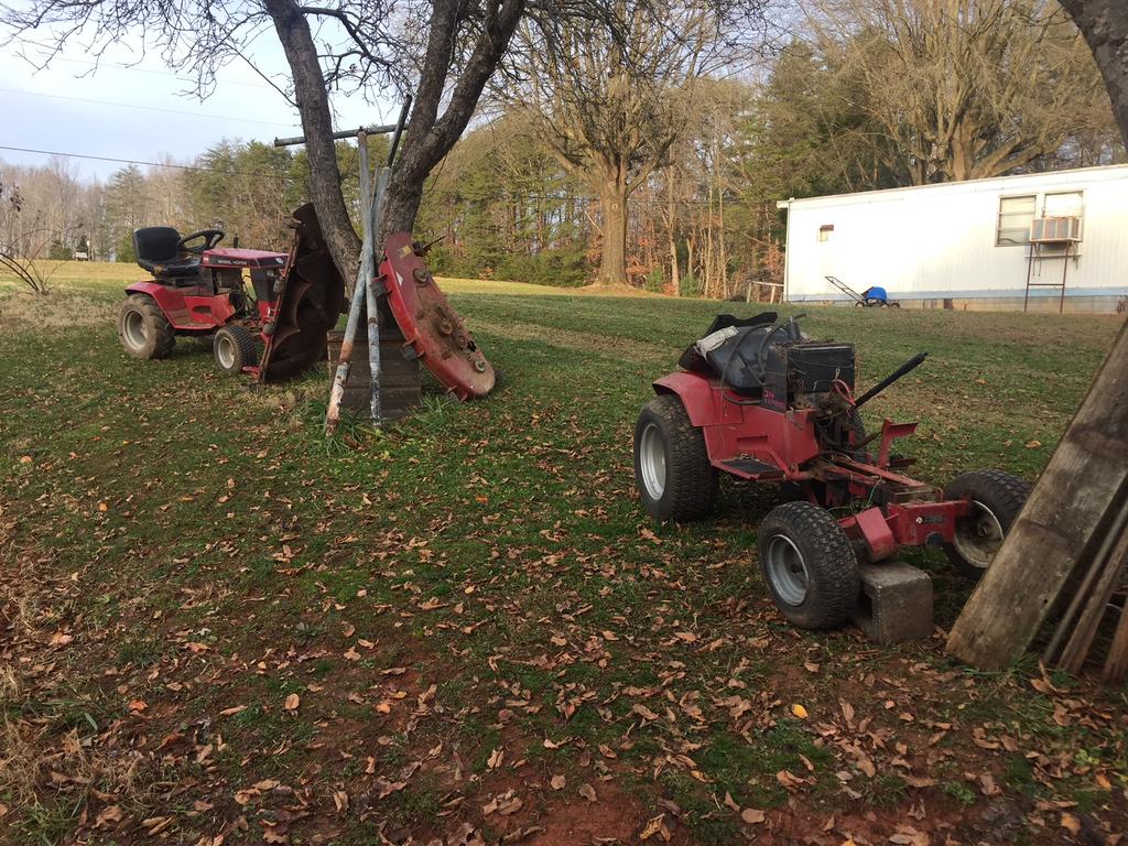

WheelHorse314-8 58 #56 Posted January 2, 2019 Added 2 more horses to the stable (for parts) over the weekend. (AND YES Wheel Horse wheels are offset in the front to accommodate the steering factor.) 1 Share this post Link to post Share on other sites

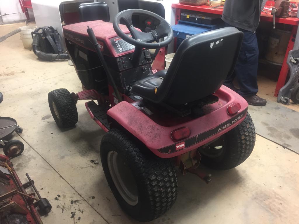

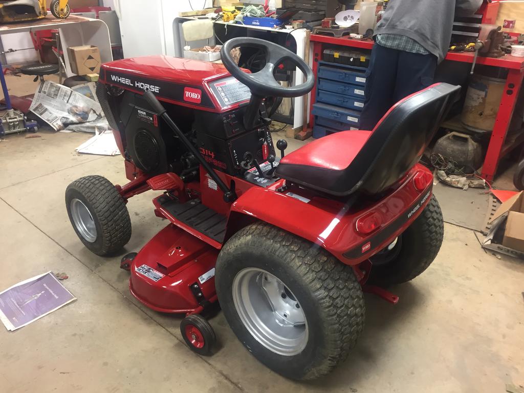

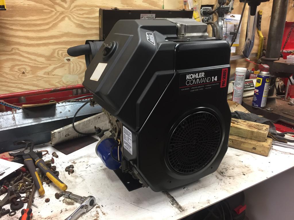

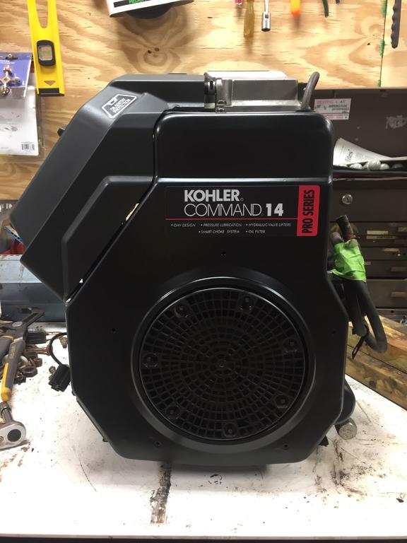

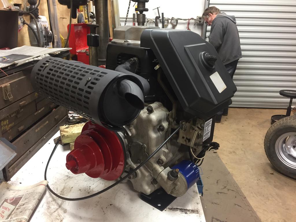

WheelHorse314-8 58 #57 Posted February 25, 2019 Update on my project 314-8. The deck and engine are complete. Here are some pictures. More to come as I paint and re-assemble. 2 3 Share this post Link to post Share on other sites

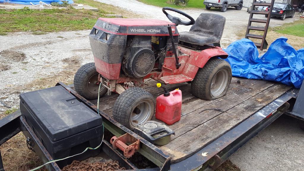

WheelHorse314-8 58 #58 Posted February 25, 2019 On 12/4/2018 at 11:07 AM, Lane Ranger said: My $250. 1995 (314-8. Before and after with just a good cleaning! Plus new tires all the way around! What brand of tires did you use? Where did you get them from? 1 Share this post Link to post Share on other sites

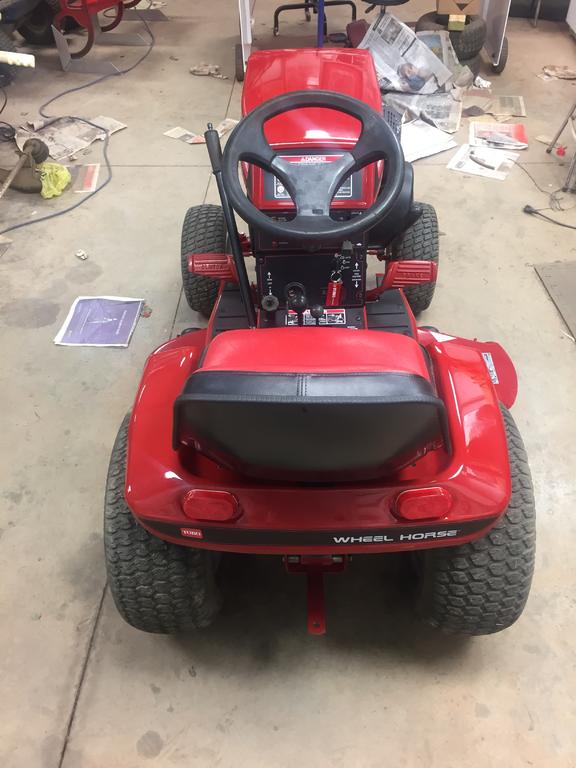

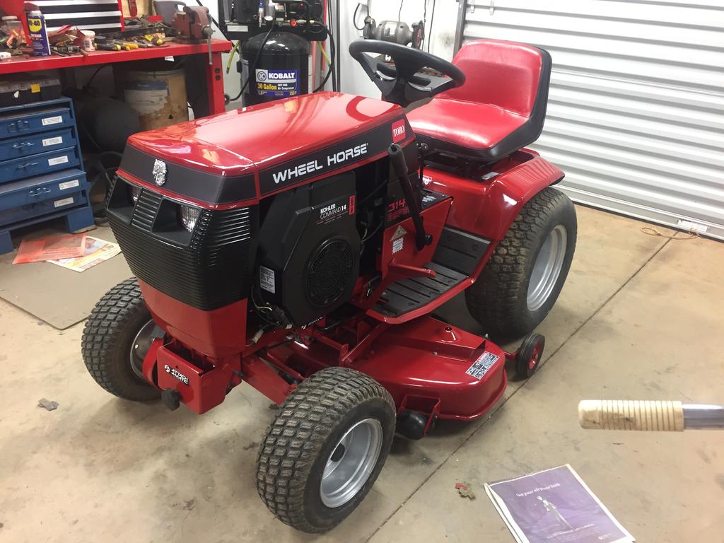

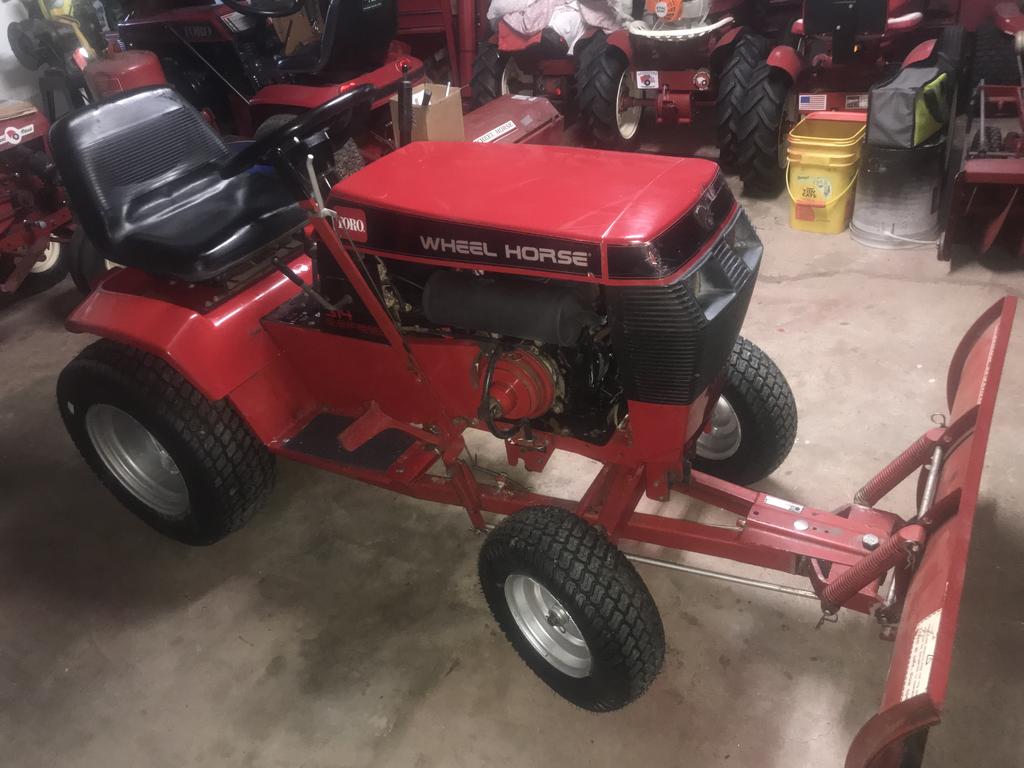

WheelHorse314-8 58 #59 Posted March 12, 2019 ok, so with the exception of some minor odds and ends my frame off restoration is all done! what do you guys think? do you like my RED seat 3 5 Share this post Link to post Share on other sites
classiccat 548 #60 Posted March 12, 2019 Beautiful Job!! 1 1 Share this post Link to post Share on other sites
lynnmor 9,037 #61 Posted March 12, 2019 Tell us more about the seat. Did you use the original seat pan or foam? Did you find a shop that can refurbish these seats? Share this post Link to post Share on other sites

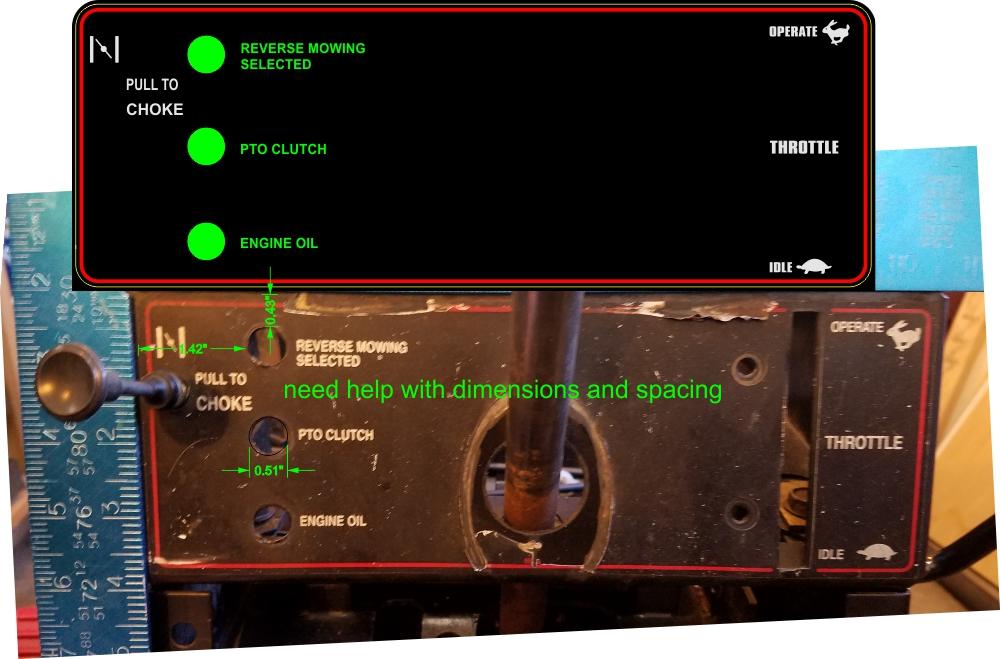

fast88pu 3,394 #62 Posted March 12, 2019 On December 3, 2018 at 1:15 PM, Vinylguy said: Wheel Horse 314-8 newbie was inquiring about decals for his tractor. Here is what I have so far. Need help with dimensions and spacing to complete the upper dash panel decal. Started working on the newer models with Martin a few years ago and have been meaning to get a set listed but somehow forgot about it. Many of the newer models are no longer so new and will be coming available for restoring in the not so distant future. Do you still need terry? Share this post Link to post Share on other sites
WheelHorse314-8 58 #63 Posted March 12, 2019 2 minutes ago, fast88pu said: Do you still need terry? Who do you think made all those AWESOME looking decals on my tractor? 2 Share this post Link to post Share on other sites
WheelHorse314-8 58 #64 Posted March 12, 2019 15 minutes ago, lynnmor said: Tell us more about the seat. Did you use the original seat pan or foam? Did you find a shop that can refurbish these seats? Original seat pan. Original foam with some extra added. I buddy of mine who does upholstery work re-covered it for me. He does excellent work! 1 2 Share this post Link to post Share on other sites
peter lena 10,047 #65 Posted March 12, 2019 love the seat, it fits very well ,along with all of your other mods, like the deep dish steering wheel, more leg room .for what that cost you and your own work that was a terrific buy. like the way you have been adapting as you go , making it truly your own , great job , pete Share this post Link to post Share on other sites
WheelHorse314-8 58 #66 Posted March 12, 2019 6 minutes ago, peter lena said: love the seat, it fits very well ,along with all of your other mods, like the deep dish steering wheel, more leg room .for what that cost you and your own work that was a terrific buy. like the way you have been adapting as you go , making it truly your own , great job , pete Thanks. Everything is factory that I know of with the exception of the seat cover and I changed the front wheels from 6in to 8in. Share this post Link to post Share on other sites
Pullstart 71,207 #67 Posted March 12, 2019 What a pice of work! It looks pretty sweet, you should be proud! 1 Share this post Link to post Share on other sites
