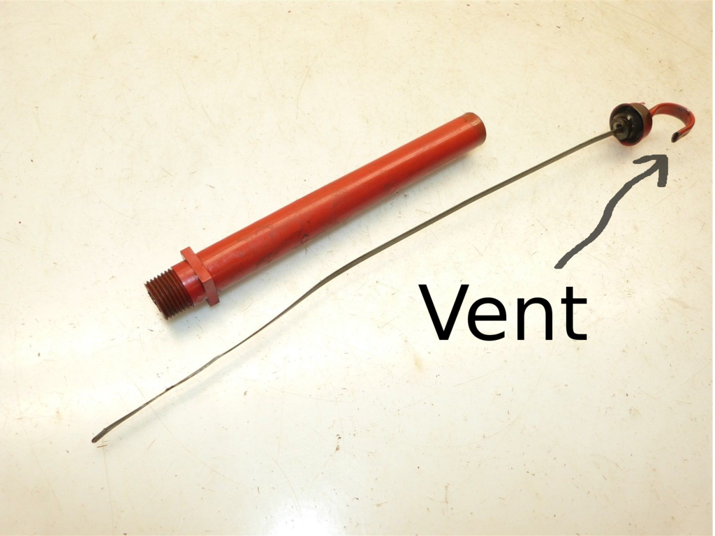

cleat 9,290 #5 Posted December 2, 2018 (edited) Assuming all gaskets and seals are good then the actual vent is the dipstick itself at the end of the dipstick handle. I have washed all of mine and water never got in. Note: If you have a trans that builds pressure then leaks oil out of seals then this vent may be plugged. I checked all of mine and at least 2 were plugged. Cleat Edited December 2, 2018 by cleat 3 2 4 Share this post Link to post Share on other sites

lynnmor 9,025 #7 Posted December 3, 2018 19 hours ago, cleat said: Assuming all gaskets and seals are good then the actual vent is the dipstick itself at the end of the dipstick handle. I have washed all of mine and water never got in. Note: If you have a trans that builds pressure then leaks oil out of seals then this vent may be plugged. I checked all of mine and at least 2 were plugged. Cleat I checked all 3 of mine today and 1 was open, 1 was pinched shut at the end (looks like a factory error), and 1 was plugged with debris. Good information about that being a vent, never knew that, thanks. 2 Share this post Link to post Share on other sites
cleat 9,290 #8 Posted December 3, 2018 Wheel Horse does not mention this anywhere. I only found out after looking for a vent. I knew there had to be one somewhere and it was actually by accident that I pulled a dipstick and a light went on after I blew through one that was clear to begin with. Cleat Share this post Link to post Share on other sites
CraigArndt 13 #9 Posted January 17, 2019 (edited) On 12/2/2018 at 4:01 PM, cleat said: Assuming all gaskets and seals are good then the actual vent is the dipstick itself at the end of the dipstick handle. I have washed all of mine and water never got in. Note: If you have a trans that builds pressure then leaks oil out of seals then this vent may be plugged. I checked all of mine and at least 2 were plugged. Cleat I had no idea that was a vent. I need to check mine if the 520H has one. Edited January 17, 2019 by CraigArndt Share this post Link to post Share on other sites
