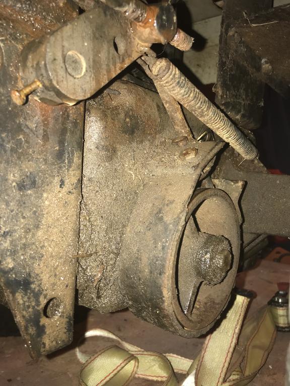

dells68 7,499 #3 Posted December 1, 2018 iI just pulled the ratty ole GT1100 I’m building for Emory’s Christmas this year into the basement. I took a pic of the brake spring. Kind of a cruddy picture. Hope it helps. Share this post Link to post Share on other sites
Lee1977 7,638 #4 Posted December 1, 2018 8 minutes ago, dells68 said: iI just pulled the ratty ole GT1100 I’m building for Emory’s Christmas this year into the basement. I took a pic of the brake spring. Kind of a cruddy picture. Hope it helps. That is the clutch spring. Share this post Link to post Share on other sites
dells68 7,499 #5 Posted December 1, 2018 Oops! My bad, tired from a long day. I get points for trying - right?😂 1 Share this post Link to post Share on other sites
Lee1977 7,638 #6 Posted December 1, 2018 It's a little confusing the clutch shaft runs inside of the brake tube. Share this post Link to post Share on other sites
