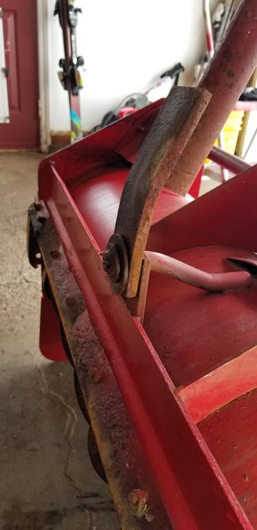

USHorse 41 #1 Posted November 30, 2018 Have a 1990 blower (06-42ST06) on a 1987 310-8. The hairpin cotter pin keeps shearing off from the flag that connects the lift tube to the lift mechanism. So, here are my thoughts as possible causes. 1. The cotter pins, likely from Harbor Freight are of low quality. 2. The flag that i am using (RS member made) has the lift assist spring where the spring attaches to the left side of the flag....meaning under my left foot when sitting on the tractor. I have another flag that has the point of attachment for the spring on the right side. Did they make them different? 3. The lift tube is welded directly to the blower by previous owner. Maybe having no movement in this connection point is creating undo stress causing the pin to shear? 4. The lift spring seems to drift on the cross member piece....maybe its binding causing stress. What are everybodys thoughts. BTW...the pin always breaks when i am at farthest away from the garage 1 Share this post Link to post Share on other sites

USHorse 41 #4 Posted November 30, 2018 Here is a picture. The weld can't be seen very well but looks like PO added weld material at the end of the stub to act like a mushrumed nut. Surprised it as held 2 seasons for me. Share this post Link to post Share on other sites
peter lena 9,938 #5 Posted November 30, 2018 the angular difference is the issue, have you tried turning that lift rod over? You can easily do that , is does not matter to the flag hook up. I am not familiar with that hook up , mine has the blower mount hook , facing down. my lift rod has a slight curve facing up ,to the blower bottom hook, if you can't get those contact points level to each other , you will not improve this , pete Share this post Link to post Share on other sites

USHorse 41 #7 Posted November 30, 2018 1 hour ago, peter lena said: the angular difference is the issue, have you tried turning that lift rod over? You can easily do that , is does not matter to the flag hook up. I am not familiar with that hook up , mine has the blower mount hook , facing down. my lift rod has a slight curve facing up ,to the blower bottom hook, if you can't get those contact points level to each other , you will not improve this , pete I will take a look but the lift rod is welded to the hook so i can't turn anything. Share this post Link to post Share on other sites

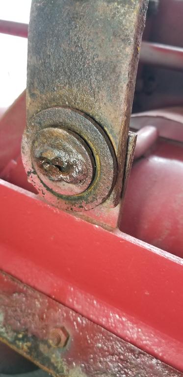

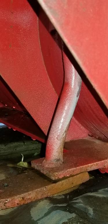

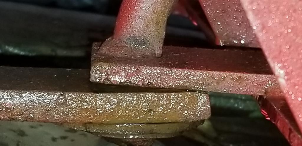

USHorse 41 #9 Posted December 1, 2018 Thank you all for your input. I removed blower from tractor to get a closer look. Took a few close up pics. I would say that the PO definitely welded the lift tube to the round metal stub as a fix. The stub must have broken off. Can i grind off the weld and have someone weld in some new round stock to the proper length? Anyone know the lenght the stub should be? Share this post Link to post Share on other sites
wallfish 20,186 #10 Posted December 2, 2018 It seems that lift rod is being held too tight on the rod and creating down force on the other end, pulling down hard on the flag when it's lifted. Which in turn could be the issue with the flag pulling out and breaking pins. 1 Share this post Link to post Share on other sites
