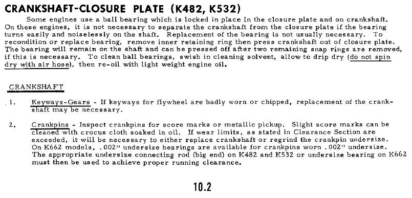

Dan693 510 #5 Posted November 30, 2018 Just as I suspected......a big C-clip behind the side cover seal holding the cover on. Nothing about that in the service manual that I saw. 3 jaw puller finally broke the C-clip. Its a miracle the side cover didnt shatter and still may have a warped side cover. The only way to do it that I can see is drill out and remove the seal from the outside to expose the C-clip???? I must have the wrong service manual for the K series twins. Who knows....... 1 Share this post Link to post Share on other sites

gwest_ca-(File Mod) 11,853 #8 Posted December 1, 2018 Found this Garry Share this post Link to post Share on other sites
