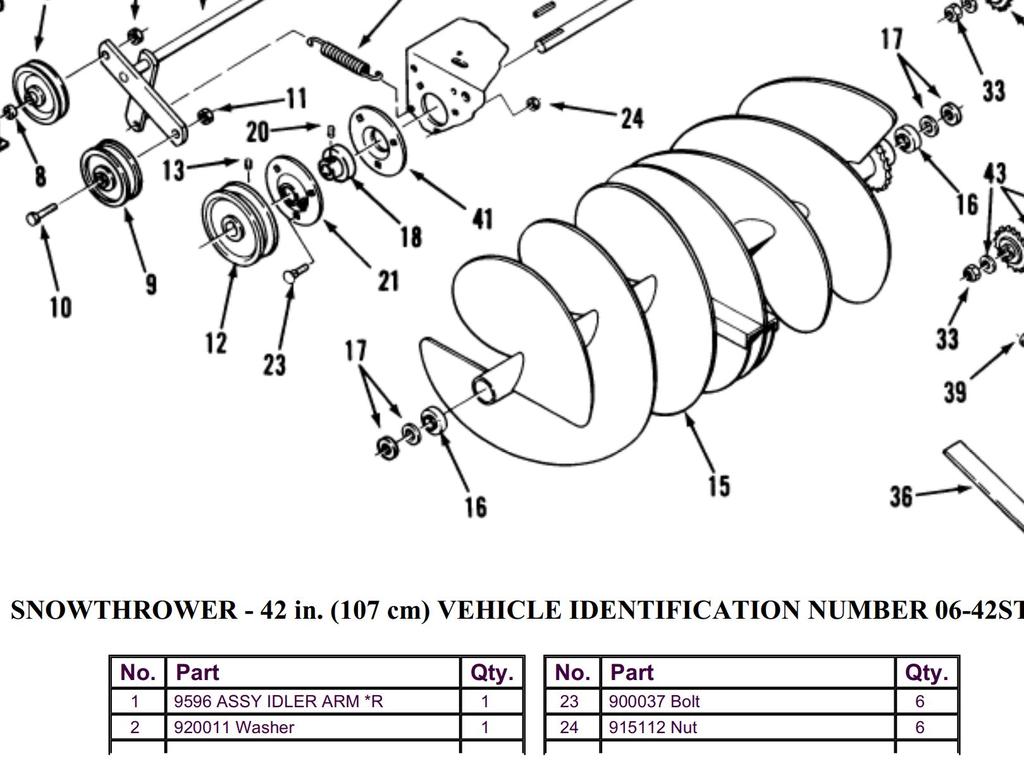

Bow_Extreme 583 #1 Posted November 30, 2018 I have an old 42" Snowblower that I'm piecing back together. I have a question. There should be two washers on each side of the auger bearing surfaces, These washers are depicted as #17 on the schematic snapshot attached to this posting. I figure the ID should be .750"+ but not sure on OD or thickness. Does anyone know what these dimensions might be? Thanks for the help!! Share this post Link to post Share on other sites
gwest_ca-(File Mod) 12,456 #2 Posted November 30, 2018 920015 - 3/4" SAE flat washer replaced by 3256-28 (.8125" ID x 1.46875" OD or 13/16" ID x 1-15/32" OD) These are the same as the washers used on the flag and tube to adjust snowthrower lift height. Each washer changes the height about 1/2". Thickness depends on the manufacturer but usually about 1/8" thick. The more common USS flat washers have a larger center hole and are larger on the OD. Garry 1 Share this post Link to post Share on other sites
