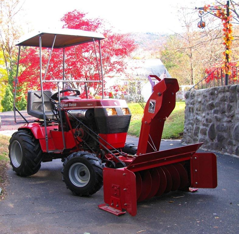

formariz 12,353 #1 Posted November 29, 2018 (edited) Just installed the two stage blower on my 520H for the first time today. This thing is absolutely impressive to say the least. Next will be the cab. The chute deflector on top to control distance however is manual. Cannot be adjusted without stepping off tractor, which I see will be a major inconvenience. Any ideas out here for an improvement on it so it can be adjusted from cab? Perhaps reference to previously posted topics on this? Been searching but have not come across any. Edited November 29, 2018 by formariz Share this post Link to post Share on other sites

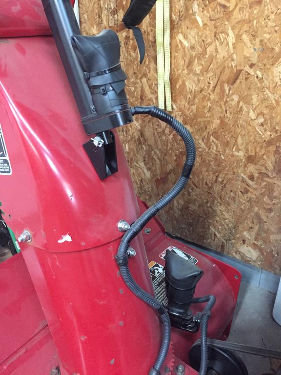

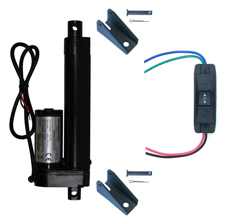

wallfish 18,818 #3 Posted November 29, 2018 I attached a small actuator to move it. Also used a motor for rotating it as well. Think mine is a 4" stroke and have it mounted on the side, but if you mount it on tiop in the middle I believe it may take a 6" stroke. Then I use momentary switches 2 Share this post Link to post Share on other sites
wallfish 18,818 #4 Posted November 29, 2018 pics. Used a power window motor for the rotation. It's covered with a piece of rubber to keep the ice out. You can find a thread Duke did a while back. "snow chucker" 4 Share this post Link to post Share on other sites

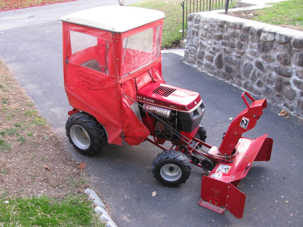

AMC RULES 37,251 #8 Posted December 2, 2018 Maybe, just need to extend the chute deflector rod into the cab. 1 Share this post Link to post Share on other sites
formariz 12,353 #9 Posted December 2, 2018 3 hours ago, AMC RULES said: Maybe, just need to extend the chute deflector rod into the cab. Great photos again. Could you post closeup photos of the attachment points of the frame on that cab? I have one to install for the first time. Really appreciate it. Share this post Link to post Share on other sites
formariz 12,353 #10 Posted December 4, 2018 On 11/29/2018 at 6:20 PM, wallfish said: I attached a small actuator to move it. Also used a motor for rotating it as well. Think mine is a 4" stroke and have it mounted on the side, but if you mount it on tiop in the middle I believe it may take a 6" stroke. Then I use momentary switches .John could you take your boot off and show me how you have that motor mounted? I decided that your setup is the best way to go. I already ordered a linear actuator for the top. Share this post Link to post Share on other sites

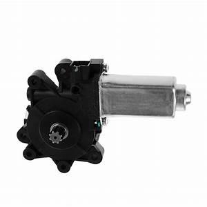

wallfish 18,818 #11 Posted December 4, 2018 It's a power window motor attached to the chute worm gear with a piece of copper pipe. I can't remember exactly what the window motor was for but look before you buy as most have a gear that rotates on a stationary pin. You can't remove the gear and have a rotating shaft. Mine does have a rotating shaft so I just drilled a hole through it for a pin. The holes in the copper pipe were drilled 90 degress of each other so it acts like a U-joint. If that link from the motor to the chute gear is tight, it will need to be aligned perfectly so it doesn't bind. The best one was a thread by @Wheelbearing which I can't find. He used a motor and a chain to rotate the chute. If you can grind more teeth into the chute base, a bicycle chain fits right into the teeth which are already there and use a #35 sprocket attached to a motor. Only need to grind in half of the teeth. Share this post Link to post Share on other sites

dclarke 4,113 #18 Posted December 4, 2018 2 minutes ago, formariz said: @dclarke Any concerns or issues ever from moisture or rain on either motor? I cut an old inner tube and zip tied it over each motor to help with moisture but we haven’t had enough snow to use the blower since I installed the motors. 2 Share this post Link to post Share on other sites
