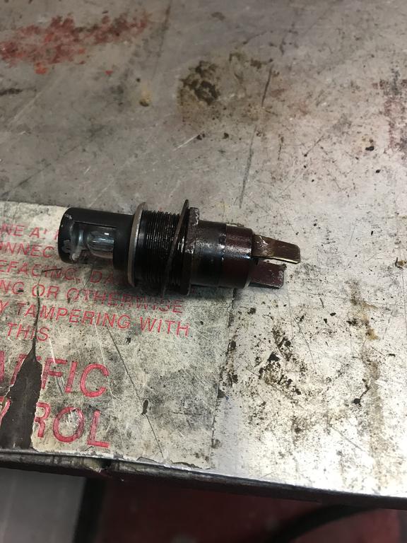

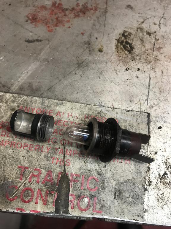

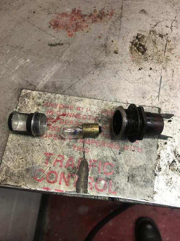

Sarge 3,473 #4 Posted December 1, 2018 Got a pic? Is it just rusted that badly or not getting a ground through the panel? Sarge Share this post Link to post Share on other sites
Firebug 267 #5 Posted December 1, 2018 Here’s pics of it. I just had the tractor reworked, the shop said there was no power going through it Share this post Link to post Share on other sites

Sarge 3,473 #7 Posted December 2, 2018 You'll have to look inside at the contacts - many of this type of socket was riveted between the contact and the spade connector for the wiring. A simple pick to remove corrosion and a light punching on those rivets will generally restore the contacts. I fix a lot of these types of sockets for auto restoration here, most aren't all that hard and the originals are far better quality materials than aftermarket knockoff replacements. If you want - mail/ship it here, I'll fix it or determine if it's truly junk and send it back - no charge either way. Sarge Share this post Link to post Share on other sites
