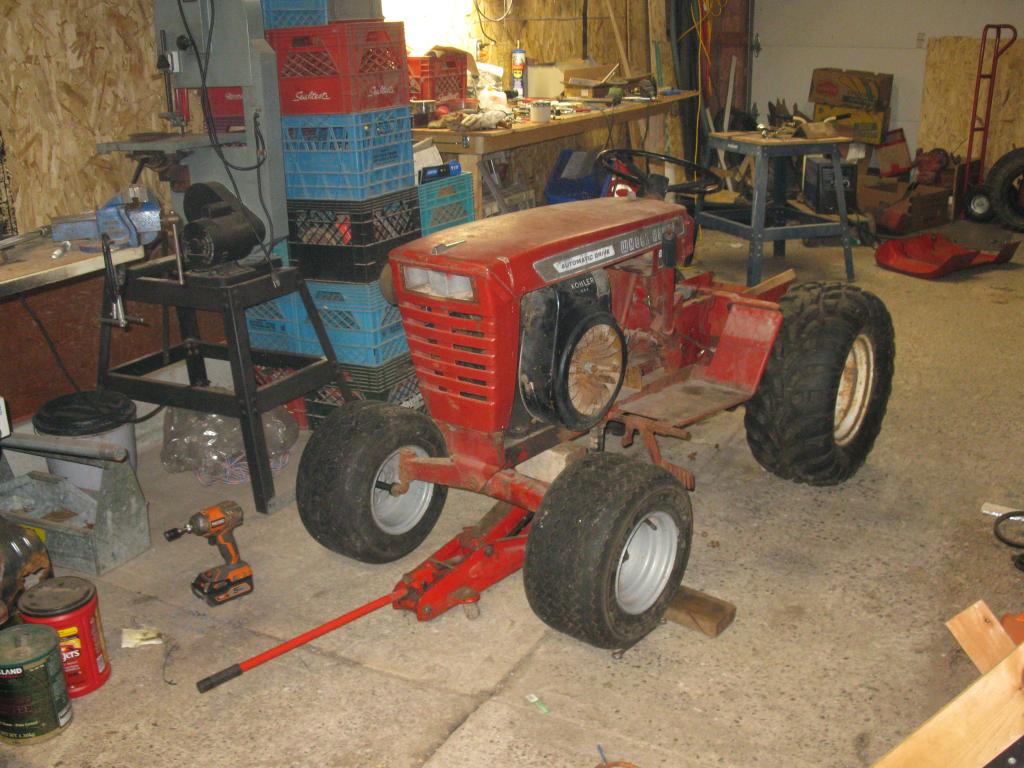

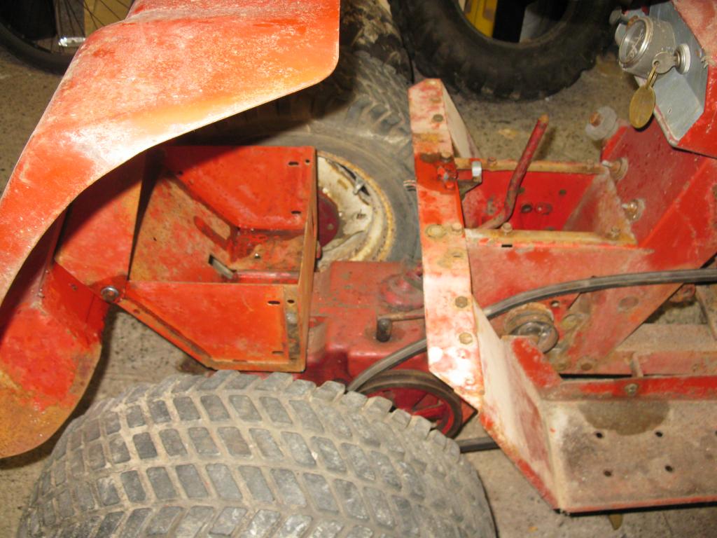

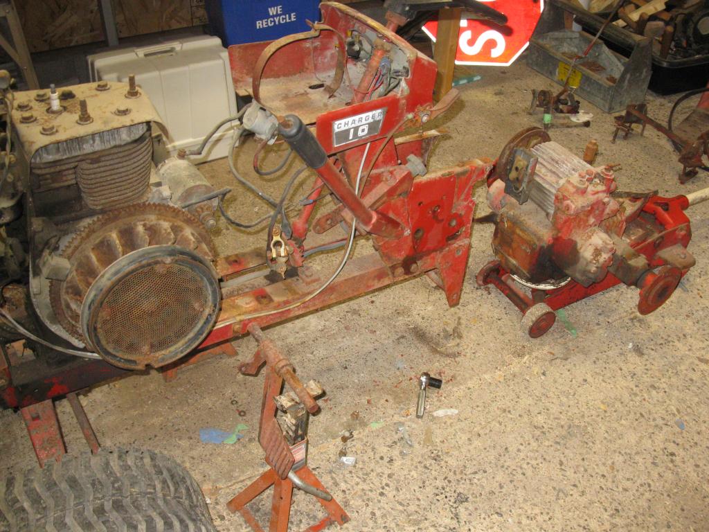

MikMacMike 494 #17 Posted December 2, 2019 Its a 69 to 70 something charger 10, the engines was a tecumse but now its the 12 hp Kohler K-301 I think??? I just baught a 8 speed and just finished fitting it in about 2 weeks ago. Right now Ive been tacking up a rear frame setup so as to move the gas tank and increase its size to I figured with the cubic inches in the cavity Ill have almost 6 gallons for fuel, it'll be a custom tank obviousely.....hopefully I can fab a good stainless steel one eventually.Here are a few pics of where Im at on it. 1 1 Share this post Link to post Share on other sites
MikMacMike 494 #18 Posted December 2, 2019 Here is where I left off at 9:30 tonight. Oh darn I cant load any more.....was going to show where Im at now. 14 hours ago, ebinmaine said: Your S/G belt shroud should have a hole in the large end. That's the air intake. We're curious to see what you have... Share this post Link to post Share on other sites
ebinmaine 79,513 #19 Posted December 2, 2019 Looks like quite an awesome build Mike. When you get to load more I'll be looking forward to it... If you only have the one pedal that does both brake and clutch your linkage can be a bit challenging to get lined up just right. That setup was originally on a 6 speed which is basically the same transmission but the brake drum is in a slightly different location. It CAN be done. I've done it on a 1267. I stopped that project because I like the C series with 2 brake pedals. If you become a supporter you'll have unlimited photo capability and no outside ads. Great job so far!! 1 1 Share this post Link to post Share on other sites
953 nut 67,240 #20 Posted December 2, 2019 7 hours ago, MikMacMike said: 69 to 70 something charger 10, the engines was a tecumse but now its the 12 hp Kohler K-301 I think??? Was this engine a running engine that you have the rest of the ignition parts for? It appears to be a trigger ignition system which is a great setup if you have all the parts. I went back to the first post on this thread and saw that you have hijacked the original post. That can confuse things a bit because I was under the impression that you were working on a 854 with a S/G. Why don't you start a new topic where you are talking about your tractor and your situation only? Share this post Link to post Share on other sites
