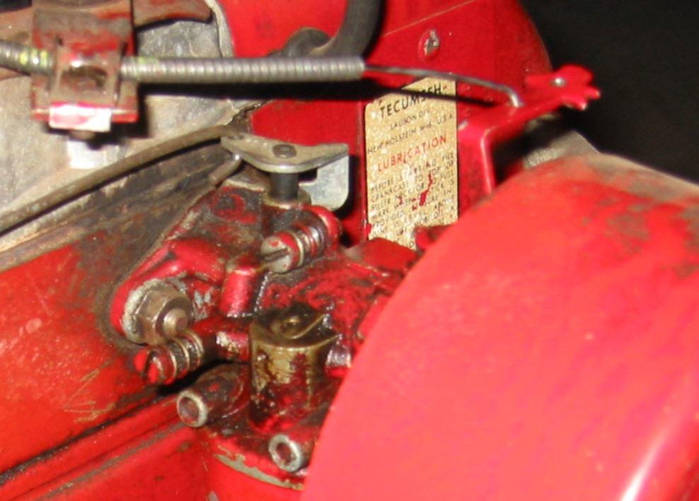

pfrederi 20,895 #13 Posted December 1, 2018 I would get a new carb. Many Techy Walbro LME carbs have very little casting around the throttle shaft. not enough "meat" to drill out and put in bushing like the Kohler Carbs.... This is the carb on an HH100 1 Share this post Link to post Share on other sites
McGrew 461 #14 Posted December 2, 2018 Thanks for the information. The carb on my HH140 looks similar to yours. I will replace rather than repair. Do you have any suggestions on which carb to use? Most of the ones I found on EBay are for a 10 horse engine, although I am sure I can make it work on my 14. Thanks! Danny Share this post Link to post Share on other sites
