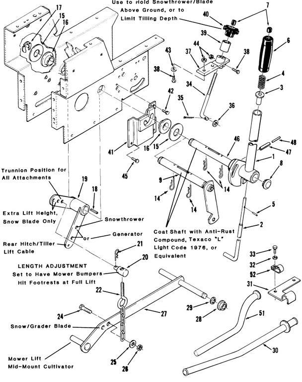

C160 7 #4 Posted November 23, 2018 Good info thanks,. I may need to take photo of the linkage to raise and lower the mower deck using hydraulics. I currently have the tractor in pieces (under going a restoration) but i can take photo of linkages. Something must be missing because i could never use the hydraulic lift lever. The cylinder moves ok but the linkage isn't right. Share this post Link to post Share on other sites
953 nut 64,139 #5 Posted November 23, 2018 This exploded parts diagram may be helpful. It is for a manual lift, but the other parts ate all the same. 5 Share this post Link to post Share on other sites
