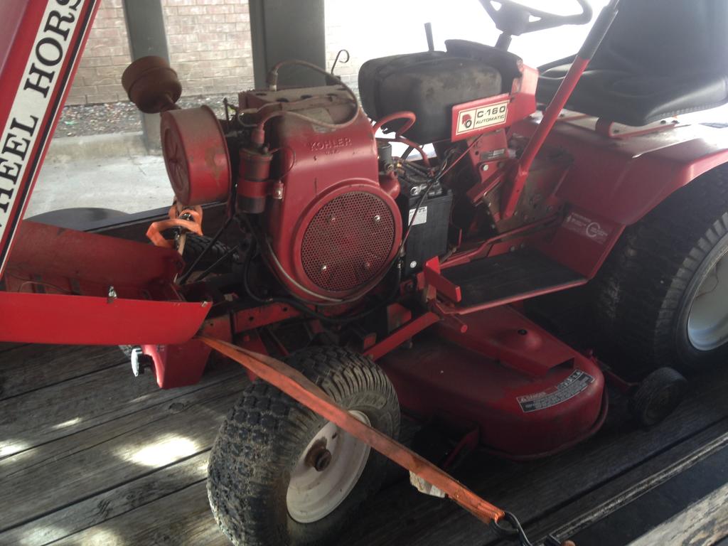

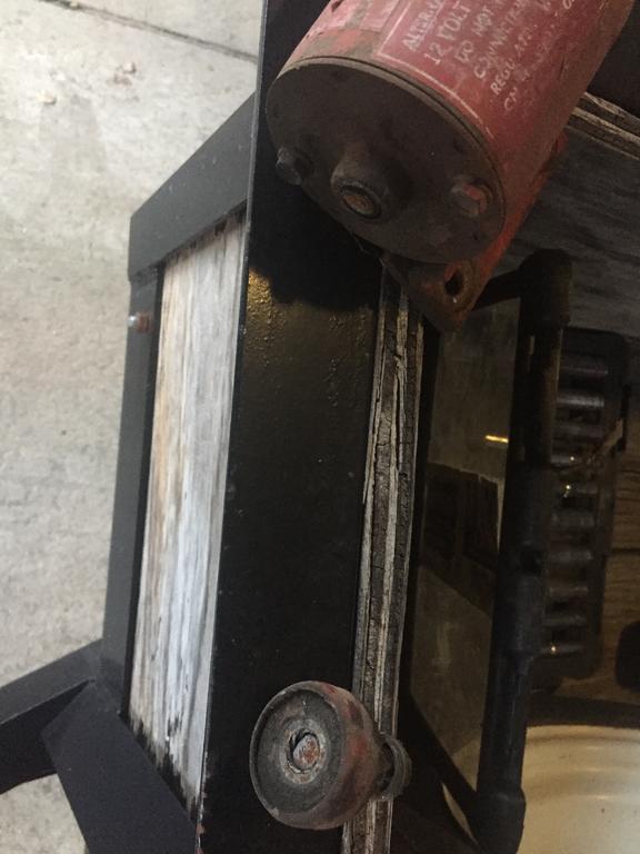

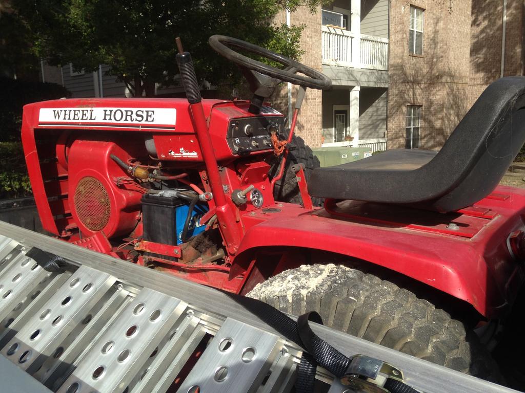

ZXT 2,402 #1 Posted November 22, 2018 (edited) Well... I've been scrolling past these two wheel horses for a few weeks. One of the tractors is a C160, the other a C120. Both hydros. They'd been posted for 6 months, so I figured they were gone, but I inquired anyways. $600 for the C160, $500 for the C120. That was more than I figured they were worth, so I forgot about them. Checked back a few days ago, and they'd dropped the price of the C160 to $300 and the C120 for $225. After messing with my GT-14, a friend of mine became interested in WH's. He decided he wanted the C160, so I figured I'd buy the C120. Both are supposed to be good running tractors, and they have new Exide "classic" automotive batteries on them (Which are about $100 a piece). The C160 needs a starter; the shaft snapped as can be seen in the picture. The handle to engage/disengage the hydro is also broken. The C120 unfortunately has a Tecumseh, but is supposed to run good. I can always put a Kohler on it if I have issues. I believe both have 42" decks that appear to be in amazing shape. One deck has Toro on it, so I know it's newer. As an unexpected, but welcomed bonus with the tractors was an extra attach-a-matic with mule drive, which will go on my GT-14 for when I find a deck. They were about 2 hours from my house, but about 15 miles from my moms place, which I was going to anyways for thanksgiving. They're sitting outside but I won't have a chance to mess with them much until I go home on Friday. How do y'all think I did? I haven't found a mower deck, let alone a complete tractor for $200, so I don't think I got hurt too bad. Edited November 22, 2018 by ZXT 9 6 Share this post Link to post Share on other sites
Razorback 1,370 #2 Posted November 22, 2018 They definitely look better on your trailer and in the bed of your truck! I think you made a great deal! 1 Share this post Link to post Share on other sites
ebinmaine 80,600 #4 Posted November 22, 2018 6 hours ago, Razorback said: They definitely look better on your trailer and in the bed of your truck! I think you made a great deal! Agreed The way I look at it is if the separated parts are worth what I paid for the whole then I'll be ok. You nearly bought 2 mowers and got 2 free Tractors at that price. Well done. 3 Share this post Link to post Share on other sites
rjg854 13,341 #5 Posted November 22, 2018 From the pictures they look like fine tractors, I paid more for my 16 Auto than you did for both tractors, As long as you can get them both running I think you made a good deal. 1 Share this post Link to post Share on other sites
953 nut 69,127 #6 Posted November 22, 2018 Sounds like you and your friend did very well! 1 Share this post Link to post Share on other sites
ZXT 2,402 #7 Posted November 22, 2018 Thanks guys! I sent a few pictures to my buddy and he seems pleased with the c160. I have noticed a few things on the c120. It has an electric PTO switch, but a manual PTO. Also has a push button for the starter in addition to the factory ignition switch, but it works. I've read up some and people seem to say that the Tecumseh's are OK. Its too bad that you cant use a vertical shaft Kohler in a horizontal application, because I think I have a few of those around.. Here's the picture of the starter that I forgot to include last night. Share this post Link to post Share on other sites
