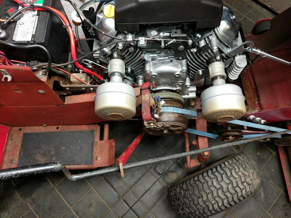

SamH 37 #12 Posted November 24, 2018 This is what I decided to go with for electric pto: http://a.co/d/7exnOnr and drive pulley: https://phoenix-mfg.com/HustlerBigDog-602842-V-Groove-Drive-Pulley--5-Dia--1-Bore--Steel_p_1388.html#.W_ialwzHfW0.link. Pretty close to original size, and with the predator's higher max rpm i figure it should keep performance pretty consistent. I've got the motor mounts welded on and engine clamped relatively in place and hooked it up just to see how it ran, was difficult to get to start initially, had to find a new hose clamp for my fuel line and cut the end back cuz it was sucking air. After that, fired up ok but has been surging pretty good, seems to be smoothing out and i imagine once i get through the break-in period it'll be a non issue. overall sounds pretty nice. Will need to run a new fuel line to be able to route properly. Once I get the drive pulley in I'll get motor aligned and drill my bolt holes. Haven't decided yet if I'll do through bolts or run a tap, and not sure on if I'll do any anti vibration, it runs pretty smooth. Pics are on the cell, I'll get em uploaded at some point. overall it's gonna be a pretty easy swap it seems. with the coupon they used at the store I got the motor for 620, and bought the 2 yr replacement plan as well. Big thanks to my old man for financing a good portion of the project, he's just about as excited as I am I think. 2 Share this post Link to post Share on other sites
SamH 37 #14 Posted November 25, 2018 Here's what I decided to do for the hood in order to clear the muffler. Plan will be to eventually have a local shop fab up what's missing, but thinking about leaving a cutout to be able to run a straight pipe up to turn the exhaust. I'll just turn it out for now. The way the muffler is turned up doesn't allow me to just rotate it, no clearance. I think it'll look pretty good eventually. 1 2 1 Share this post Link to post Share on other sites
WildmanC120 615 #15 Posted November 25, 2018 I just did this swap on a c-161 that had the twin Briggs on it. Wish I saw this thread earlier I could have saved you not cutting up your hood etc. Best thing to do is get the $24 adapter to run 1-1/8th in drive pulley and get another real WH one. That will also make it easy to just get a WH electric clutch. As for exhaust you could have just removed that big muffler and there is a guy on eBay that sells new flanges with pipe thread on them so you can just make new exhaust with 1" pipe. The adapters would be $50 for the pair. 1 Share this post Link to post Share on other sites
WildmanC120 615 #16 Posted November 25, 2018 Another thing to note. Keeping that stock muffler if you use a snowsnower will interfear with the lever to adjust the chute. 2 Share this post Link to post Share on other sites
WildmanC120 615 #17 Posted November 25, 2018 Another thing to note. Keeping that stock muffler if you use a snowsnower will interfear with the lever to adjust the chute. Share this post Link to post Share on other sites
