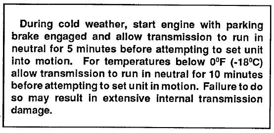

gwest_ca-(File Mod) 12,276 #9 Posted November 19, 2018 From the 1990 520-H operator manual Garry 2 3 Share this post Link to post Share on other sites
pfrederi 20,671 #10 Posted November 19, 2018 Trade it in on a unit with a Sundstrand Their lifts work immediately no matter what the weather. Seriously, I retired the 418A from winter duty got tried of her filling the shop with exhaust fumes waiting for her to decide to lift the blower so I could move her outside. The Charger/electros pick it up immediately so i can pull the out side to warm up. 1 1 1 Share this post Link to post Share on other sites
Ed Kennell 46,203 #11 Posted November 19, 2018 1 hour ago, gwest_ca said: From the 1990 520-H operator manual Garry Thanks Garry, I knew I read this somewhere. 1 1 Share this post Link to post Share on other sites
