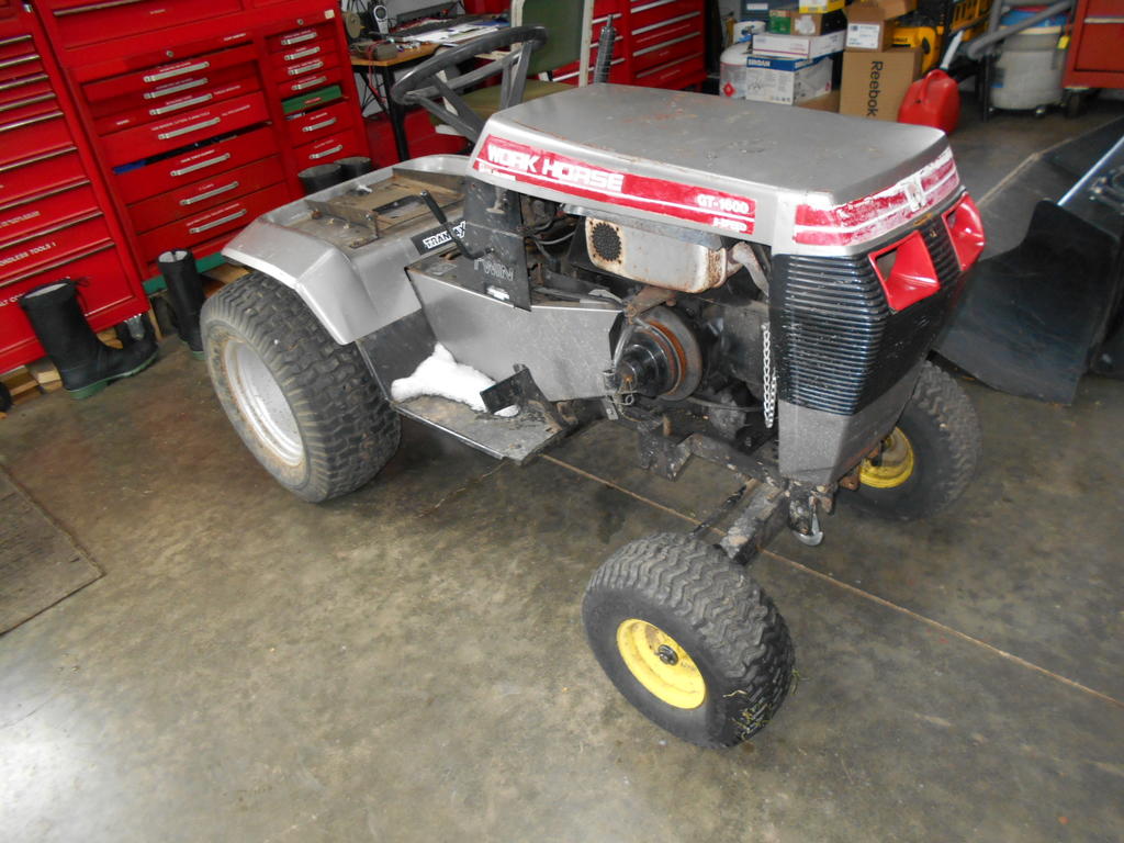

cleat 8,735 #1 Posted November 18, 2018 (edited) A Work Horse GT-1600 went up for sale this morning a few miles down the road so I went and dragged it home. Transmission is stuck in reverse (frozen I bet). Supposedly engine runs fine but I have not started it yet. It is in the Shop warming up. I paid $150.00 CDN for it. Don't know yet if that was a good deal or not. Cleat Edited November 18, 2018 by cleat 7 3 Share this post Link to post Share on other sites

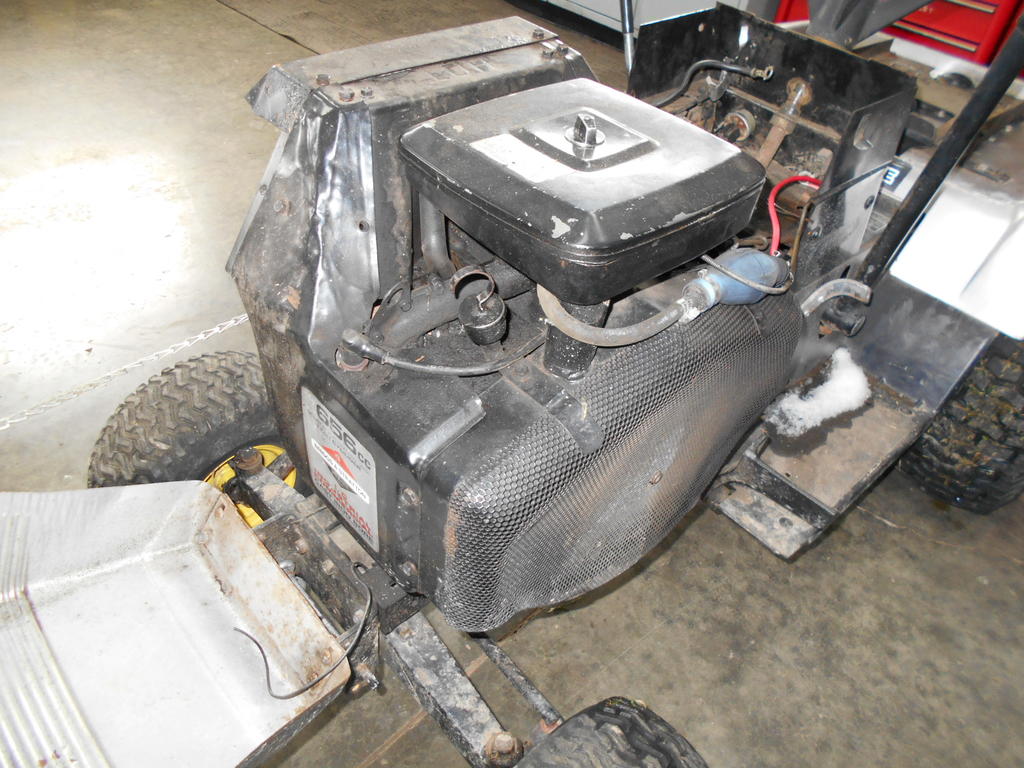

Sparky-(Admin) 24,633 #2 Posted November 18, 2018 So that's about $115 American money....if in fact it runs as you were told that's not a bad deal. Is that a squeeze bulb I see in the fuel line? I have the same tractor with a Kohler Magnum 10 under the hood. Share this post Link to post Share on other sites
KC9KAS 4,746 #3 Posted November 18, 2018 @cleat That should turn out to be a good deal! Share this post Link to post Share on other sites
WHNJ701 4,169 #4 Posted November 18, 2018 is that duct tape holding the lights in? Share this post Link to post Share on other sites

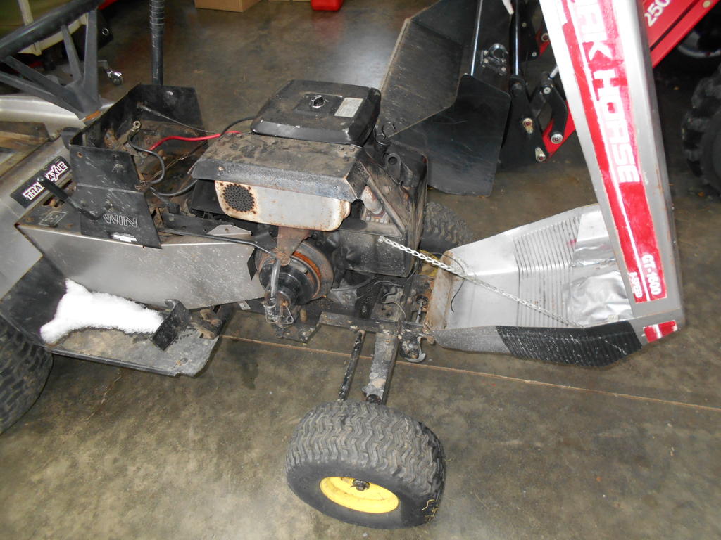

Ed Kennell 44,904 #5 Posted November 18, 2018 Careful Cleat.....when it fires up, don't let the PTO yank the hood support chain. Good deal, she could turn out to be a real stallion. Share this post Link to post Share on other sites

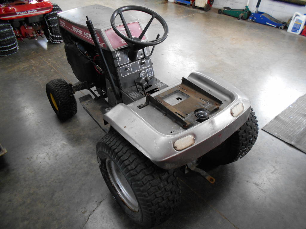

cleat 8,735 #6 Posted November 18, 2018 No lights, I will need to fix that later. Share this post Link to post Share on other sites

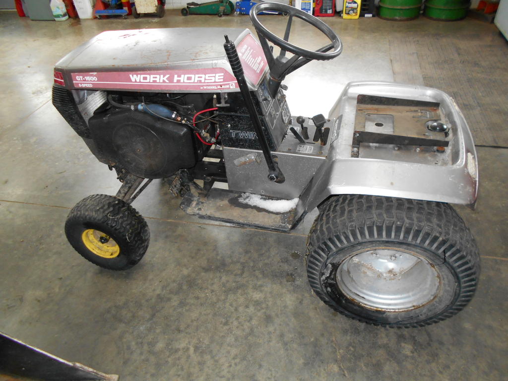

cleat 8,735 #10 Posted November 21, 2018 Well, the transmission thawed out and tractor would then roll but shifter was loose and floppy. I believe he really forced it when transmission was frozen. Pulled shifter out and the collar on it just fell off. Roll pin was broken. Replaced roll pin then installed shifter and set the dog point set screw and it now runs through the gears perfectly. Oil is a milky sludge so I will be cleaning that up. I have two 5 gallon pails of furnace oil (same as diesel) that was left over when I pulled my oil furnaces. I might flush the transmission with some of that if it will work. Engine has not been started yet because fuel line is leaking and hard so I will replace that first. I believe that is why he installed the primer bulb. I will not re-install that unless it is necessary. Also the shifter boot is completely missing so that will get replaced as well. This is my first 8 speed Wheel Horse so I am on a bit of a learning curve. Cleat 2 Share this post Link to post Share on other sites
c-series don 11,383 #11 Posted November 21, 2018 Quite obviously this tractor is in good hands. Keep us posted on the progress Cleat!! 1 Share this post Link to post Share on other sites

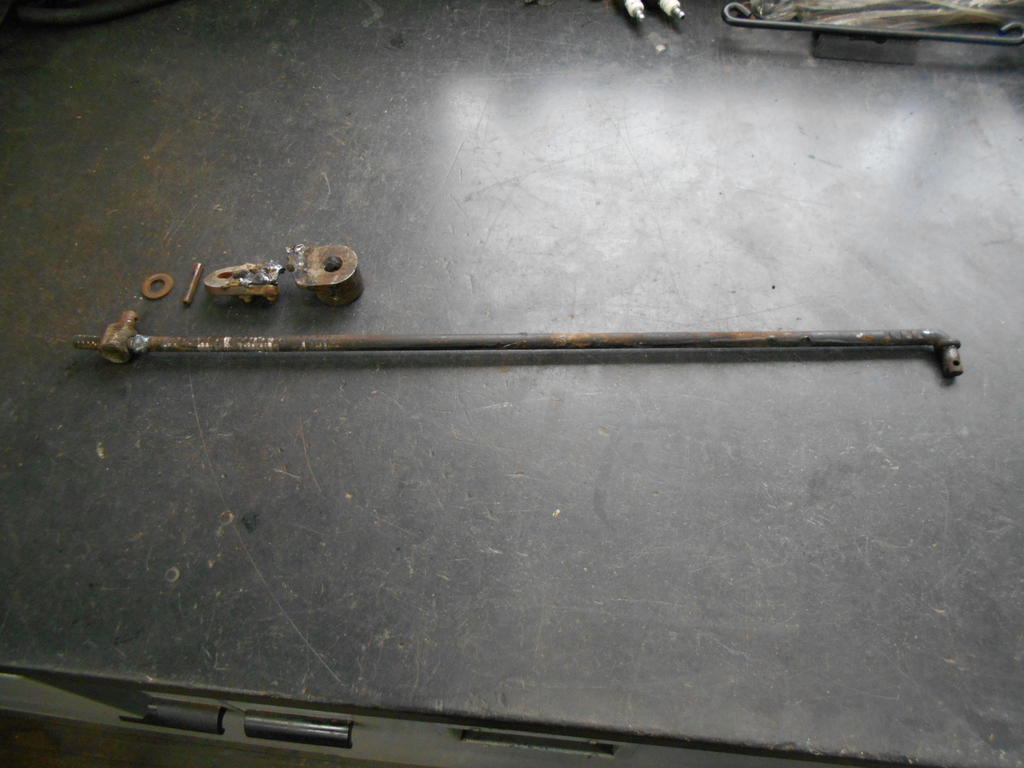

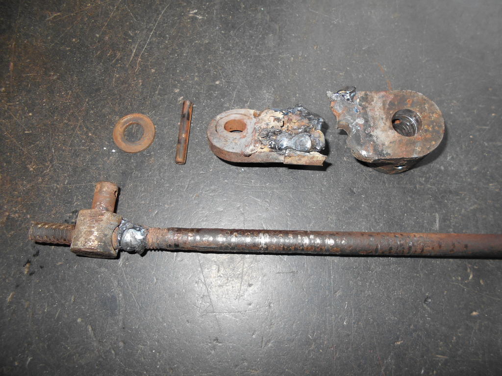

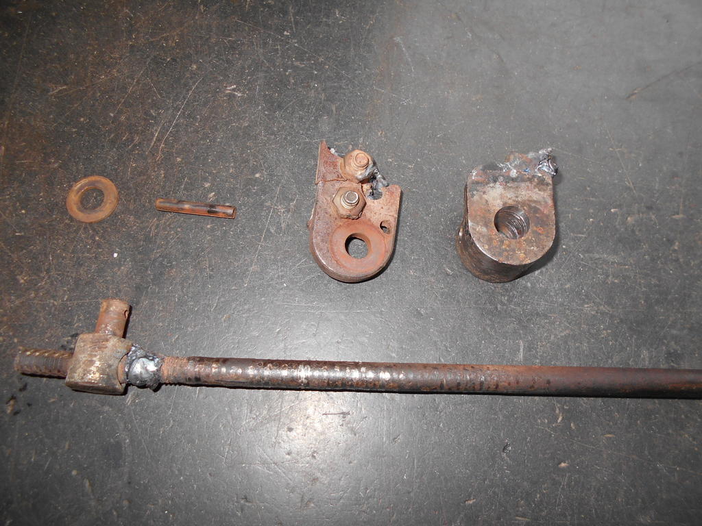

cleat 8,735 #12 Posted November 23, 2018 Well, the engine started easily with a new fuel line. Mice have chewed a spark plug wire badly so I will order a new coil soon. All rubber hoses to air cleaner are bad So I will replace those. Wiring was a nightmare so I pulled the harness and cleaned it up. Transmission was drained (mix of water and brown goo) with front end jacked as high as I could. Then I put in 2 liters of furnace oil and ran with the rear end jacked up through all gears. Transmission was drained with front end jacked as high as I could. Transmission was then filled with 80W90 gear oil. Main drive belt is badly cracked and loose so I pulled it and will get a new one soon. I eliminated the ammeter and installed a volt meter instead. Reads 12V with key on engine off and 14V with engine running so charge cct is good. 4 3 2 Share this post Link to post Share on other sites
cleat 8,735 #13 Posted November 25, 2018 (edited) The main drive belt was loose because the clutch rod and clutch arm have been badly repaired. Clutch arm fell apart when I removed the roll pin holding it to the shaft. I have found and purchased replacements from ebay. New belt is installed. Turns out a 5L850 (B82) is the correct length. I tried a 5L840 and it would not release enough to stop belt from driving even with idler fully down. Cleat Edited November 25, 2018 by cleat 1 Share this post Link to post Share on other sites
