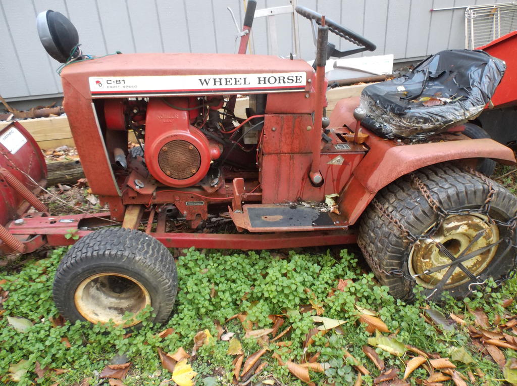

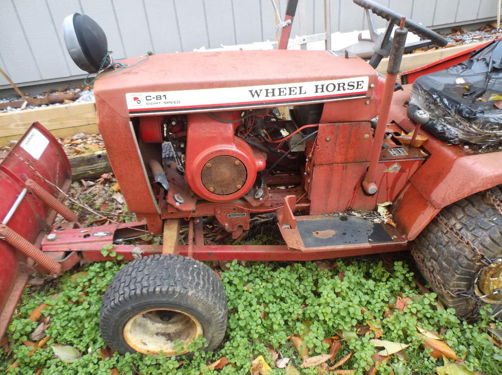

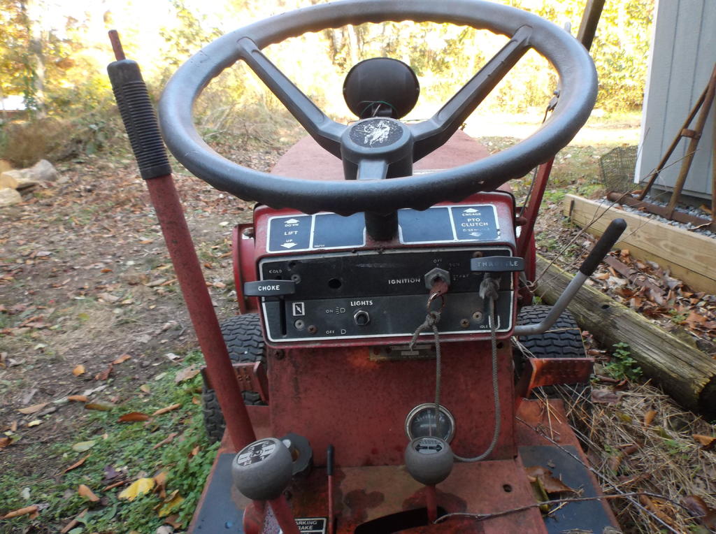

PA.BOB 68 #1 Posted November 18, 2018 Hi everyone just want to introduce myself. I hope this is the right place to post this. My name is Bob Demko. I'm from Honey Brook Pa. I been fooling with cars since I was about 8 years old. I was a auto mechanic for 27 years. I'm now 62. I always wanted to get involved with garden tractor restoration. And or pullers. I really think that the Wheel Horse tractor is the nicest looking and the best built garden tractor there is. I Don't know to much about these. But I am learning a lot just buy looking over this great forum. I hope that you guys wont mind to help this old bird out. Because I know that I will have a lot of questions to be asked. And I do really appreciate it. My friend at work has a 1978 -1979 C-81 with front plow. With 8 speed. And 8 horse Kohler. Its been sitting behind his shed for about a year or so. He said it ran when he parked it there. It looks like CRAP now. It hasn't been running for a while. But I would do a full restoration on it. I would want to put Carlisle Agg tires on rear and 3 rib on front. He said give him $150.00 for it. Do you think I could find a dash panel for it ? Looks like somebody drilled a hole in it. Plus I need a seat ! I think it still has the original tires on it. There flat in the back. I guess take the tank off and clean it out first. Would you guys take the exhaust and muffler off to see if there's any mice nest in there? Let me know guys what you think. And what you would do. Would it be a good one to restore ? Any help would be appreciated. He used that to plow his driveway. Until he bought a 4x4 ATV. I will try to post some pictures if I know how. I am not to good with the computer. 5 8 1 Share this post Link to post Share on other sites
Sparky-(Admin) 26,488 #3 Posted November 18, 2018 If the motor will spin and has compression it’s worth the $150 in my opinion. The steering wheel is not correct if a full restoration was planned. 1 Share this post Link to post Share on other sites

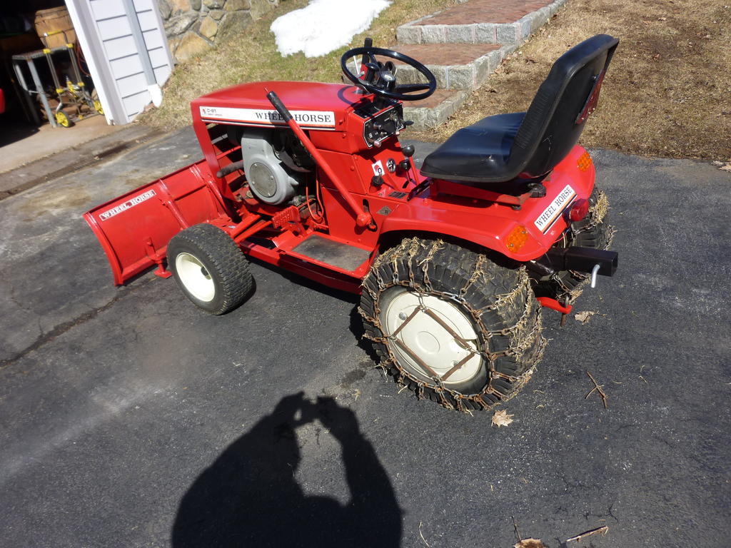

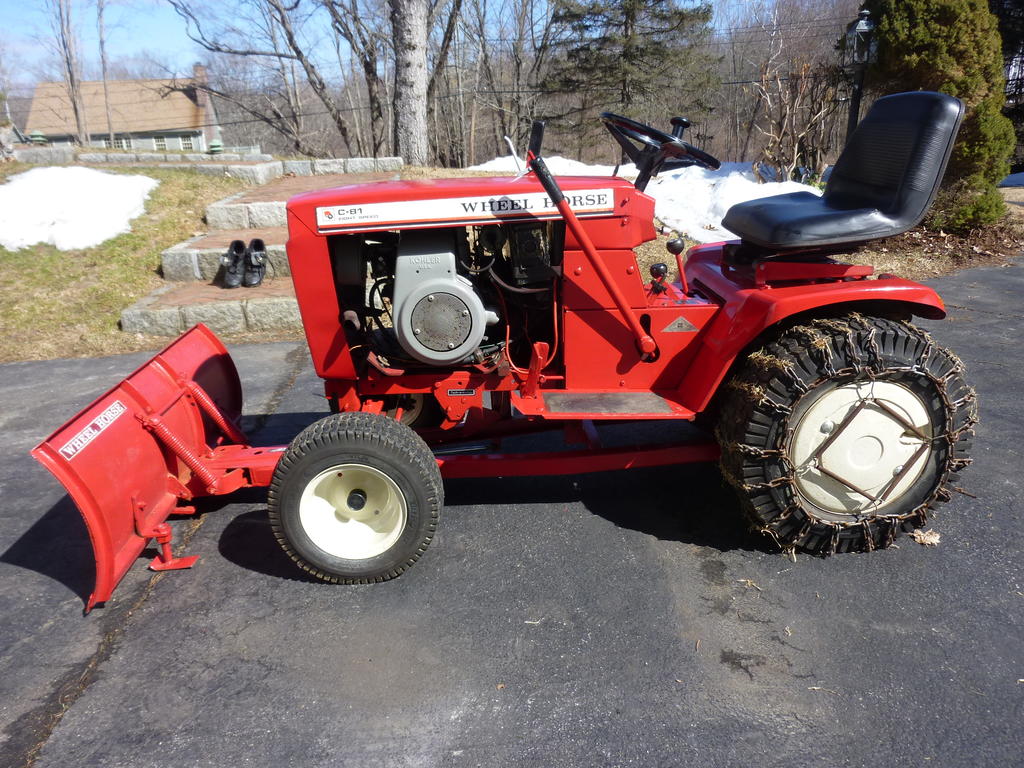

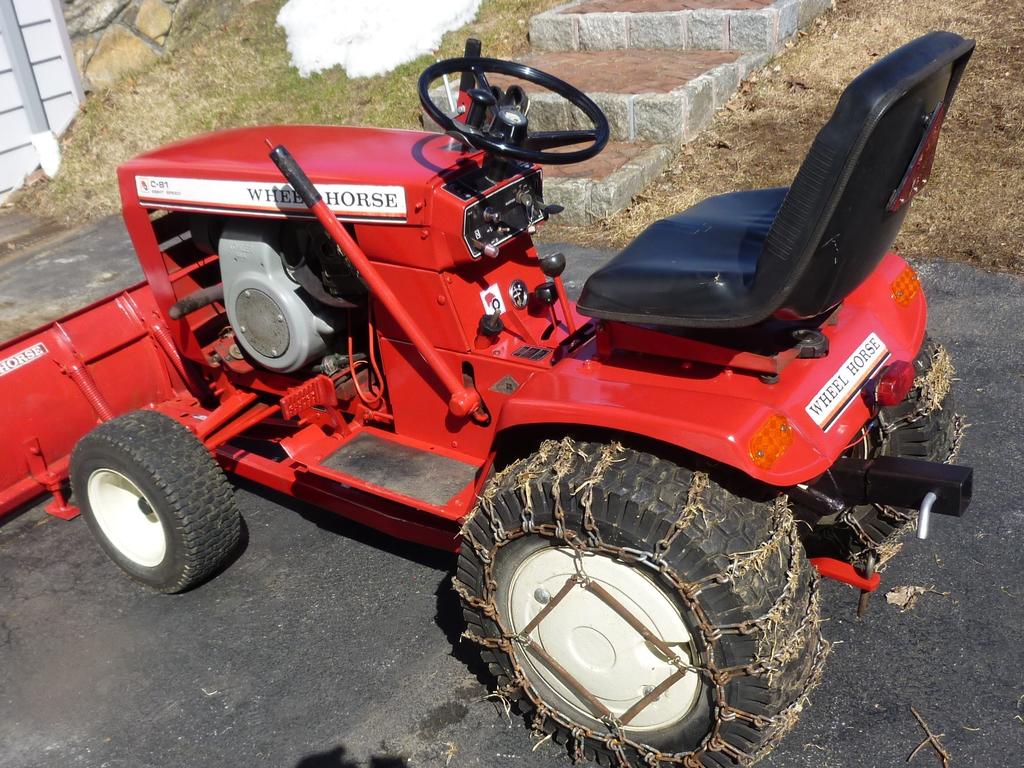

Rob R 989 #5 Posted November 18, 2018 I would say definitely pull the trigger if the engine is good, you get it running and chk the condition of the tranny fluid and you will have a hell of a machine. I have the identical tractor and it the best plow tractor I have ever owned.... easy to maneuver, easy to get started in sub zero and absolutely sips gas. 6 1 1 Share this post Link to post Share on other sites

953 nut 69,744 #9 Posted November 18, 2018 3 hours ago, PA.BOB said: I Don't know to much about these. But I am learning a lot just buy looking over this great forum. I hope that you guys wont mind to help this old bird out. We all learn from each other and there is a lot of information on this site for you. Looks like a good solid and well worth restoring. I would suggest you pull the sheet metal covers of the engine to check for mouse nests. Feel free to ask questions if there are things you don't figure out on your own. As you begin to take the tractor apart be sure to take pictures of everything, they will come in handy as it goes back together. The C-81 was built from '78 to '81, not sure what year yours is but have attached the '79 "C Series" manual. 3 Share this post Link to post Share on other sites
PA.BOB 68 #10 Posted November 18, 2018 3 hours ago, Rob R said: I would say definitely pull the trigger if the engine is good, you get it running and chk the condition of the tranny fluid and you will have a hell of a machine. I have the identical tractor and it the best plow tractor I have ever owned.... easy to maneuver, easy to get started in sub zero and absolutely sips gas. That's a nice one you got there Rob. Did you restore it? I see that you have a cig lighter. Maybe that's what that hole is for in my dash. I thought somebody drilled a hole for something. And Sparky said my steering wheel is wrong . I didn't know that . I appreciate you guys telling me all this stuff. Thank you guys. Bob.. 3 Share this post Link to post Share on other sites

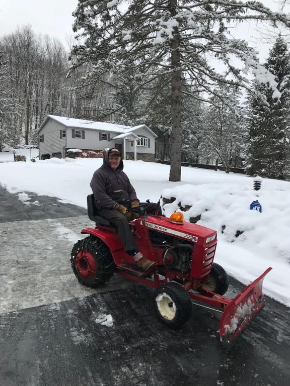

Rob R 989 #13 Posted November 18, 2018 (edited) 1 hour ago, PA.BOB said: That's a nice one you got there Rob. Did you restore it? I see that you have a cig lighter. Maybe that's what that hole is for in my dash. I thought somebody drilled a hole for something. And Sparky said my steering wheel is wrong . I didn't know that . I appreciate you guys telling me all this stuff. Thank you guys. Bob.. I added he cigarette Lighter outlet so that I can run a magnetic revolving yellow warning blinker since I live on a curve and the cars come around it WAY to fast for my liking! Has saved my keester more then once in the past 5 yrs.....! p.s. I got this ole girl after the original owner went to his reward. Restored it to good working order and gave her a fresh coat of paint.... p.s. don't forget to chk the transmission if the oil it is brown you need to flush it with kerosene and replace once or twice if it is black fill to proper level and leave it alone..... also change the shift boot if oil is brown.... leakage here is where the H2O gets in.. Welcome Bob Edited November 18, 2018 by Rob R 5 Share this post Link to post Share on other sites
Ed Kennell 47,558 #14 Posted November 18, 2018 to the Bob. Great intro and pictures.... BUY IT, in my area plows sell for 150 bucks. You get a free tractor. As stated above, the 8HP Kohler is a great easy starting engine. I am not a fan of the rocker plate engine mounts, but that is a fine tractor. 2 Share this post Link to post Share on other sites

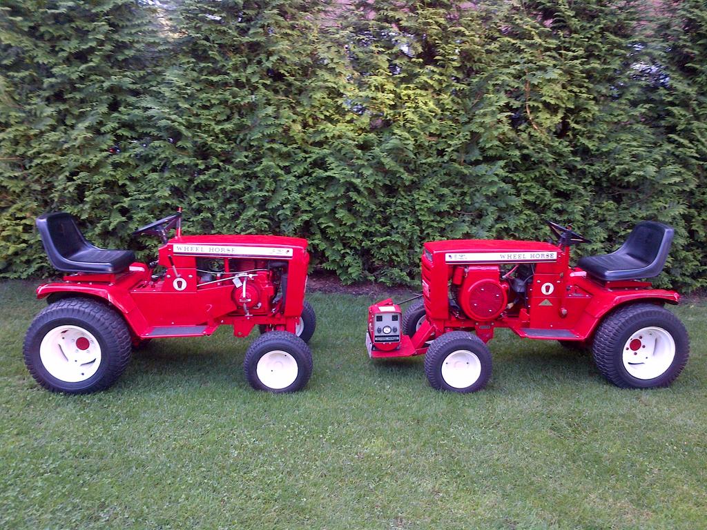

c-series don 12,515 #15 Posted November 18, 2018 The 78-79 C-series are my favorite. I have all of them except a C-81 which I know where there is one that I may be able to buy soon and a C-101. Really love the looks of them. Here's two of them that I restored. 5 Share this post Link to post Share on other sites

PA.BOB 68 #17 Posted November 19, 2018 4 hours ago, Rob R said: I added he cigarette Lighter outlet so that I can run a magnetic revolving yellow warning blinker since I live on a curve and the cars come around it WAY to fast for my liking! Has saved my keester more then once in the past 5 yrs.....! p.s. I got this ole girl after the original owner went to his reward. Restored it to good working order and gave her a fresh coat of paint.... p.s. don't forget to chk the transmission if the oil it is brown you need to flush it with kerosene and replace once or twice if it is black fill to proper level and leave it alone..... also change the shift boot if oil is brown.... leakage here is where the H2O gets in.. Welcome Bob Looks like it does a nice job plowing Bob. I see your light your talking about. Looking good Bob. Share this post Link to post Share on other sites
PA.BOB 68 #18 Posted November 19, 2018 2 hours ago, c-series don said: The 78-79 C-series are my favorite. I have all of them except a C-81 which I know where there is one that I may be able to buy soon and a C-101. Really love the looks of them. Here's two of them that I restored. There beautiful Don. Holly Molly. You did an A1 job on them. There show winners. Thanks for posting them. Bob.... 1 Share this post Link to post Share on other sites

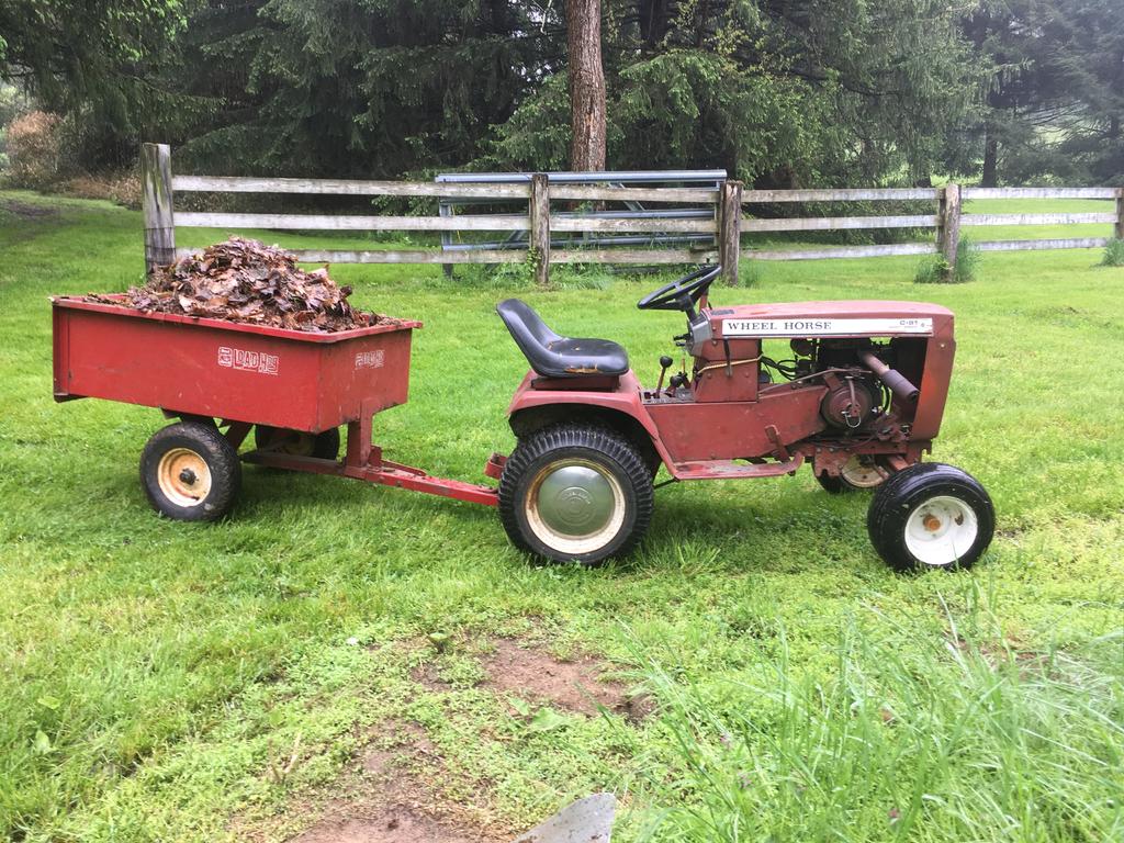

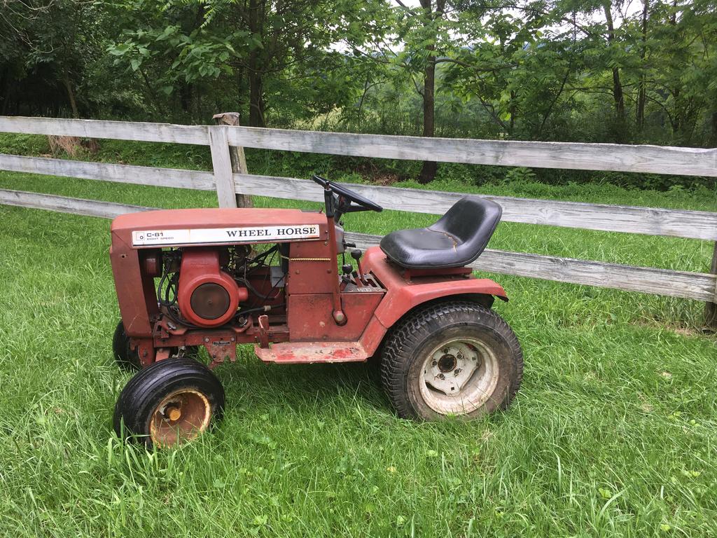

12 hp Kohler 1,020 #22 Posted November 20, 2018 (edited) Here's my c-81, its a great tractor with lots of power for its size. And as said above the little 8hp Kohler sips gas. $150 is a great deal for a C-81, the plow is a bonus, i say go get ! Edited November 20, 2018 by 12 hp Kohler 3 Share this post Link to post Share on other sites

PA.BOB 68 #24 Posted November 22, 2018 On 11/19/2018 at 8:22 PM, 12 hp Kohler said: Here's my c-81, its a great tractor with lots of power for its size. And as said above the little 8hp Kohler sips gas. $150 is a great deal for a C-81, the plow is a bonus, i say go get ! Looks good 12 hp. Does your shifter have much play in it ? Thanks 12hp. Bob..................... Share this post Link to post Share on other sites
12 hp Kohler 1,020 #25 Posted November 22, 2018 11 hours ago, PA.BOB said: Looks good 12 hp. Does your shifter have much play in it ? Thanks 12hp. Bob..................... The transmission that was in it when i got it locked up about a year ago so put another one in. I have had no trouble with the transmission that's in it now and it shifts nicely with the right amount of movement. 1 Share this post Link to post Share on other sites
