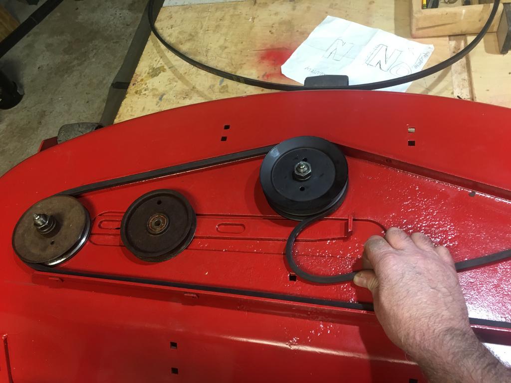

The Tuul Crib 7,354 #1 Posted November 16, 2018 Having a bit of a dilemma. I have a 48 inch deck that I am putting together in the belt that I bought which is supposed to be part number 106125. It is supposed to be 89 inches Long. Something is not adding up maybe it's the wrong belt or I am putting it on wrong. Any ideas ? Share this post Link to post Share on other sites
daveoman1966 3,884 #2 Posted November 16, 2018 (edited) You got the wrong belt. You need belt # 1594 which is 107" long...about $25 at dealers or online belt 106125 is fopr a 42" deck.. Edited November 16, 2018 by daveoman1966 1 Share this post Link to post Share on other sites
The Tuul Crib 7,354 #3 Posted November 16, 2018 4 minutes ago, daveoman1966 said: You got the wrong belt. You need belt # 1594 which is 107" long...about $25 at dealers or online belt 106125 is fopr a 42" deck.. OK thanks Dave after I put the thread up I got to looking at what Gary sent me for the 48 inch deck and there are three numbers to go by. I chose the wrong one and by looking again realized that I need the 107 inch belt . Thankfully though I have a 42 inch deck which I can use the 89 inch belt.There is a 6738 as well which is not right either . Share this post Link to post Share on other sites
gwest_ca-(File Mod) 12,456 #4 Posted November 17, 2018 106125 is the spindle belt for a 42" rear discharge deck. 6738 is the spindle belt for a 42" side discharge deck. Garry Share this post Link to post Share on other sites
daveoman1966 3,884 #5 Posted November 17, 2018 5 hours ago, The Tool Crib said: OK thanks Dave after I put the thread up I got to looking at what Gary sent me for the 48 inch deck and there are three numbers to go by. I chose the wrong one and by looking again realized that I need the 107 inch belt . Thankfully though I have a 42 inch deck which I can use the 89 inch belt.There is a 6738 as well which is not right either . I have several 1594 belts in good shape... can be in your mailbox for $15 each Share this post Link to post Share on other sites
