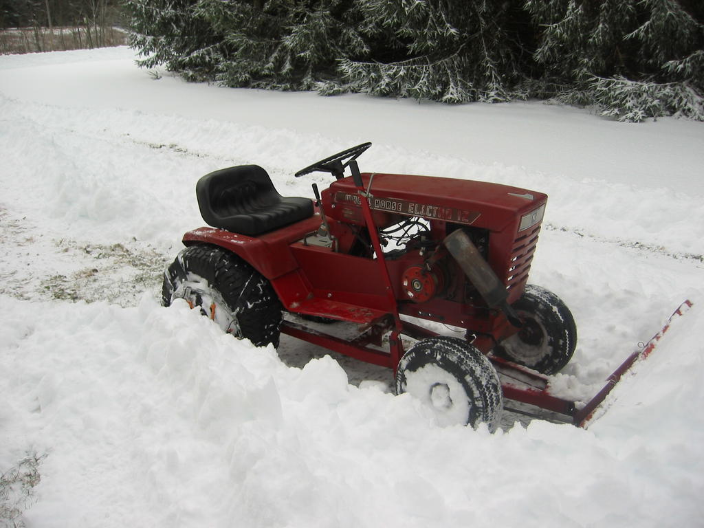

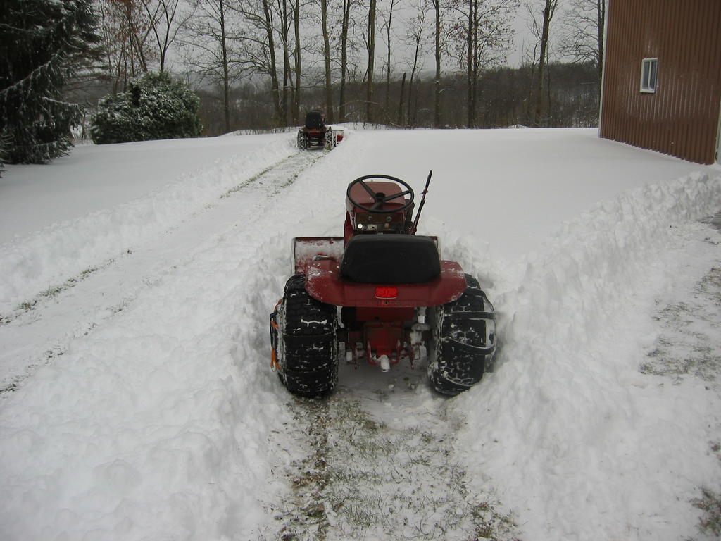

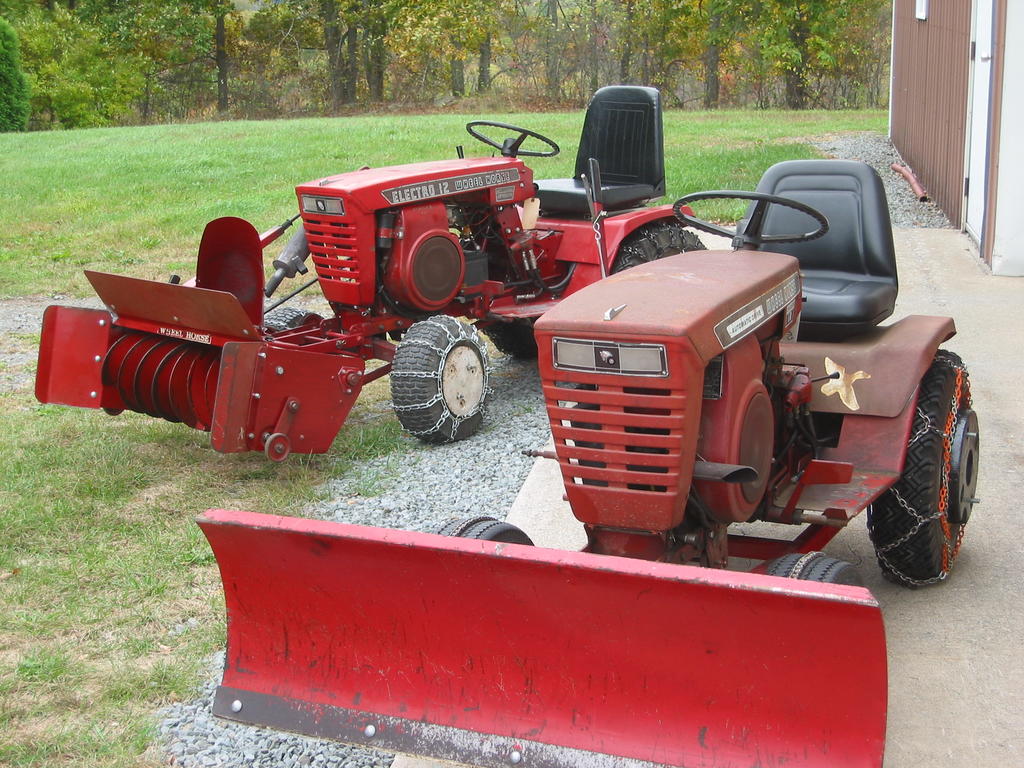

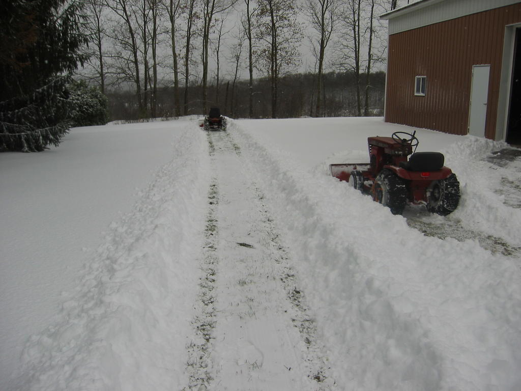

pfrederi 20,671 #1 Posted November 16, 2018 I have a short length of drive that is in pavers (50'). For years I have cleaned that by hand or with a walk-behind blower to avoid scratch marks. Spent some fairly big bucks late last year to get some rubber chains. and a plastic edge for the blade on an Electro12. Never had a good opportunity to test it. Today I had both plows out about 7 inches of fairly heavy snow with a crusty top. Plowed several hundred feet with the Charger 12 and steel chains. She got the job done. Got out the rubber chain horse and she struggled to clear the paver area. Decided to run a comparison test out in front of the shop packed gravel with some grass.. No comparison. The rubber chains spun out after a few feet and she is only pushing a 42 inch blade. The Steel chained 48" blade went way further i stopped not her. If you have a paved drive and are worried about scratches rubber chains are better than no chains...but if you have gravel then steel chains and narrow tires are the way to go. I couldn't find rubber chains for 6.00x12 i think narrow is often better than wide. 5 2 1 Share this post Link to post Share on other sites

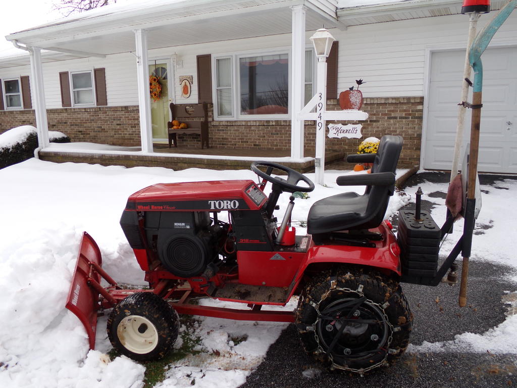

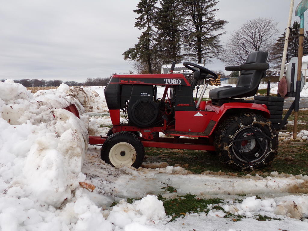

Ed Kennell 46,203 #2 Posted November 16, 2018 Good test Paul, and I agree steel Vee Bars offer the best traction on unpaved surfaces. On my steep paved driveway the rubber hold better than the steel. Steel just does not bite on a hard surface. The rubbers did a pretty god job on the gravel this morning pushing the 48" blade through about 6" of our water logged snow. 3 Share this post Link to post Share on other sites

Ed Kennell 46,203 #5 Posted November 16, 2018 5 hours ago, pfrederi said: Looking at your "skidder" style chains Paul, it appears they would always have some rubber tire on pavement. This should afford more traction on pavement than the 2 link Vee Bars that have steel only in contact with the pavement. Share this post Link to post Share on other sites
