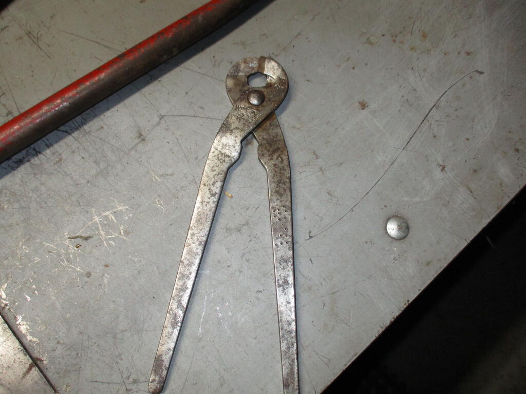

pfrederi 21,219 #38 Posted December 11, 2023 (edited) Chain Pliers Like in #32 above Edited December 11, 2023 by pfrederi 1 Share this post Link to post Share on other sites

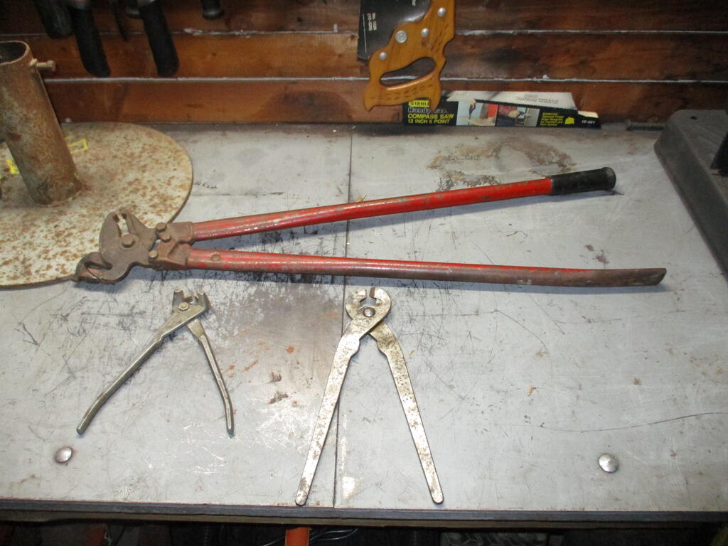

ebinmaine 80,917 #39 Posted December 11, 2023 4 minutes ago, pfrederi said: Chain Pliers Like in #32 above What are these? Sold as "Weed Sturdy" Share this post Link to post Share on other sites

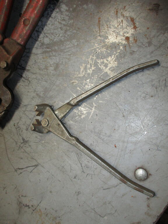

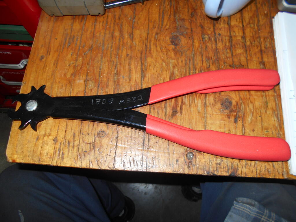

cleat 9,380 #40 Posted December 11, 2023 This is my tire chain pliers. I have never used it but have had it for years. 1 1 Share this post Link to post Share on other sites

pfrederi 21,219 #43 Posted December 11, 2023 There are different styles of chain pliers. The small ones will work OK on Garden tractor new cheap light chains. Most of my chains are madeup/modified old car/truck chains. If you have to make significant changes to those your hands will get really tired . The big one makes it easy but it is a bit awkward. Note how one handle is flattened you put that on the ground step on it to hold it while you push down on the other handle. Got my big one at an auction for $5. no body knew what it was 2 1 Share this post Link to post Share on other sites

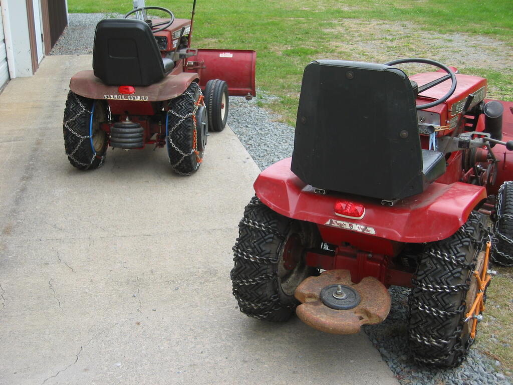

pfrederi 21,219 #47 Posted December 11, 2023 Adding link or two you can use the smaller pliers even just a chisel and some pry bars. But when you are adding cross links to go from 4 to 2 the right tool will make it easier. You can pick up old car/truck chains cheap at auctions as no one ever seems to know what size but you can make them fit your WHs. The chains on my blower horse are Army surplus Weed Brand chains for jeeps. Bag was dated 1956 never used. Yo can see the links are bigger thicker She rides a bit rough even at 2 link spacing... 4 Share this post Link to post Share on other sites
ebinmaine 80,917 #48 Posted December 11, 2023 3 minutes ago, pfrederi said: chains on my blower horse Those actually look A LOT like the heavy set I have. 1 Share this post Link to post Share on other sites
