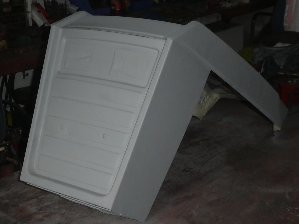

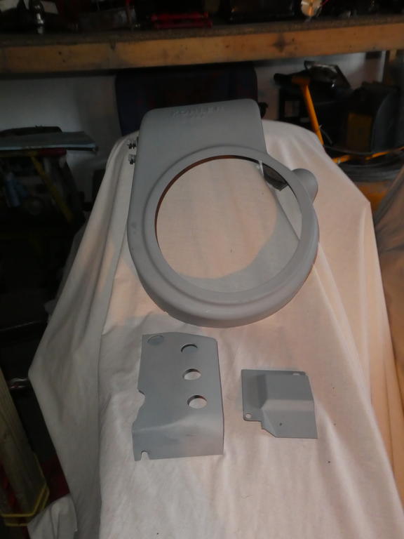

Stormin 9,987 #51 Posted December 12, 2018 Three coats of primer and red top coat applied today to the bonnet. Also the drive belt guard. Engine flywheel and head covers primed also. Black will be done tomorrow all being well. 8 1 Share this post Link to post Share on other sites

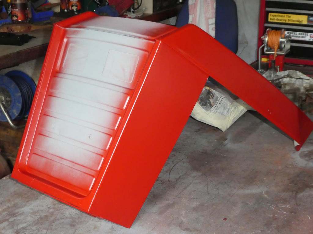

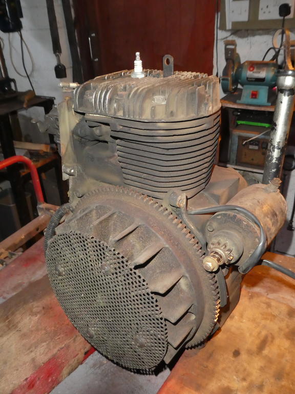

Stormin 9,987 #52 Posted December 13, 2018 Got the bonnet/hood masked up ready for doing the black. Got one coat on but it's been a bit to cold for painting. -2c with the east wind we're getting. So I got the engine onto the bench and stripped off what's necessary prior to removing the piston and rod. The bore looks good, so when I get those out, I'll give it a bit of a clean and get the bore deglazed. Valves should be ok as I had them re-cut and I ground them in, when I did the head gasket a couple of years ago. 6 1 Share this post Link to post Share on other sites

Stormin 9,987 #56 Posted December 15, 2018 Not much progress these last couple of days as the weather has taken a turn for the worse. Cold, wet and windy. Snow on the higher ground. I did get the piston and rod out and pleased at the condition of bore, crank' pin and rod big end bearings. Not a mark to be seen. I did find the top and middle rings end gaps were lined up and not staggered. Also the gaps were in line with the valves and that was where there was any carbon. Could that have been contributing to the oil burning? Just a thought. 2 Share this post Link to post Share on other sites

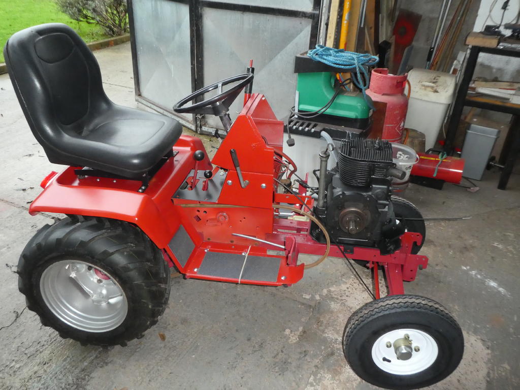

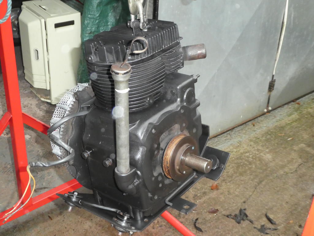

Stormin 9,987 #66 Posted December 20, 2018 (edited) Managed to get a fair bit done today. One or two hiccups, but not a bad day. Got the engine painted and it dried quite quickly. It's now back in place. Next job was to refit the drive belt. Here was boo boo number 1. As you can see from the first photo' the bottom run of the belt is UNDER the brake pedal when it should be over the TOP. Footplate loosened, brake connecting rod disconnected and pedal moved out. Belt was then fitted and everything now as it should be. I then moved onto the P.T.O.. Here was boo boo number 2. I found I couldn't connect the support bar to the shaft end. The hinge was fouling the shaft end. Took everything off again and I found I could knock the drive pulley further onto the shaft. Only by 1/16" but that was enough. I refitted the fuel pump and governor linkage next, then thought it would be a good idea to fill the engine with oil. That done I decided to have a tidy up. Looking round at the tractor to admire my handy work I saw it. Boo boo number 3. A big puddle of OIL under the tractor. The engine has a tube running from where the drain plug would be, to one side of the tractor for draining the engine oil. I'd forgotten to FIT IT. Muppet! Edited December 20, 2018 by Stormin 4 3 Share this post Link to post Share on other sites
