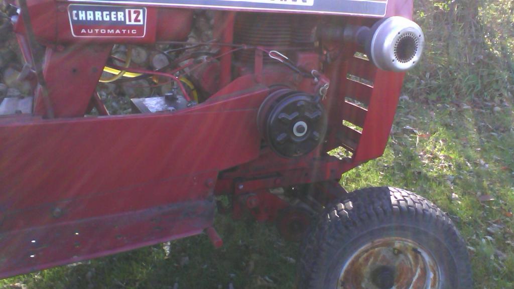

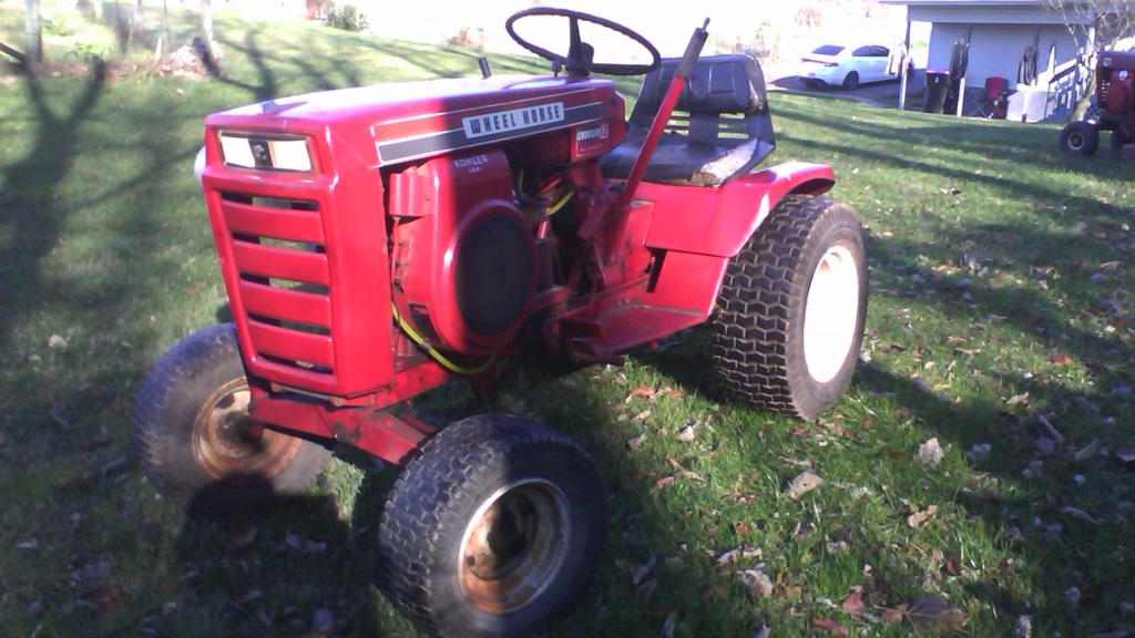

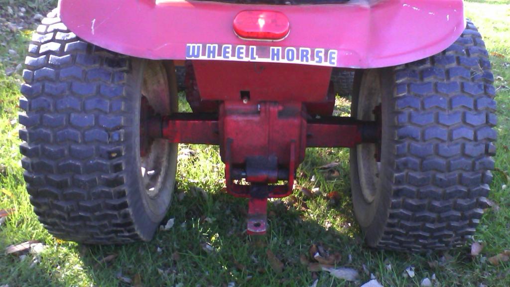

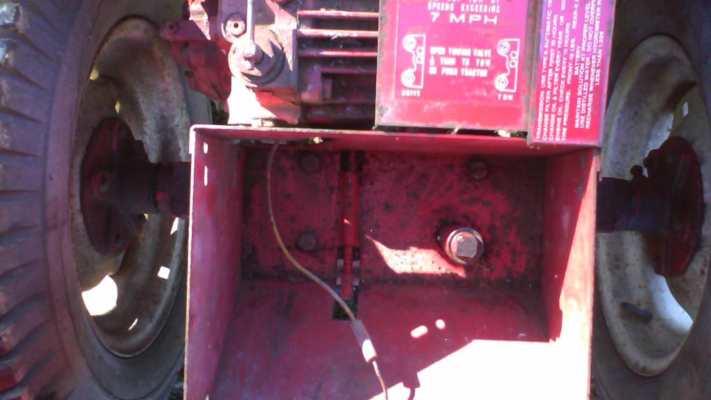

Horseoholic 264 #1 Posted November 12, 2018 Hey all, I have a question about installing a rear mounted tiller on my 1971charger 12 automatic. I would like to get a tiller to install maybe next year but I don't know what all is needed to hook it up, I never had an attachment for any of my tractors except for a mower deck and want to know what parts is needed for installing. Any information is greatly appreciated. Share this post Link to post Share on other sites
gwest_ca-(File Mod) 12,511 #2 Posted November 12, 2018 You will find this file handy. The A in D&A is the attachment list for your tractor. The tiller in 1971 was model 7-1211 on page 2 and continued on page 3. Those other models are recent but the list leaves out many models. Here they are in the order they were produced. Tiller DNA 1966 model RT-366 replaced by 1967 model RT-367 1968-1973 model 7-1211 ----------from here 1973-1974 model 7-1251 1975 model 7-1252 1976 model 67-36TL01 1977 model 77-36TL01 1977 model 77-36TL02 1978 model 87-36TL01 1979 model 97-36TL01 1980-1982 model 07-36TL01 1983-1985 model 07-36TL02 1986-1989 model 07-36TL03 1990-1991 model 07-36TL04 1992 model 07-36TL05 1993-2001 2003-2007 model 79370 ----------to here should all work. If you check the parts lists for all models they show everything required. We likely have most of the operator manuals also which helps with installation. Garry 1 Share this post Link to post Share on other sites
