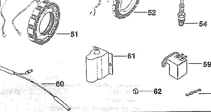

pfrederi 20,994 #20 Posted December 4, 2018 (edited) In your #6 post you indicated you had a breakerless ignition. If you have a triangular shaped coil on the front of you blower housing (#61) it is breakerless and you should NOT repeat NOT use any ignition switch that has an "I" terminal. You can go to lowes /HD and find 5 terminal switches that have an M terminal and use it with a solenoid. Edited December 4, 2018 by pfrederi 1 Share this post Link to post Share on other sites
71_Bronco 1,072 #21 Posted December 4, 2018 1 hour ago, pfrederi said: In your #6 post you indicated you had a breakerless ignition. If you have a triangular shaped coil on the front of you blower housing (#61) it is breakerless and you should NOT repeat NOT use any ignition switch that has an "I" terminal. You can go to lowes /HD and find 5 terminal switches that have an M terminal and use it with a solenoid. Correct, I have a breakerless ignition, and I have parts 61 and 59 on my motor. Looks like I will have to get the other part number for the correct switch. 1 1 Share this post Link to post Share on other sites
