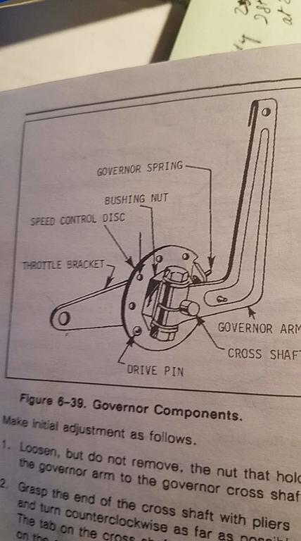

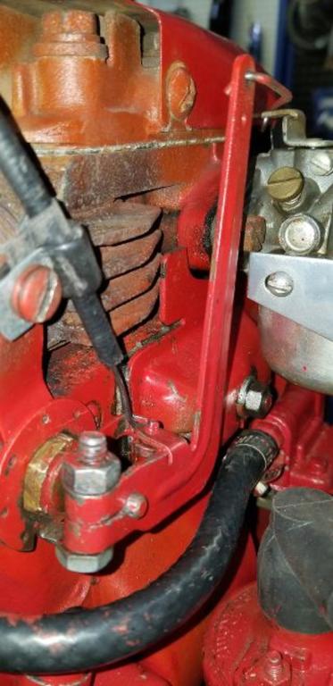

WHX?? 57,804 #103 Posted January 25, 2019 (edited) That girl definitely sounds to running fast Terry, Don't suppose there's a tach in the shop? Check your spring settings on the gov. Also check the high end throttle stop... lemme go get a pic of that. See if you have something like this. Edited January 25, 2019 by WHX21 4 1 Share this post Link to post Share on other sites
ebinmaine 80,287 #104 Posted January 25, 2019 29 minutes ago, Vinylguy said: Thanks Eric Hopefully we will have the muffler fabricated next week. It seems to rev higher than my commando 8 did? I agree with Jim. Definitely sounds like that thing is cooking right along. Share this post Link to post Share on other sites

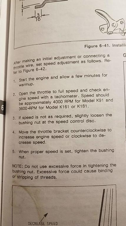

WHX?? 57,804 #105 Posted January 25, 2019 Don't go by how mine is adjusted this was a teardown pic. It should be in the one to two o'clock position so the link arm hits it at wot. The spring settings shown are what most of mine are set. Might want to check the guv shaft adjustment on the throttle arm. There is a specific way to adjust it and in the manual. Let us know you need help with that. Share this post Link to post Share on other sites

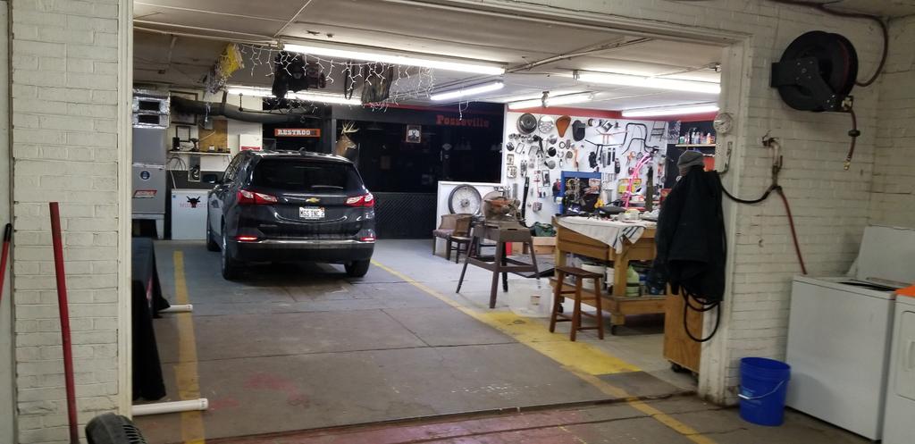

Vinylguy 4,796 #109 Posted January 25, 2019 (edited) I'll have to post some pics of the Posseville bar. This place was a Pontiac garage back in the 50's and 60's Edited January 25, 2019 by Vinylguy 4 Share this post Link to post Share on other sites

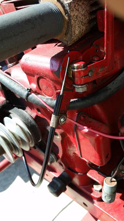

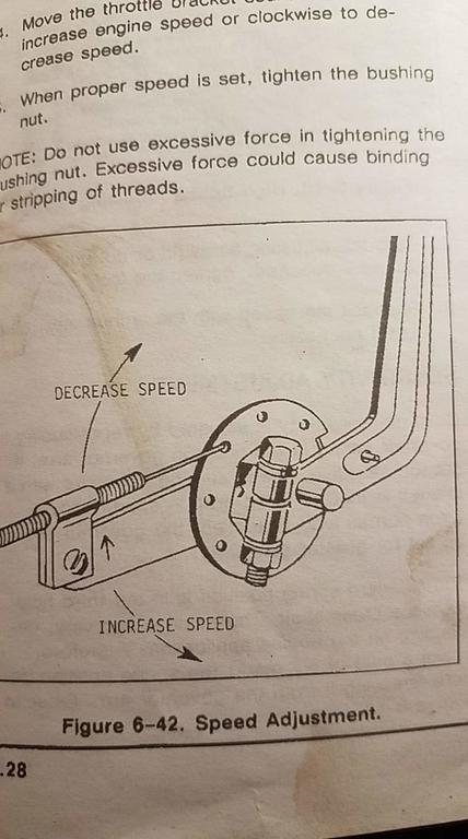

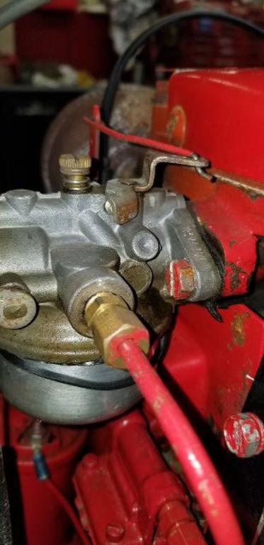

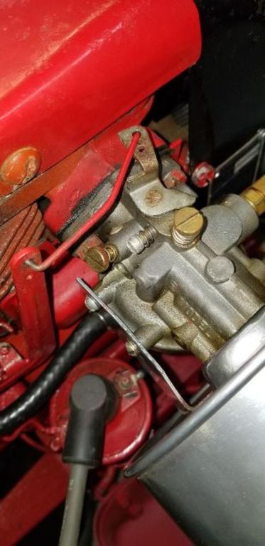

WHX?? 57,804 #110 Posted January 25, 2019 (edited) Lol Never mind my pics that was a 10 hp I forgot your an eight. That's not right at all Terry you have a guv setup ala k9I or 141. The throttle wire should be hooked to the one of the holes in the circular ring behind the arm. That circular ring should free float behind the arm but be linked to the arm with a spring setting in the notch where the cable is now. You motor is not being guved at all like that. That will be no good for mowing. The bracket that clamps the cable can be adjusted for an over top cable routing. Edited January 25, 2019 by WHX21 Share this post Link to post Share on other sites
Vinylguy 4,796 #111 Posted January 25, 2019 7 minutes ago, WHX21 said: Lol Never mind my pics that was a 10 hp I forgot your an eight. That's not right at all Terry you have a guv setup ala k9I or 141. The throttle wire should be hooked to the one of the holes in the circular ring behind the arm. That circular ring should free float behind the arm but be linked to the arm with a spring setting in the notch where the cable is now. You motor is not being guved at all like that. That will be no good for mowing. Well that makes perfect sense. Whoever put this k181 in did not know what they were doing. probably why they sold it as a non runner. Share this post Link to post Share on other sites

WHX?? 57,804 #113 Posted January 25, 2019 Just now, Vinylguy said: did not know what they were doing I tell ya some POs I would take the whole thing apart, clean thing off and put it back together right per manual use your shout out ya need help! Share this post Link to post Share on other sites
WHX?? 57,804 #114 Posted January 25, 2019 Wow nice man cave! like the HD thing! 2 Share this post Link to post Share on other sites
Vinylguy 4,796 #115 Posted January 25, 2019 2 minutes ago, WHX21 said: I tell ya some POs I would take the whole thing apart, clean thing off and put it back together right per manual use your shout out ya need help! Hopefully someone will post a picture of the correct setup so I can see any missing springs or parts Share this post Link to post Share on other sites

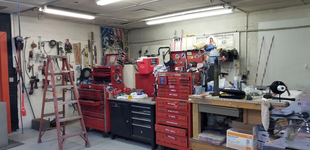

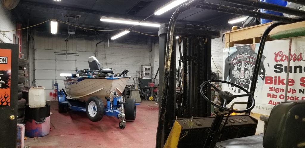

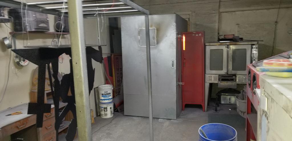

Vinylguy 4,796 #116 Posted January 25, 2019 (edited) Gary bought the building 11 years ago for his business. He is a Harley man so when we decided to build a bar it had to represent. We had our sign shop here for about 6 years till we retired. Here is a picture of the powder coat room. Edited January 25, 2019 by Vinylguy 2 6 Share this post Link to post Share on other sites

Shynon 7,646 #118 Posted January 25, 2019 (edited) Hope this helps Edited January 25, 2019 by Shynon 1 3 Share this post Link to post Share on other sites

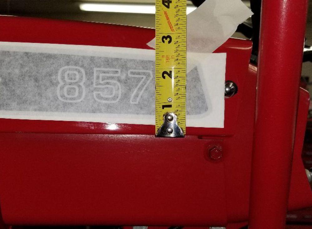

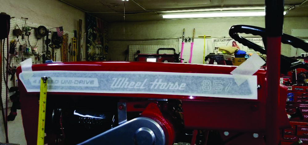

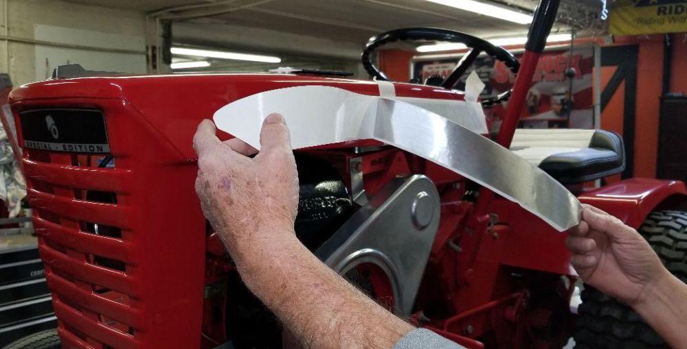

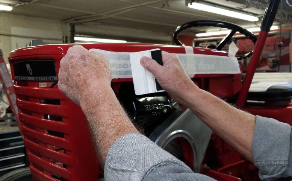

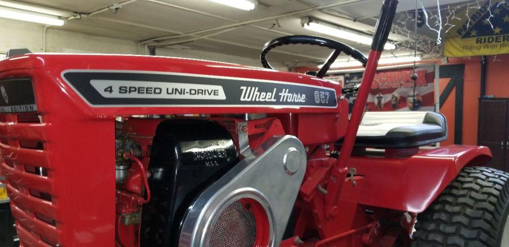

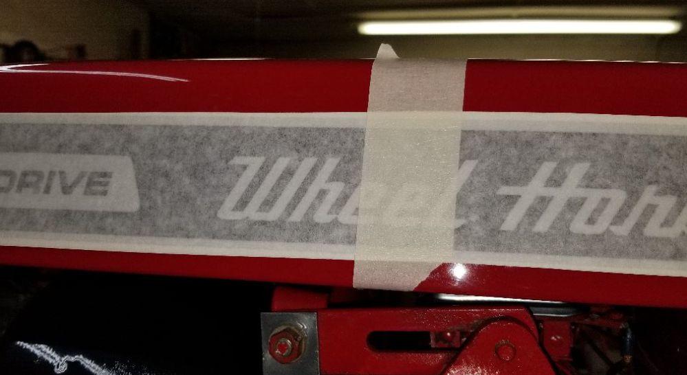

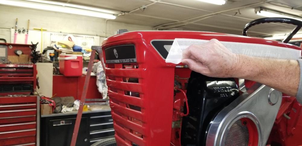

Vinylguy 4,796 #125 Posted January 26, 2019 Back to the decal project that I am much more knowledgeable about than motors. The decals I made for this tractor are digital printed on Satin finished clear overlaminate vinyl and then a layer of satin overlaminate to encapsulate and protect the solvent inks. After that I Laminate the 2 layers of clear onto a little longer piece of brushed chrome adhesive backed vinyl making a fairly thick decal which does make install a little easier but not nearly as forgiving as the vehicle wrap vinyl I use for most of my decal sets. So I cover the decal with medium tack transfer paper to help line up the hood decals as shown in this first image. Once I get it registered where I want it I put a piece of masking tape over the middle of the decal as shown in the next image. This will hold your decal registration while your applying the first half of your hood decal. I usually start with the left end of a hood decal first. Does not matter which end you apply first it just seems natural to me to apply the left end frirst. The chrome vinyl has no air egress adhesive like the wrap material (that is so forgiving and easy to rub out any air pockets after install) So I revert to the traditional decal prep and application. Make sure as always to clean your suface to remove any dust. Best to wipe it with isopropyl alcohol . then remove the tape from the end your starting with and peel back the liner then cut off the liner. A pair of scissors comes in handy for this. sometimes a third hand is helpful. Next I use a plastic squeegee to apply the decal forcing any air out as I go to get a smooth bubble free application. Then remove the masking tape from the middle and the opposite end. Lift the decal away from the hood to peel away the other remaining piece of liner and finish applying your decal. Now your ready to carefully peel off the transfer tape as shown And as simple as that you have your finished install. Yes you can use the wet application method if you feel more comfortable with that method. 2 7 2 Share this post Link to post Share on other sites
