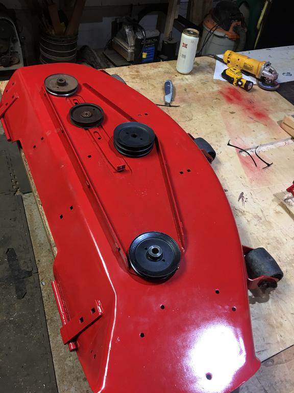

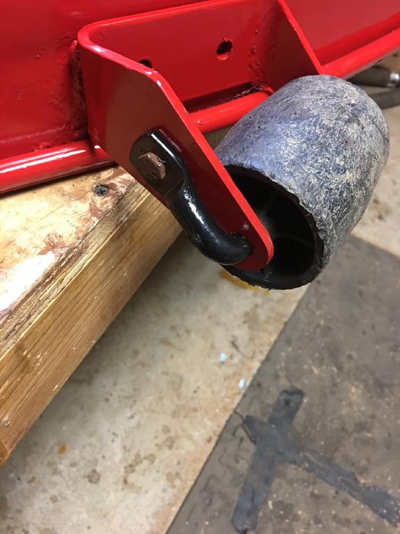

The Tuul Crib 7,354 #1 Posted November 11, 2018 (edited) I have this 48 inch deck that I am doing a redo on and regal red is a great match. I also hit it with some acrylic lacquer clear and what a shine! Edited November 11, 2018 by The Tool Crib 3 5 1 Share this post Link to post Share on other sites

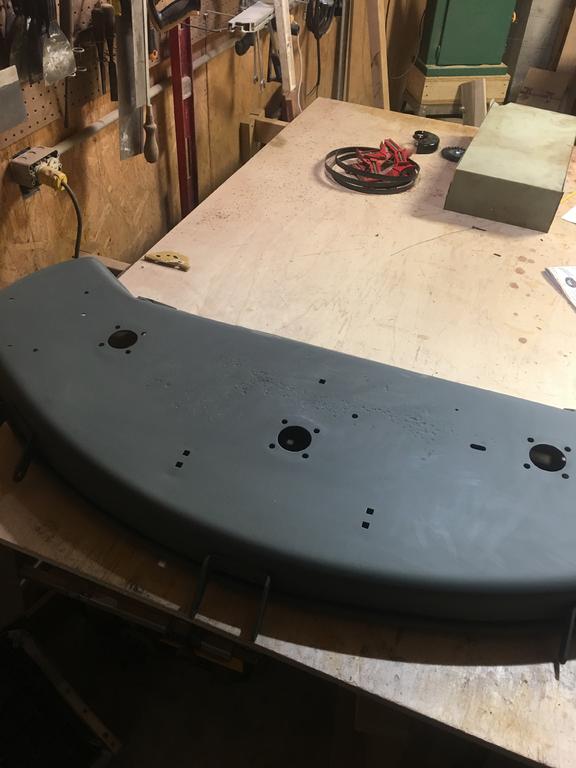

Lee1977 7,701 #6 Posted November 13, 2018 Prime and paint those spindle housings. They won't rust but the acid in the grass will eat them. Share this post Link to post Share on other sites

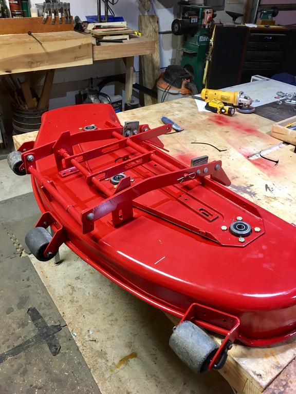

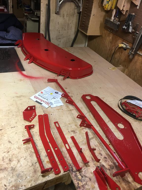

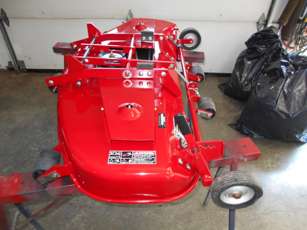

The Tuul Crib 7,354 #7 Posted November 14, 2018 Making some progress! Share this post Link to post Share on other sites
cleat 9,003 #8 Posted November 14, 2018 2 hours ago, The Tool Crib said: Making some progress! Looking good but I must point out that you have the brackets holding the rod backwards. They will hit your footrests that way (don't ask me how I know). It should look like this. Cleat 4 2 Share this post Link to post Share on other sites
