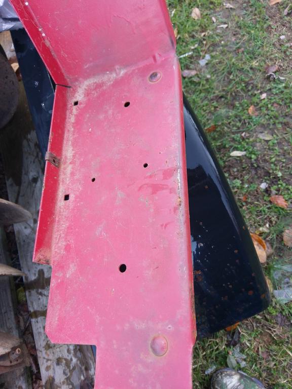

on the right side floor pan the two inner holes are used for lower belt guard. what if anything is used on the left side? could a small angle iron piece be mounted under the floor pan to provide support? thanks

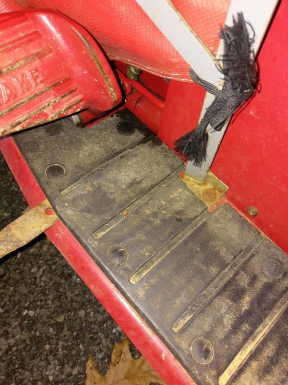

A bit more detail of what you are trying to accomplish would help with an answer, if you are looking for another set of foot rests I can help you out just PM me, Jeff.    Here's the right one I do have both.

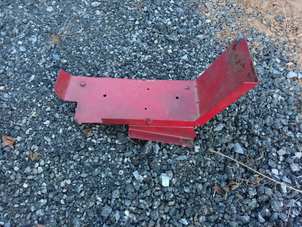

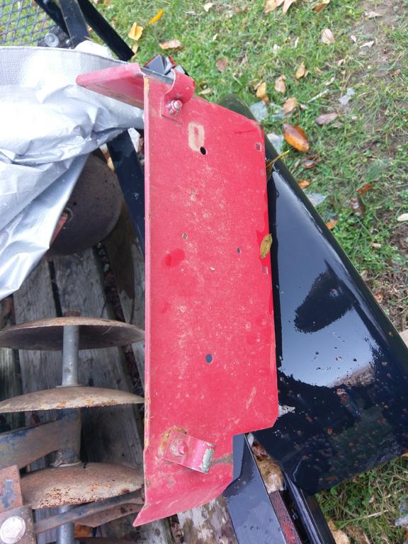

i have the pans installed with the belt guard on the right side. on the left side there are two square holes for carriage bolts. i want to fill these holes and thought i might use a short piece of angle iron mounted under the pan (just like the belt guard on the right side). the shoulders on the carriage bolts prevent them from tightening. thus the angle iron.

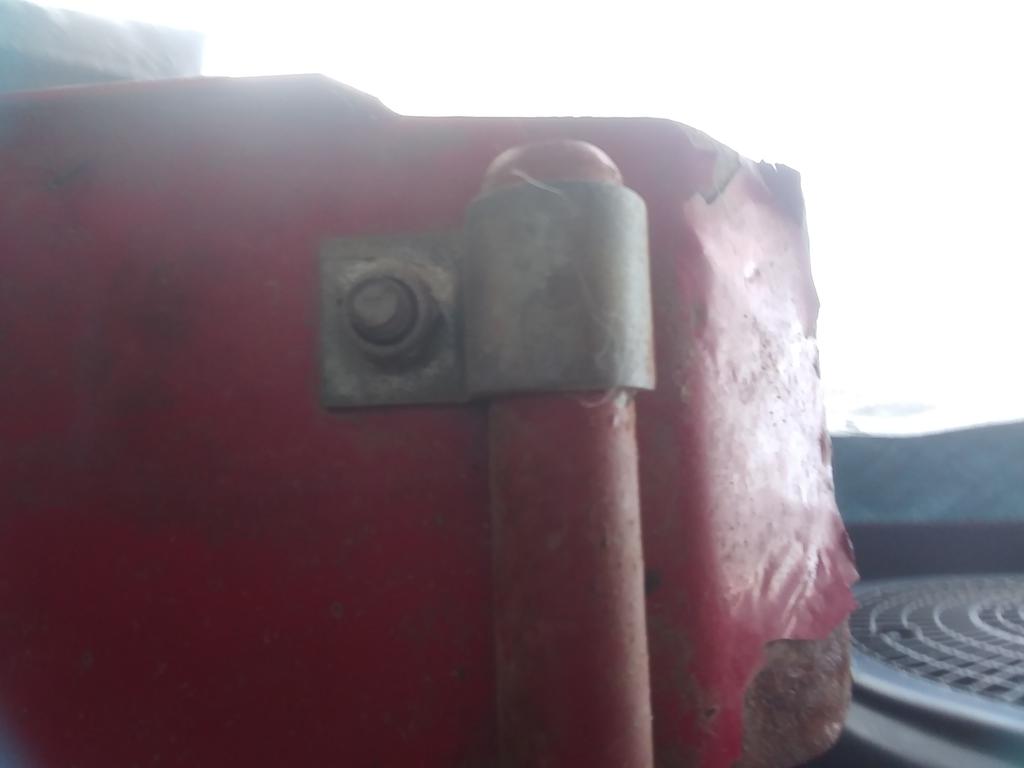

There should be 2 clamps (out board) that hold them fast to the bars going through the frame...the other 2 holes (inboard) are there for a snow cab frame...
