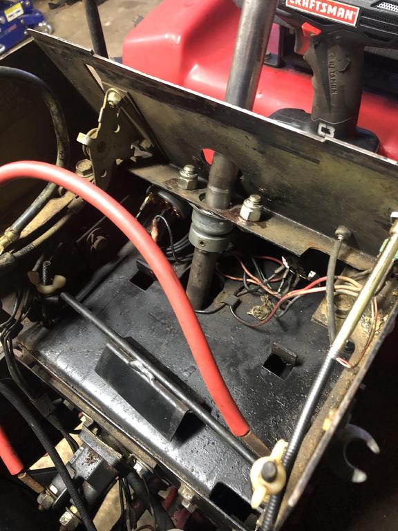

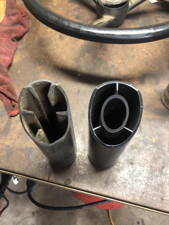

AHenry014 128 #51 Posted December 28, 2018 Hey all, Done a couple things to it. Got the new seat on it. My tractor has adjustable seat sliders on it, so i did need to drill a couple holes in the sliders to mount them to the seat. Quick and easy. Got the steering fixed. Thanks for the heads up on that bearing @19richie66!! I was worried about the steering wheel not cooperating, but all i had to do was drive the roll pin out and she came right off. Getting the new bearing in place was as easy as drilling two strategically placed holes. I also installed a new steer tube since the original has seen better days. All in all, very happy with how tight the wheel is now. Two questions: 1. After start, it takes a varying amount of time after start before the hydro loads up and i can use the lift. I have not tried the movement lever right after start, but will do so tomorrow and see how it functions. Anyone else have this issue? When its pumping, it is VERY strong and has no issues. 2. The lift cylinder leaks. I will need to double check that i have a serviceable unit, but i think this might be the correct seal kit: https://www.ebay.com/itm/Toro-Wheel-Horse-Garden-Tractor-Hydraulic-Lift-Cylinder-Re-Seal-O-Ring-Kit-NEW/113484905223?ssPageName=STRK%3AMEBIDX%3AIT&_trksid=p2060353.m1438.l2649 Am i correct? 1 1 Share this post Link to post Share on other sites

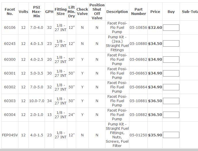

pfrederi 20,964 #55 Posted January 21, 2019 24 minutes ago, AHenry014 said: It does take a bit of cranking time for it to fire. But once its running it has no issues. I will likely be rebuilding the fuel pump on it if i can find a kit. Unless you are into originality save the money on the pump overhaul kit and buy and electric pump. My 418A took for ever to fire if she sat fr a few Put a Facet US made electric pump on about 4 years ago and it starts quickly now. 2 1 Share this post Link to post Share on other sites
Razorback 1,370 #56 Posted January 21, 2019 1 hour ago, pfrederi said: Unless you are into originality save the money on the pump overhaul kit and buy and electric pump. My 418A took for ever to fire if she sat fr a few Put a Facet US made electric pump on about 4 years ago and it starts quickly now. Which Facet pump did you use? Share this post Link to post Share on other sites
19richie66 17,930 #57 Posted January 21, 2019 I have a napa pump 4-7 psi and it seems to work fine. Think there is a 3-5 psi also. 1 1 Share this post Link to post Share on other sites
pfrederi 20,964 #58 Posted January 21, 2019 (edited) 15 minutes ago, Razorback said: Which Facet pump did you use? I have been using 60245. Some say 4 psi is too much i have 4 of them now and have not had a flooding issue.. You could use 60304 if the psi bothers you it doesn't come with fittings. Edited January 21, 2019 by pfrederi 2 Share this post Link to post Share on other sites
Razorback 1,370 #59 Posted January 21, 2019 Just now, pfrederi said: I have been using 60245. Some say 4 psi is too much i have I 4 of them now and have not had a flooding issue.. You could use 60304 if the pi bothers you it doesn't come with fittings. Very good information..... thank you! Share this post Link to post Share on other sites
