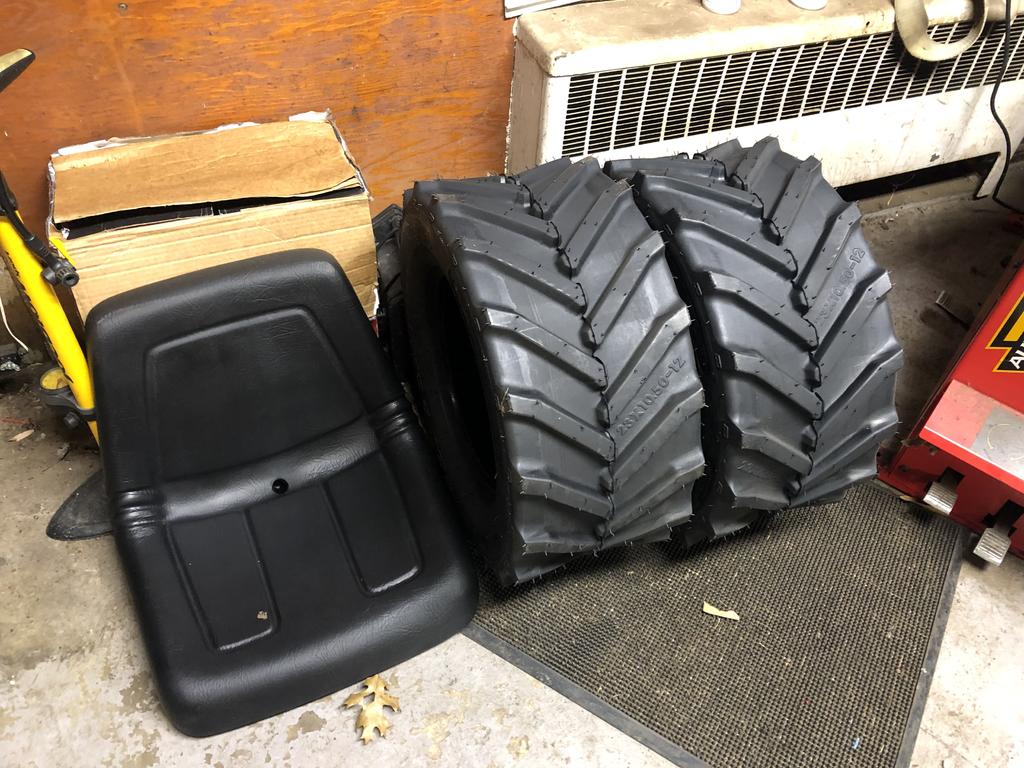

AHenry014 128 #33 Posted December 11, 2018 I ordered a new steering tube (the piece that goes below the steering wheel between it and the hood stand) and the previously mentioned flanged bearing. Still need to try and get the steering wheel off. I have read some horror stories, but will give it a shot and report back. I have been wanting Ag tires for the longest time now over the course of many tractors. I felt like this was the first to really deserve them. I poked around and decided on the Carlisle Tru Powers in 23x10.50-12 due to supposedly running the largest in that size and IMO looking the best. I found them for 99 bucks each on Amazon, but since there is an Amazon warehouse in CT, i pay sales tax, so i was looking at 211 delivered. As i was looking around, i got an email from eBay with a coupon for 10% of anything! I had some play money in my paypal, so to ebay i went to see what kind of deals i could find. I found them for 210 for the pair, less 10%, which put me at 190 or so shipped for the pair, no sales tax, and i had them in 2 business days. Awesome!! Here they are sitting next to my new seat. Thanks @peter lena So my plan is to get the rest of the paint off the chrome wheels and get them shining again. I will then be installing the ag's and taking them to a tire shop to be filled with Rim Guard, which is essentially beet juice. 23x10.50's are specified to fit approx 7 gallons of fluid in each, which makes sense, as that is about the amount that it took to fill my last set with windshield washer fluid. Referencing this website: https://countrysidenetwork.com/daily/homesteading/tractors-farm-equipment/ballast-the-tractor-tire-fluids-rundown/, i can assume that WWF is the same weight as water @ 8lbs/gallon, so i was looking at approx 56 lbs in each rear. Per the same website, it states that rim guard/beet juice to be 30% heavier than water, yeilding a weight of approx 73 lbs each. This is confirmed on Rim Guards website. I found a local spot that does it for 2.79/gallon. Comparing that to the general price of windshield washer fluid at 2 bucks/gallon, i would be saving less than 14 bucks. I figure it is worth my time to try the Rim Guard. I hope to get that done and some pictures up on Saturday. I picked up some Cub weights as well (~35lbs each), and plan to bolt those to the INSIDE of the wheel, so i can continue to show off the chrome through the winter. 2 1 Share this post Link to post Share on other sites

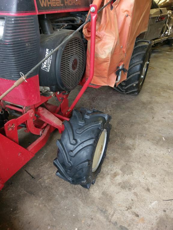

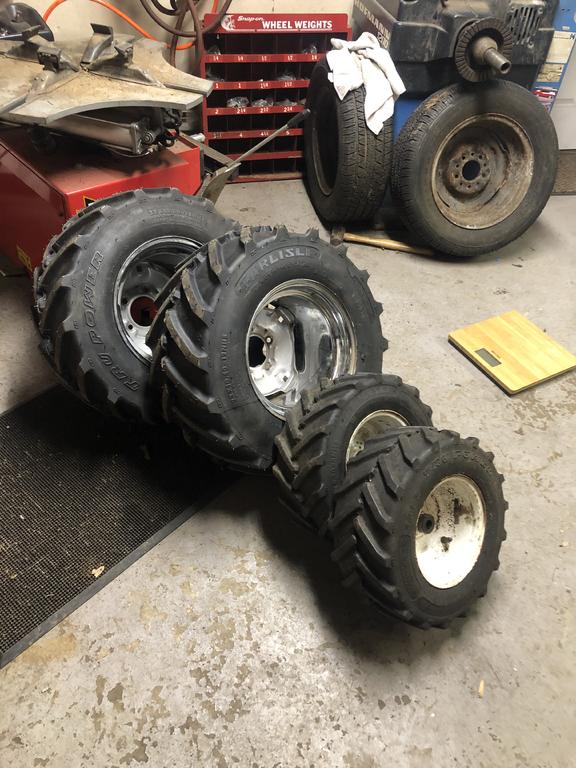

AHenry014 128 #40 Posted December 18, 2018 Picked up the filled tru powers today!! The guys that filled them said he was able to get 12 gallons in each of them, but im guessing he meant 12 gallons total. Breaking it down, they weigh in at about 100 lbs each. Carlisles website says the tire weighs approx 25lbs. If he got 6 gallons in there, the beet juice should weigh about 63 lbs alone. 63 + 25 = 88lbs. 100lbs total minus 88 lbs gives me a 12lb wheel, which sounds about right. In any event, Im happy with the outcome. They charged me 60 bucks out the door, which i thought was reasonable. I had a lucky find last night. The guy i sold my last 312 to put up a pair of ag tires for sale. He put up only one photo. Took one look at it and shot him a message, ILL TAKE EM!!! 16x6.50-8 Carlisle Tru Powers on wheels for 40 bucks!! And he delivered them to my car when i was walking out of work today. Super excited to happen into matching front tires to my new rears. Ill be filling them with windsheild washer fluid that i have on hand once i figure out if the wheels they are on fit my 418. They supposedly came off a Craftsman GT6000. I think the bearing width might be a bit narrow looking at them, so ill likely be swapping them to a set of WH wheels prior to installation. Ill get some more pictures up once i get everything installed. I think ill be running all the rear wheel weights that i have. It will weigh it at about 185lbs on each rear corner. I have a pair of 8" simplicity weights coming my way for the front as well, so it should be quite the tank this winter. 2 1 Share this post Link to post Share on other sites
953 nut 69,411 #41 Posted December 18, 2018 9 hours ago, AHenry014 said: once i figure out if the wheels they are on fit my 418. They supposedly came off a Craftsman GT6000. I think the bearing width might be a bit narrow looking at them, so ill likely be swapping them to a set of WH wheels prior to installation. Yes, the axles on the 418-C are a bit longer than most. That will be a nice looking setup! Share this post Link to post Share on other sites

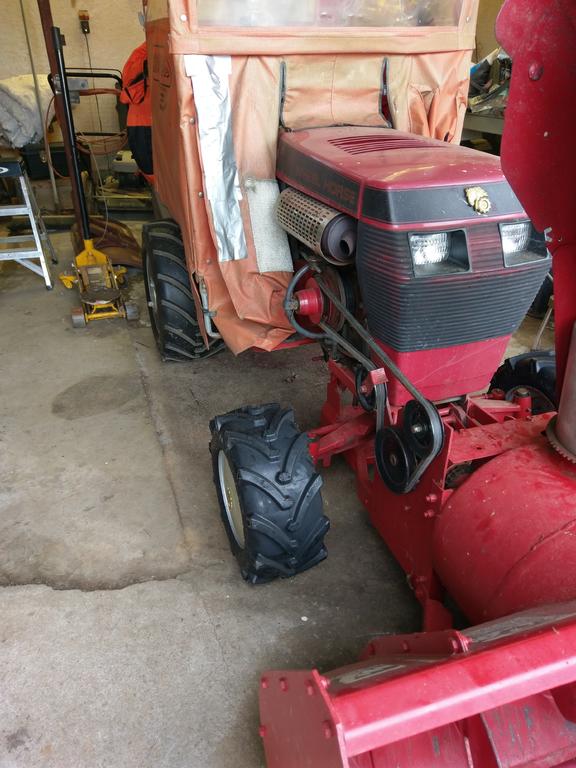

richmondred01 2,393 #42 Posted December 18, 2018 Here’s an ag set up on a 418-8. Shes a beast. I hate to part with her but will be selling come the new year. Definitely a unicorn only made in 1986. 1 Share this post Link to post Share on other sites
WVHillbilly520H 10,379 #43 Posted December 18, 2018 Or 520 style with matching OTR LAWN TRAC R1S...23x10.50-12r 16x7.50-8f...and from the rear (fluid filled as well 15 gallons total what I got charged for last Friday so about 7+/- gallons each plus 2 sets of iron weights on each wheel) on my plow 520. 1 Share this post Link to post Share on other sites
AHenry014 128 #44 Posted December 18, 2018 (edited) I believe your photo of the cub weights on the inside of the wheel was the reason i went hunting for a pair! Ill take a look at the extra pair of wheels i have on hand and compare them to the 418C wheels. The extra WH wheels i have fit my 314H from last winter. So if the 418 front wheels are specific, i am not sure i want the Ag's on them. I feel like they will tear up my yard when mowing in the summer (anyone have experience with that?). Figure i may leave the carlisles on the 418 wheels and swap seasonally with the Ag's. Ill just run a spacer to account for the width difference. Thoughts? Edited December 18, 2018 by AHenry014 1 Share this post Link to post Share on other sites
Sarge 3,473 #45 Posted December 19, 2018 I run mine pretty hard with ags on the front in the summer mowing - as long as you don't banzai the thing through turns it won't hurt the turf any more than turf tires. It's a misnomer that the ags will hurt the grass - at least if you have decent soil without a ton of sand in it. Now, that said, if you have very wet spots they will leave some interesting tracks behind until the next rain washes them away...lol. Sarge Share this post Link to post Share on other sites
AHenry014 128 #46 Posted December 19, 2018 That's good news! They look really cool and i would love not to have to worry about swapping them off. I didnt get a chance to mess with them last night. Tomorrow night i will be able to. I will collect all my rims/tires and decide the best course of action. Share this post Link to post Share on other sites

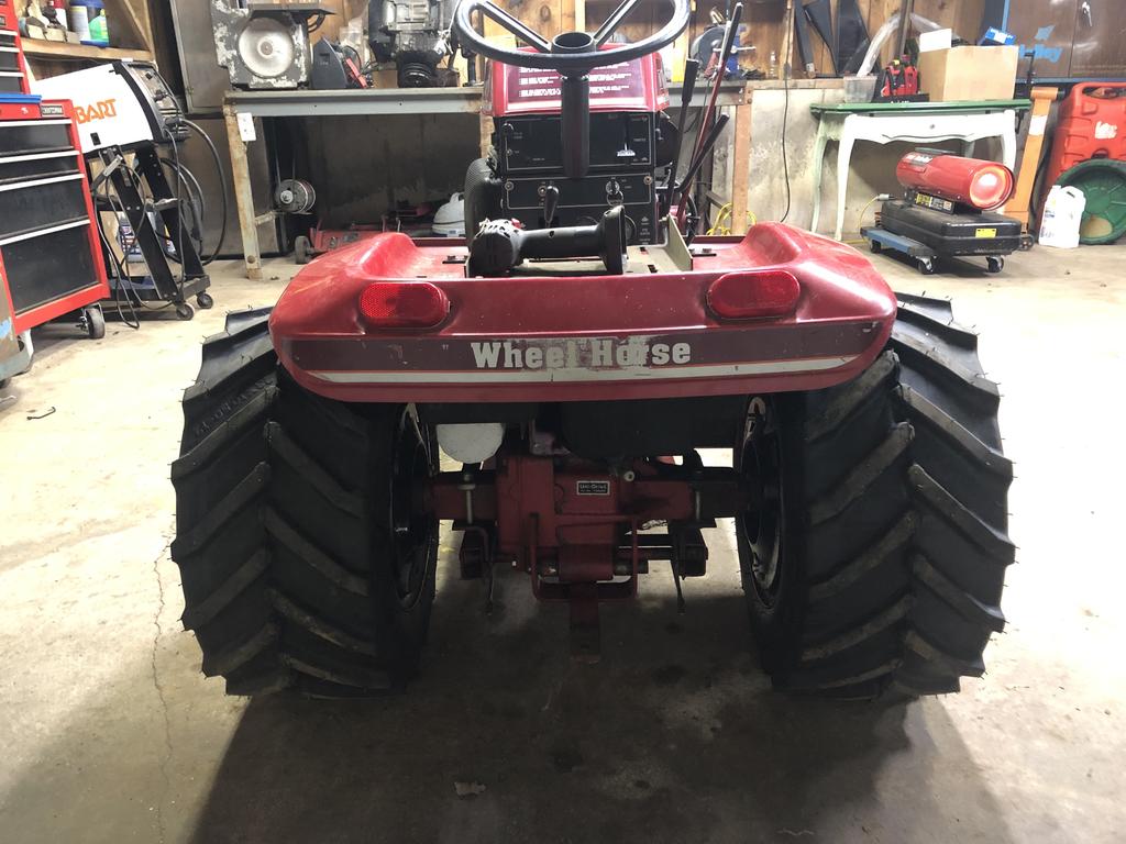

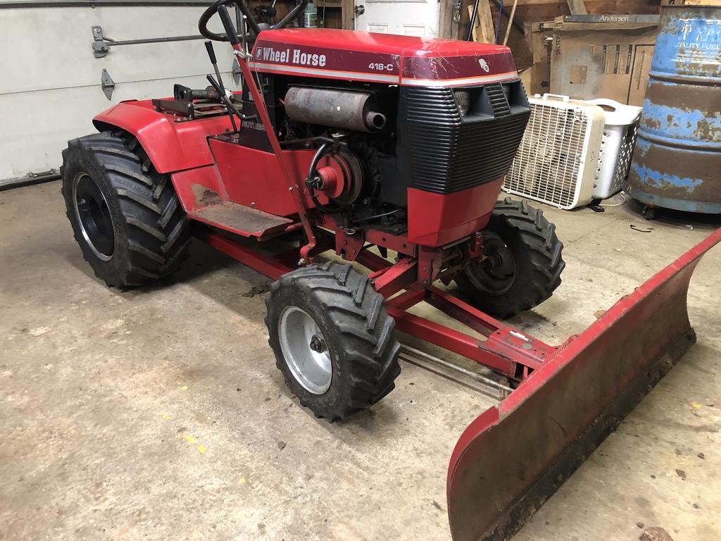

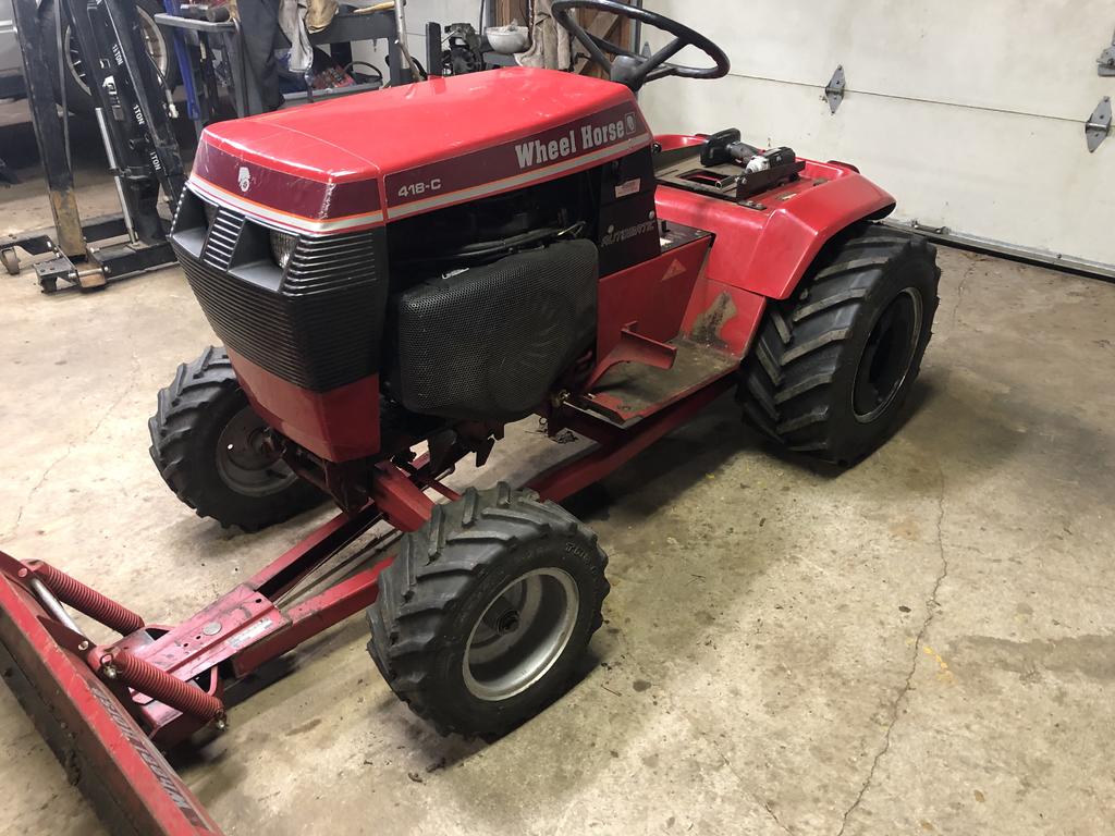

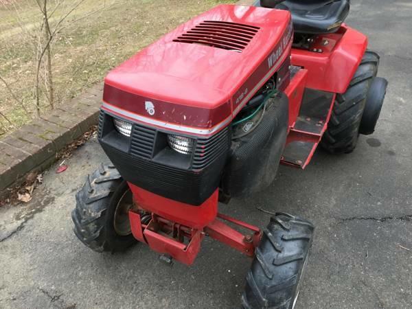

AHenry014 128 #47 Posted December 20, 2018 (edited) Got the Ag's on last night. I weighed both rears and found one to be nearly 10lbs heavier than the other. I know it makes me sound a little nutty, but i corrected that before installing them. Just had do drain a little less than a gallon out of the heavier one. After that, the rears went on pretty smoothly after figuring out the best way to bolt two sets of wheel weights on. Dang those suckers are heavy!! I didnt weigh them prior to installation, but like i said before, im guesstimating nearly 185lbs on each rear wheel. The fronts went together pretty easily. I decided to use the stock 418C wheels. I did not investigate the extra WH wheels i have. The extra wheels i have already have turfs on them, so why bother digging those out of the shed and removing the tires to install the ag's vs just using the stock wheels. 6 of one, half dozen of another situation, though i didnt have to deal with any spacing issues, so that was an added bonus. I am becoming a pro at 8" tire swaps! It is nice having my own tire mounting machine to at least break the bead on them, but of course the machine only goes down to a 9" wheel, so i grabbed the screwdrivers yet again. I mounted them, repopped the bead on one side, and filled each with 2 gallons of WWF. Bit of a learning curve getting them to reseat but at the end of the day i got it done. She looks mean. Now just to finish my new seat installation and get to work on the steering/hood stand. Edited December 20, 2018 by AHenry014 5 Share this post Link to post Share on other sites
richmondred01 2,393 #48 Posted December 20, 2018 Looks good. Share this post Link to post Share on other sites
19richie66 17,936 #49 Posted December 20, 2018 Really good! Share this post Link to post Share on other sites
PeacemakerJack 11,061 #50 Posted December 20, 2018 3 hours ago, AHenry014 said: Got the Ag's on last night... One word: BEASTLY! Share this post Link to post Share on other sites
